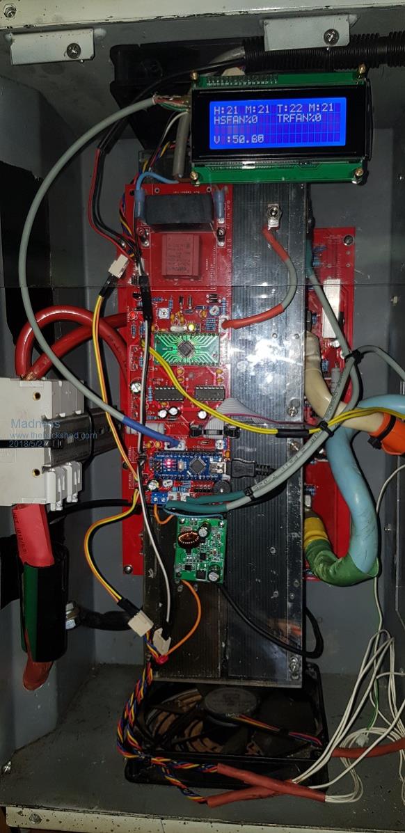

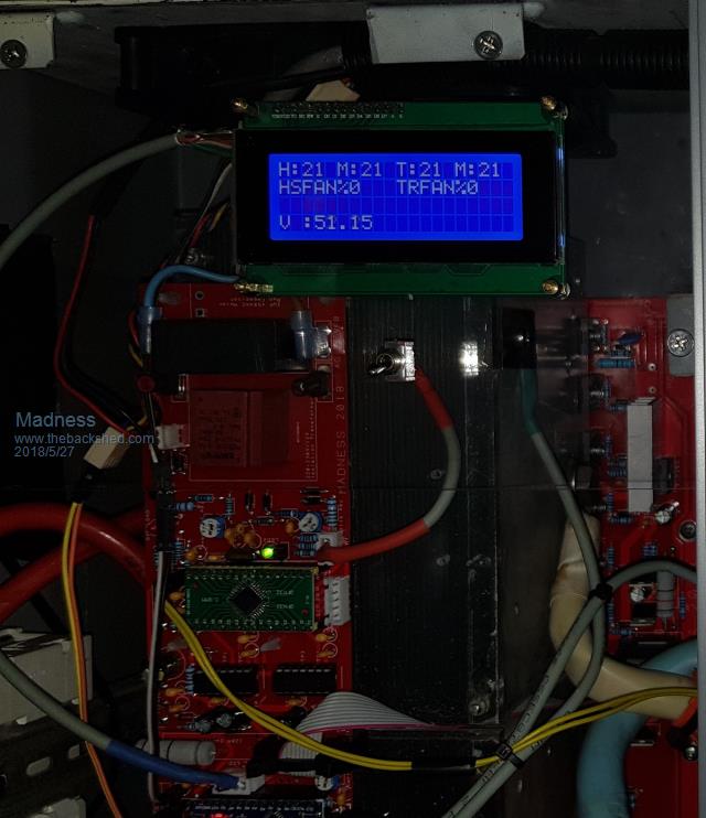

Today I fitted the new PCBs to my main 8KW Inverter that I had assembeled earlier. It is running perfectly with just the mods documented earlier for the control board and I have used shielded wire for the on/off switch. I also found a 9K1 resitor in place of the 7K5 just above the voltage adjustment trim pot gave me an output range of 200V to over 245V with a 230/12V transformer.
Edited by Madness 2018-05-28
Posted: 08:48am 27 May 2018
Looking at your blue display, out of curiosity, what is the typical voltage range of your LA forklift battery bank?
For comparison, my Lithium bank swings from 56V (absorbing) to 53V (50% discharged).
I'm interested in this to find out what low voltage disconnect value you use.

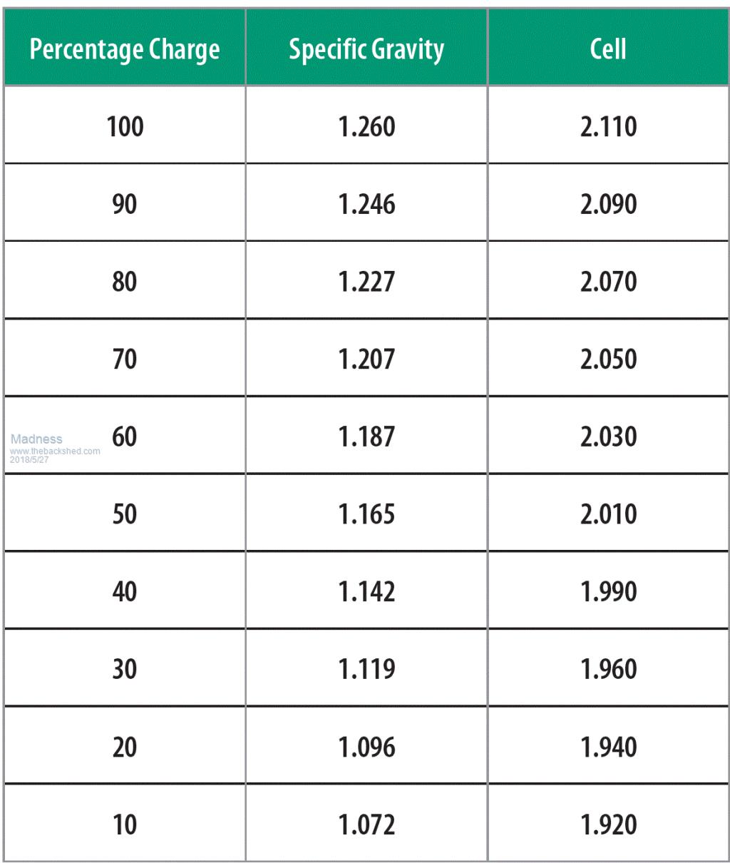

I work off this chart for state of charge 24 X the cell voltage.
30% is 47 volts which is absolutly as low as I would want to go where I have set the shutdown. In normal over night use it rarely gets below 50V, lowest I have gone to is 55% SOC. Normal Absorb voltage is 59.2 and 64V for Equalization (these are FLA). I am told in everyday use forklift batteries are expected to drawdown to 20% SOC and recharge over night, then do it all again the next day. The battery I have is guaranteed to do that for 5 years and still have 80% of it's original capacity. But none of those numbers mean anything for Lithium batteries.
