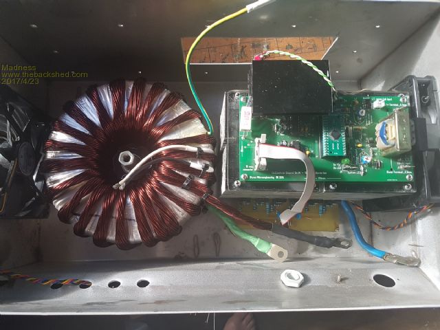

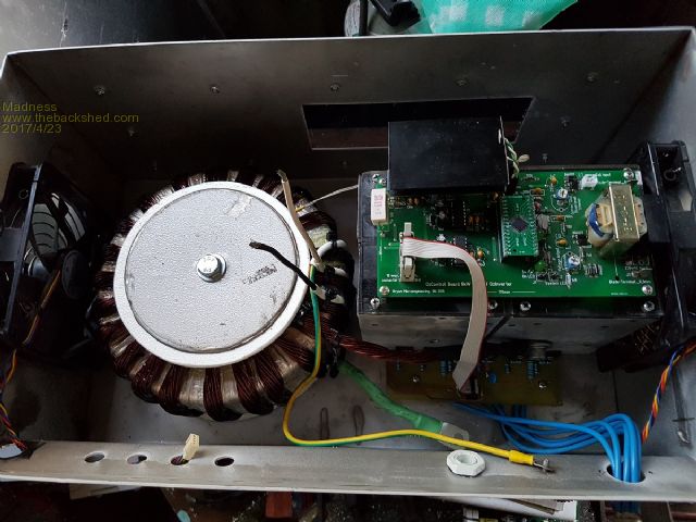

Here is the smaller Inverter I am building with the repurposed wire from the Toroid used as a new primary. This Toroid had a 250 Volt secondary and a 230 primary on the inside, I left the 230 to be the new secondary and reused the 2mm square wire X 19 with 24 turns as the secondary. With 230V on the secondary, I get 1.1V per turn.
I was also able to reuse the piece I cut out for one of the fans to hold the Toroid in place with a piece of perspex under it for insulation.
I thinking it should comfortably run 3 - 4KW continuos, FETs are 4110's I will see how the go but might change them for 4008's

Damn impressive winding effort there. Should make a nice little unit...
I'm a bit iffy about the enamel wires touching as they have been worked a bit by now, it may have been possible to put them in a 6 meter x 25mm heatshrink tube for extra insulation too, but then again they may be just fine.
I like it a lot.
...........oztules
Posted: 11:34pm 22 Apr 2017
There is only about one volt per turn, so the electrical stress between turns will be very low. But I agree, its a really nice job !
Posted: 12:56am 23 Apr 2017
It has had a coat of epoxy all over the primary so there should be no movement or exposed wire. The wire was also very flexible, this toroid is different to any of the other Aero-sharp ones I have seen. The 1KW SMA toroid (not the one in the photo's) that I scrapped had tape on every wire where they went through the core on it's primary so that each turn had an extra layer of insulation between each turn, the tape was very similar to Kapton tape.
I had thought insulating it more but this way it is going to cool better, another thing that is really nice about doing it this way is it did not take a lot of time and a whole it cheaper than welding wire.
The heatsink from the old SMA 1KW worked out well, I never measured it, just cut it in half and then half again for the low side, there is less than 10mm to spare end to end.Edited by Madness 2017-04-24
