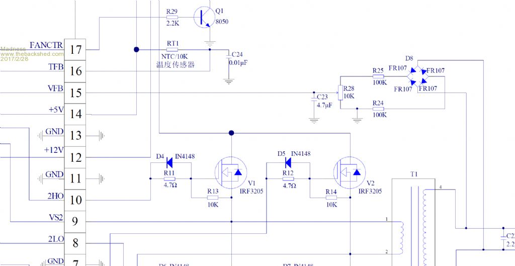

Anyway, I just perused (again) the application notes for the EG1810.
On page 12 under "AC Output Voltage Feedback" I found two things that are different on my PCB.
The first "A filter inductor needs to connect to SPWM output port" I have not done that. Its not on the little EGS002 boards either and oztules also does not have them on the PCB screenshots he posted a while ago.
Do you think that's worthwhile to investigate? If so, what size inductor? I think I'll get some of those little ones that look like a resistor and try them.
The second, and IMO more important, difference: "voltage feedback is through measuring the AC voltage output of inverter."
Here I just reverse engineered what oztules had on his PCB which obviously works.
He rectified the output of the little 12V transformer.
But then its no longer AC that gets sampled!
I think the 8010 is looking for an AC waveform on its VFB (pin 13) input. Presenting the DC ripple of rectified AC 'might' work but it also might not. I certainly will now go and try that.
If I am right then I will post an altered schematic here later and I'm sorry for not picking this up sooner.
Now lets see what else I can find, I'm almost convinced something is wrong with the signals driving the gates rather than with the Mosfets themselves.

Just looked at the circuit in the EG8010 data sheet and I can't see the inductor you mention in the VFB circuit, as far as I know it is DC and needs 3 volts at the chip. In the EG8101 data sheet on page 12, I can see a circuit there with the inductor which is the choke that we are using, sorry if I am missing something here. For testing, I have connected the 12V supply to the diodes on the Oztules control board. This allows me to have the control board running on it's own. I am using this to test the Gate drive boards I am making with the TC4452 chips. The PCB's are just 22 X 26 MM, the chips have just arrived. Tomorrow I have time to work on it, fingers crossed I will have a positive outcome.

The other thing, look at the circuit schematic on the EGS002 datasheet (you'll need a magnifying glass). The VFB (pin 13) samples the **AC** of the transformer output.
We put a little 12V transformer there to isolate this sampling from the high voltage side.
But its still AC that is being sampled, there are no rectifying diodes used on that circuit, neither are there any in figure 8.1a (page 12 of EG1810 datasheet).
So, why did oztules rectify this feedback voltage?

On page 10 we have diodes, there is no transformer but we know Oztules added it for a good reason that caused him problems when his batteries got wet. But what matters is diodes = DC.
This version is low voltage with a transformer same as we are building. The Chinese manuals are not perfect either so you are right to doubt everything.

The one for the EG8010 does not have the schematic above.
It must work with AC fed into the VFB input as well or the schematics I can see are all wrong.

I *do* have that little transformer isolating the VFB from the mains.
What I was querying is that most of the 8010 circuits do not have a DC voltage VFB, only the one circuit madness posted (and oztules) has that.
So the 8010 must be able to control the VFB even if its AC (from the secondary of that little transformer).
And it seems to, there was no ill effect when I tested mine with lo voltage AC at VFB, sans any Mosfets connected to the gate driver.

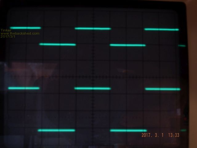

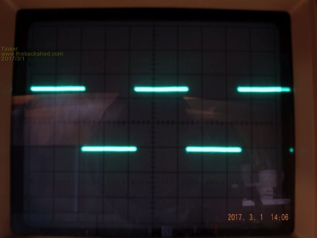

Today I was testing if there are any problems with my inverter electronics.
No Mosfets were connected.
To give the TC4452 chips some load I connected a 2700pF capacitor between the gate & source terminal.
I used 2 isolated DC/DC converters (12V-12V)to get the high side drive voltage. I had these left over from another project, they seem to do the trick even if only rated at 250mA each. I consider using them permanently instead of the charge pump idea. Reason being, the TC4452 gets powered up *before* I turn the gate drive on.
Here is a pic of what happens at the IR2110 LIN (top trace)and LOUT (bottom trace) terminals: 5V/div, time base = 5ms.
Its too difficult to see the 1us dead time but the traces have no visible overlap.

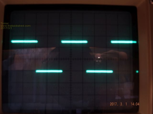

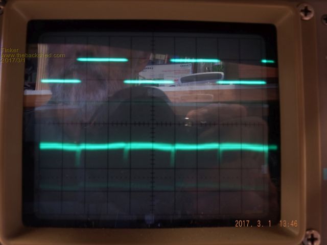

Pics from the high frequency side did not turn out sharp and made little sense to me:
Here's the signal at the capacitor (LO side chip, 1LO) I'd connected to the TC4452 output:
And here the same at the capacitor (LO side chip, 1HO)
Any comments are welcome, as usual.

Klaus if there was any shoot through, ie no dead time it would have to show on your CRO as spikes. You will need to drive some FETs to try this, as Oztules mentioned using a test board with no caps and a series resistance on the power supply won't blow FETs if the signal is crap. This has saved me a few times now testing the control boards and drivers.

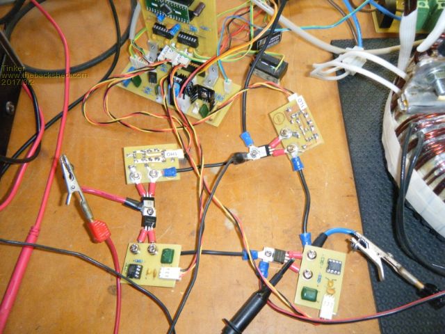

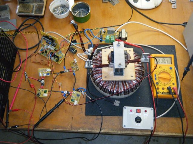

A bit more fun with testing today.
First I rigged up My little gate driver boards to some 4110 Mosfet chips and connected the lot into a full bridge inverter.
The close up pic below shows the little DC/DC converter blocks I use for the high side power (top right)

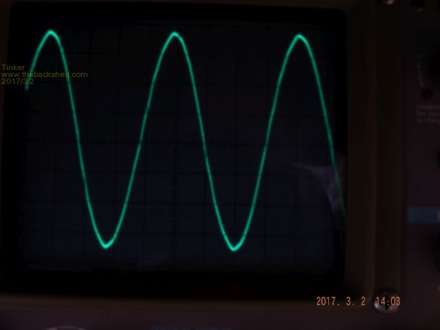

Then all was powered up, voltage & current measured and I got a nice AC output on the scope.
While I was probing around with the CRO probe the inverter just died suddenly.
No bang thanks to no caps fitted and limited current supply. Turns out just one of the 4110 chips had developed a D-S short. No idea why.
Replacing that one all worked again, of course with no load since there is no heat sink. So far I could not get it to fail again.
It occurs to me doing a soak test for each chip might be a good idea, especially if there are 4 or more in parallel in the final inverter.
So I'm making a little 4 chip test rig with screw type terminals for quick Mosfet connection. The 5mm spaced terminals will suit the HY4008 chips perfectly.
No caps, no heat sink, just for checking the reliable operation and supply voltage endurance.
Leaving each set of 4 on for a few hours, with many times on - off switching, should weed out the crappy ones.
I think I'll continue using the gate driver chips for the HY4008 experimenting. Even the 4110's took the extra gate drive through a 1 Ohm resistor with no complains.
Posted: 12:32am 02 Mar 2017
I had a similar experience today testing TC4452's I found 2 FETs in the board were 30 ohms RDS last time I tried that board it worked. They are cheap 4110's, makes you wonder. I have a packet of them that just arrived that are from the same supplier that Oz uses. I will see if the behave any differently.
