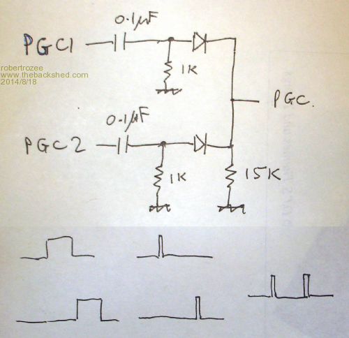

1. page 13 of the FT232R datasheet refers to the signal "BitBangWR" that can be generated on any of the first 4 CBUS lines (CBUS0..3) which seems to be a strobe signal for whenever a write occurs to the device. could this be useful as an alternative to having the PC control PGC directly?
2. instead of generating a single PGC output, could you generate two at half-rate, which are 180 degrees out of phase? with a few passive components you could then turn the leading edges into a pair of short pulses that when combined together yields a single train of PGC pulses.

1. so, something like: writing the TDI (or TMS) bit not only causes it to appear on the associated pin (now DTR for 5-wire i.e. with the 3K3 resistor) but also creates a pulse (hi then lo strobe) for PGC? yes, maybe, though I don't see how to do it (and the timing must be "not too short a strobe")
(It probably wouldn't be doable with the 4-wire i.e. no 3K3, but no matter.)

i had in mind something like this:
the pulses should be somewhere in the region of 0.1ms wide. the two diodes and 15k resistor form a simple OR gate. adding a small capacitor across the 15k resistor will delay the pulses slightly, though i suspect this will not be needed.
i am assuming that you can set the state of PGD, PGC1 and PGC2 all in the same usb packet?
rob :-)Edited by robert.rozee 2014-08-19

Rob - yes I can set them, so that looks like I'd set:
PGC1 to 1, PGC2 to 0 then (in the next USB packet):
PGC1 to 0, PGC2 to 1
which is 2 USB packets (I can set PGD in each packet as well).
Ah, and it made 2 pulses which now take me 4 packets.
hmm, interesting...
Might be a snag in that I can't control the time between the packets, although it's a very relaxed (almost fully async) protocol so I think it doesn't matter.
JohnEdited by JohnS 2014-08-19
Posted: 11:33am 18 Aug 2014
Follow up...
Is the idea that it would go as below and if so what would the overall waveform be on PGC?
PGC1 0 1 0 1
PGC2 1 0 1 0
Each PGC1 & PGC2 pair will occur together. There will be varying times between each pair and the next pair.
Would it make 4 pulses (and with gaps between them, doesn't matter how big)?

Posted: 12:16pm 18 Aug 2014
  JohnS said   Follow up...
PGC1 0 1 0 1
PGC2 1 0 1 0
you've got it exactly - in theory you would see 4 short pulses, at each of the 0->1 transitions of PGC1 and PGC2. the widths of the pulses are determined by the 0.1uF caps and 1k resistors. if the pulses are too long, just decrease the values of the 0.1uF capacitors. i'm picking the pulses could be very short and still work, but have no feel of how many usb transactions you're achieving per second.
while it is a few more components, i do believe it should be well within the abilities of most to build with just twisted together component leads. at the same time, in the 'final version' of your software you could look at accommodating the two different designs (single-resistor and 8-part versions) to cater for the widest audience.
rob :-)

Posted: 12:07am 19 Aug 2014
john:
while speed it a nice thing, there is also great virtue in simplicity and elegance. the 1-resistor solution achieves these goals and provides a means for almost anyone to get their 32MX150 turned into a micromite for just a few dollars.
you have done a remarkable job, and achieved what many naysayers said was impossible. i look forward, as will many others, to seeing the release code. with it, a micromite will be achievable (from scratch) for less than $10 total outlay. this is a big step forward, and hopefully just the beginning of a series of on-the-cheap programming solutions.
