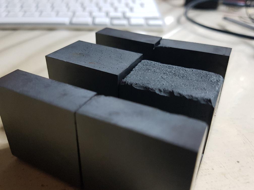

The 2 pairs of ferrite cores have arrived.

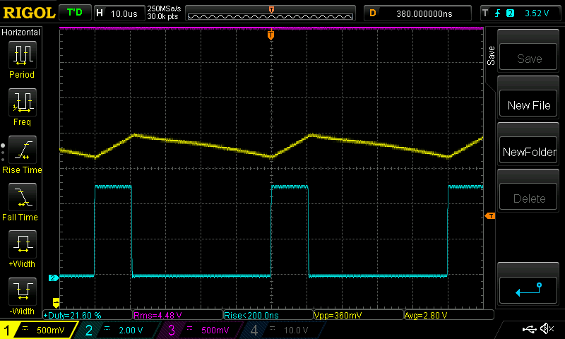

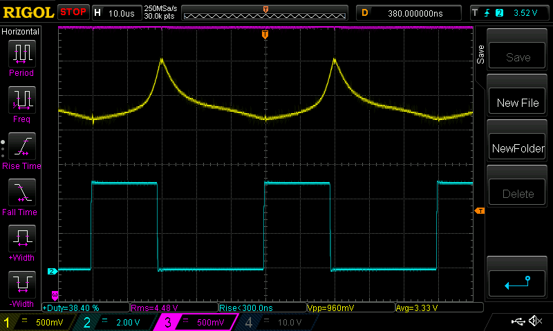

I put 7 turns around it, with no gap and let's see how it goes.
Inductance is now about 450uH. This is way too big.
All tests are 57V in, 1 Ohm load, varying output voltages, 20kHz pwm.
Yellow is inductor current, 0.5V/div and 0.0202V/Amp so that's 25A/div
Zero current is at the "R8" White marker.
Light Blue is pwm, i.e. high = MOSFET is switched ON
and at a higher power
This is of no use for us.
It's nearly all ripple current and that's bad. And it's saturating like billy-o.

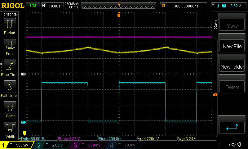

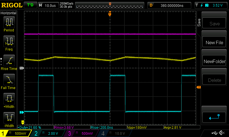

Now this is how the very good inductor I made with 1.5mm gap looks like
and at higher power
There is proper linear current increasing during the pwm pulse and it decreases in a linear manner when the MOSFET opens. This is good, in that it limits current peaks
which are bad for the capacitors, bad for radiated EMI, bad for efficiency and bad for the MOSFETS. This is a good inductor for this project.

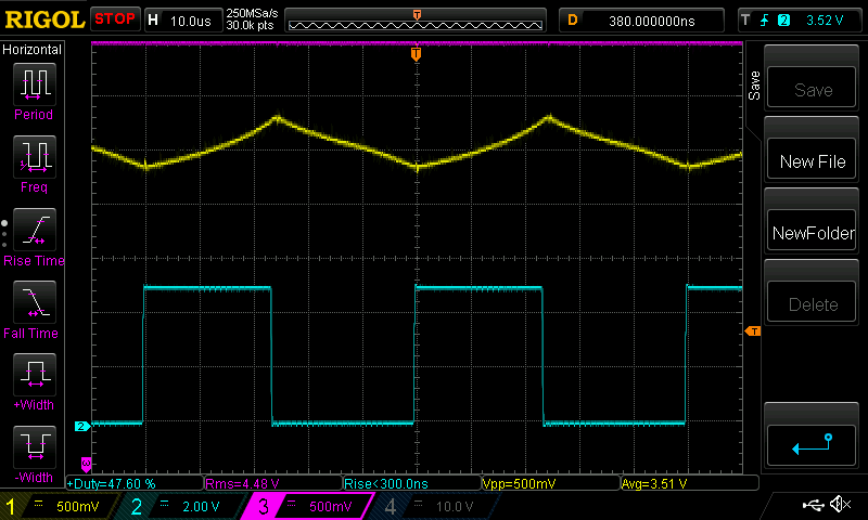

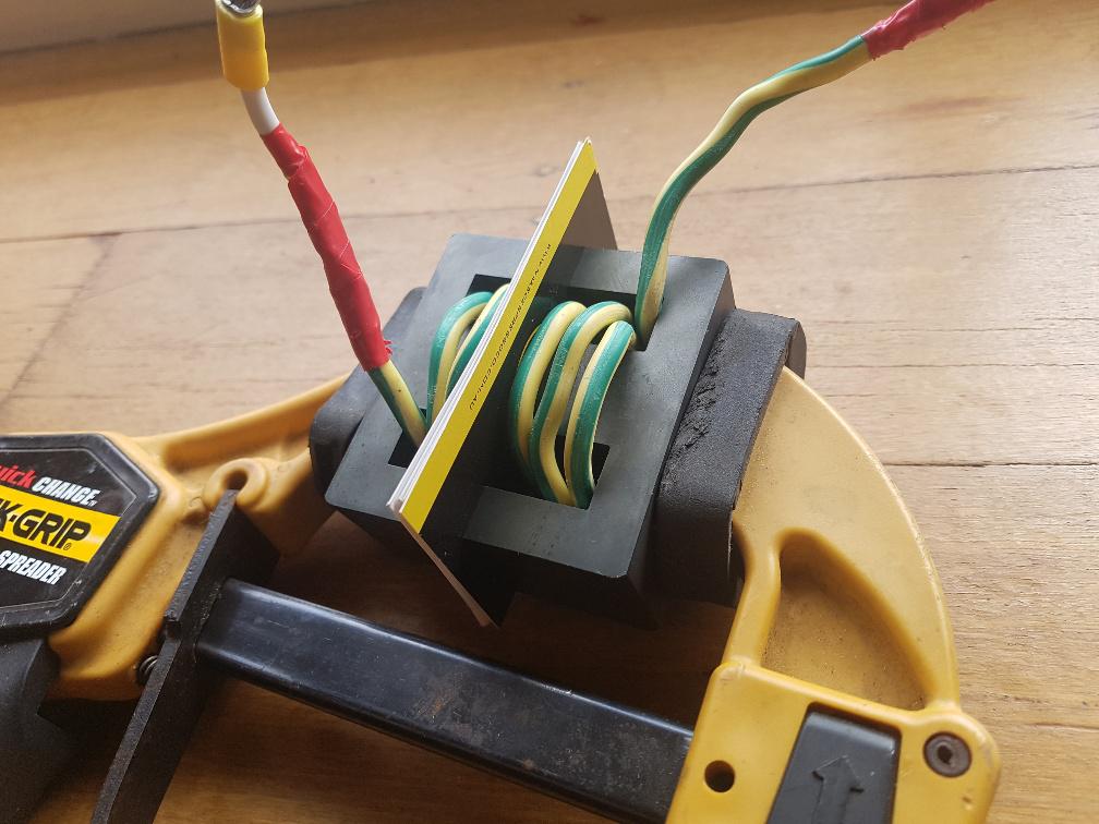

Now I made a gap between the two halves with 4 business cards. This gap is about 1.5mm, let's see how it changes things..
For a start, the inductance for 7 turns is now 21uH, a lot less than the 450uH.
and at higher power
It has completely changed things. Now it looks like a usable inductor for the job.

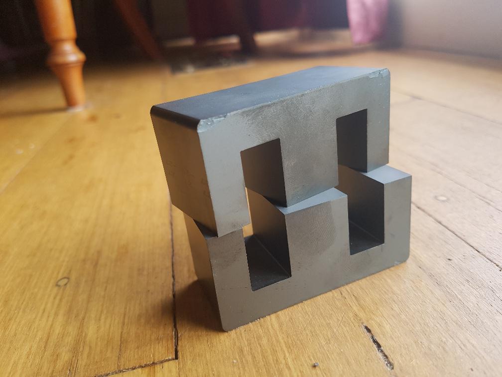

So this is with two yellow inductors.  Can you take a photo of the inductor complete with business cards please?
Grant
Persistence is the key
poida
Joined: 02/02/2017
Posts: 1507
Posted: 11:35pm 05 Jun 2020
these ferrite cores are 70/33/32 TDK items, see above for the RS Components part number.
The core material is N27, which is has a smaller AL value of 8850nH compared with the slightly better? stuff N87 at 9700nH

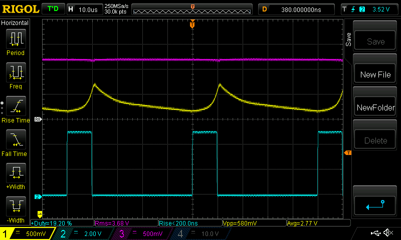

So today I tried with a gap of about 0.6mm on the middle arm.
Testing today is 110V input, since that is how we will roll anyway.
Power level is about 1700W. I did not want to go higher
7 turns.

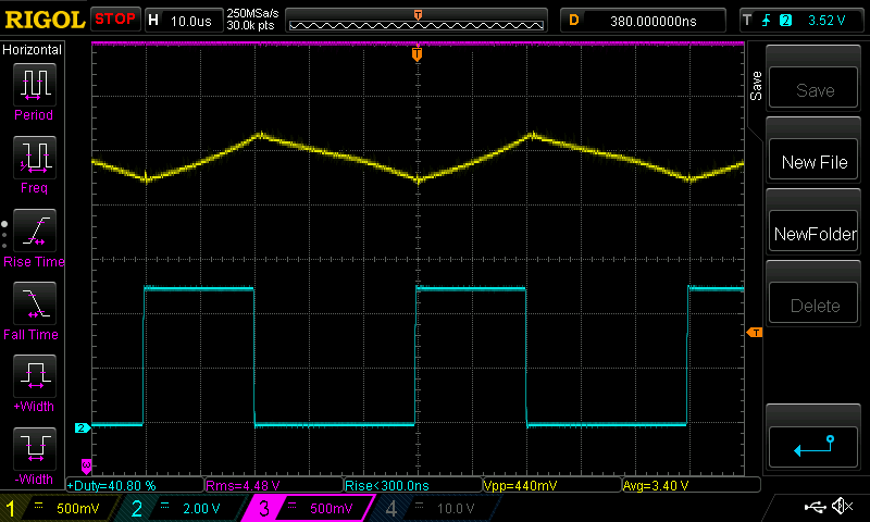

Yellow is inductor current, 0.5V/div, or 25Amps/div
Light Blue is pwm

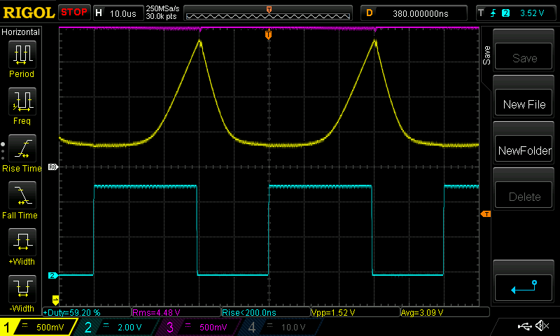

0.6mm gap:
Very clearly saturating. This is not what I want or will ever use.
and I thought we need a bigger gap so here is 1.6mm
at about the same power level, maybe a bit more:
Much better.

Here is a photo of the ugly workmanship, giving the "1.6mm" gap.
It looks just like the other one really. Not a lot to learn.
So 7 turns, 1.6mm gap, $26 E core ferrite
E 70/33/32 N27 pair of cores, RS part no. 47-9367
Digikey has them for $15 each, you need two. part no. is B66371G0000X127
I used 2 x 4.5mm2 conductor for the coil. It just fits.
job done.
