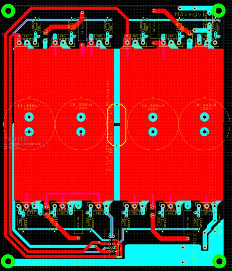

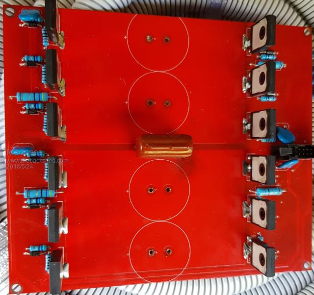

I have had a request for some of these PCBs in the inverter above if anyone is interested. Price would be around $17 each plus post, I still have control boards also for $15 each.
They take 12 HY4008w MOSFETs and will easily do 4KW continuous, they are basic, no Totem poles but work really well off any of the control boards. PCB is 2oz, 200 X 150MM the toroid I am using with this is from the Aerosharp with just the outer windings removed and a 22 turn primary. Heatsink is one from the Aerosharp cut down to suit. You can build one of these with just one 3KW Aerosharp GTI.Edited by Madness 2018-05-25

I have added a few extra components to the 4KW Power PCB that were not there before. Original I had made this board for testing only and had not included any of the protection capacitors of MOVs.

So far no one is urgently wanting the smaller Power PCBs, I have had requests for 7 so far when it gets closer to 20 I would look at ordering. I am thinking it will be a couple more weeks and I will be thinking about ordering some GTI regulator boards. Combining the orders then would be better as it reduces the freight cost a bit.
