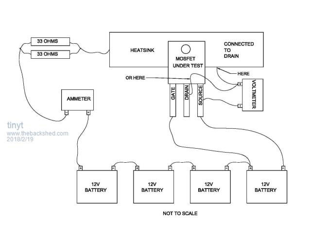

Posted: 05:49pm 18 Feb 2018
  renewableMark said
...I'm using 4x20ah 12v in series 2x20w 33r resistors in parallel (in water)
Which is giving 10.3mv and .048A
I am trying to figure this out:
4x20ah 12v in series = 4 x 12 = 48V
2x20w 33r resistors in parallel = 33/2 = 16.5 ohms
I assume that the connection for measuring current is batteries(positive terminal) + ammeter + resistors + mosfet + batteries(negative terminal).
If the mosfet is dead short, there will be maximum current of 48/16.5 = 2.91 amps
If the mosfet is 'bad'. For example, there is a voltage drop of let us say 1 volt across the mosfet drain to source , the ammeter will read (48-1)/16.5 = about 2.84 amps. Then the RDSon of this mosfet is about 1V/2.84 amps = .352 ohms or 320 milliohms.
I don't know what meters are being use, if the connection is what I described above. maybe there is too much voltage drop in the ammeter or between mosfet drain and the heatsink. Or maybe the mosfet is not being gated on (+ 12 volts with reference to mosfet source/battery negative)
Edited by tinyt 2018-02-20

Posted: 08:29pm 18 Feb 2018
Oh jeez I'm a goose, I had the ammeter across the legs, not in series.
What a prawn, that's so silly it's embarrassing.
Thanks Tinyt, that drawing is correct except my ammeter was in the same position as the voltmeter.
Thanks everyone.
Cheers Caveman Mark
Off grid eastern Melb
Posted: 09:20am 19 Feb 2018
Mark, in that drawing the (milli)Volt meter should only connect where you marked "or here". And do use test probes (the ones that came with the meter), placed on the drain & source leg, as close as possible against the Mosfet body, despite what mad mentioned about probes.
How about testing the millivolts with the probe tips and also with the alligator clips? If there is no difference I stand corrected.

Posted: 03:17am 24 Feb 2018
OK boys,
had another crack at the fet testing
Still using 48v bank, did the wiring as per TinyT's diagram.
Only change is I used more resisters 4x 10ohm in parallel then in series with another lot of 4 in parallel giving me 9.6 odd amps.
So @ 48v I am getting 28.7mv @9.58A
I have done 8 so far and all look similar.
Do those figures look right?
Cheers Caveman Mark
Posted: 03:20am 24 Feb 2018
Sounds about right.
28.7mV divided by 9.58 = 2.995 milliohms.

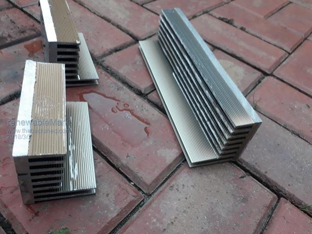

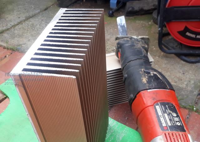

Got to the heatsink part.
I was going to use the compound mitre saw, but the blades were $90 for a metal one, and probably won't use it again, so went with the scumbag option.
After stuffing around I really wish I just got the metal blade for the saw.
The cross cut worked out really well, but cutting the fins was a bit of a bugger.
They need a bit of cleaning up and getting rid of any loose bits, might pressure wash it after filing.
Cheers Caveman Mark
Posted: 11:08pm 02 Mar 2018
A rotary wire brush in an electric drill will remove all of the "fluff" and leave a smooth burnished finish.
Posted: 09:56am 03 Mar 2018
I don't understand you guys. You have a beautiful heatink, big enough to cool the inverter without the fan running 95% of the time.
Then you go and butcher a lot of the fin area off .
So you end up having to install a big fan or two and have it running a lot.
Beats me...

Posted: 10:20am 03 Mar 2018
I'm limited with the design of the board, the heatsink has to fit around the capacitors. Mad reckons his fans never get to full speed, Oz likes keeping the caps cool with airflow, if the fans only take a couple of watts then no big deal.
With all the offcuts and extra bits I'll have I did think of bolting on more heatsink to the backs of the fitted ones. Haven't got that far yet.
Cheers Caveman Mark

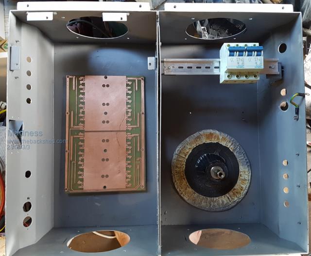

Madness
Joined: 08/10/2011
Posts: 2498
Posted: 11:20am 03 Mar 2018
That is right they don't get to full speed but they are big 140mm fans, also I have mine setup so natural convection helps the cooling. I have the fan speed controller set so a few degrees above normal running the fans startup.
This the empty case as it hangs on the wall.
Tinker Mark is following the original Oztules design, he does not have the experience to go out on a limb with a one-off design.
Edited by Madness 2018-03-04
Posted: 01:33pm 03 Mar 2018
Is it not possible to fit the capacitors on the other side of the PCB? They do have plated thru holes, have they not. This idea certainly works for me, allowing untrimmed heatsinks to fit on the the PCB. The caps are kept cooler there, away from the hot heatsink fins, in the bargain.
Or did this idea not occur to the followers of the original oztules design?
Interesting to see all the work involved in fitting two Aerosharp enclosures together to gain more space.
Making a new enclosure from scratch would be just as much work but with the big advantage of having *no* size restrictions and the choice to mount parts so they connect easier with others in the enclosure.
I'm just assembling my 3+ KW inverter, might take some detailed pics to show what I'm getting on about.Edited by Tinker 2018-03-04
