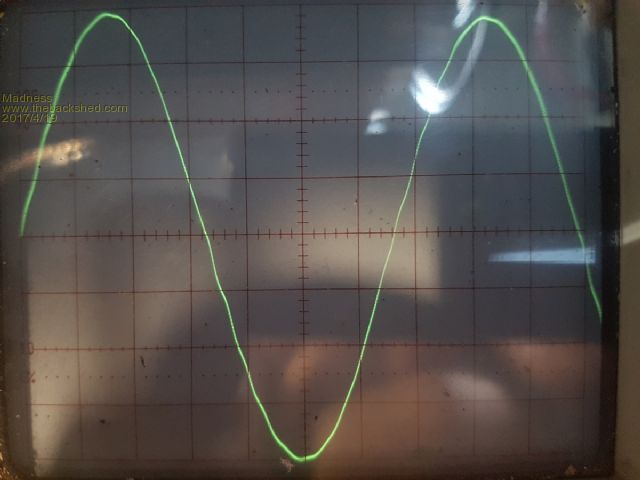

Posted: 11:10am 19 Apr 2017
I found the cause of the small waves within the waveform as shown here.
It was the old Trace inverter, I turned it off and the big Inverter reduced the noise it makes to about 1/3 and the wave smoothed out completely running at 350W. So I tried the small Ozinverter at idle and with load and it no effect on the other inverter.

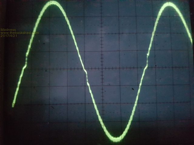

Posted: 03:02pm 20 Apr 2017
Warp are the bumps you are referring to those that appear at zero crossing? as per this pic.
Posted: 04:25pm 20 Apr 2017
I cannot find a really suitable picture on the internet, but this is a sinewave with one particular fairly high order harmonic added onto it.
If there was a very strong transformer self resonance it might look something like that, with a higher frequency sine wave ripple superimposed on the 50Hz.
