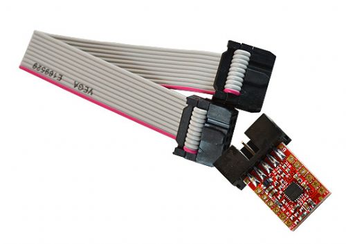

Here is Olimex solution:
Does not matter if is the main board or the sensor board, all of them have male connectors. The worn-able parts are on the removable/replaceable cable. This is what I consider design based on experience.

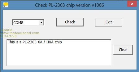

I downloaded the latest drivers and there was a program to see if the Prolific IC is a copy
It must be a combination of Windows 8, Prolific interface and 38400 baud.
