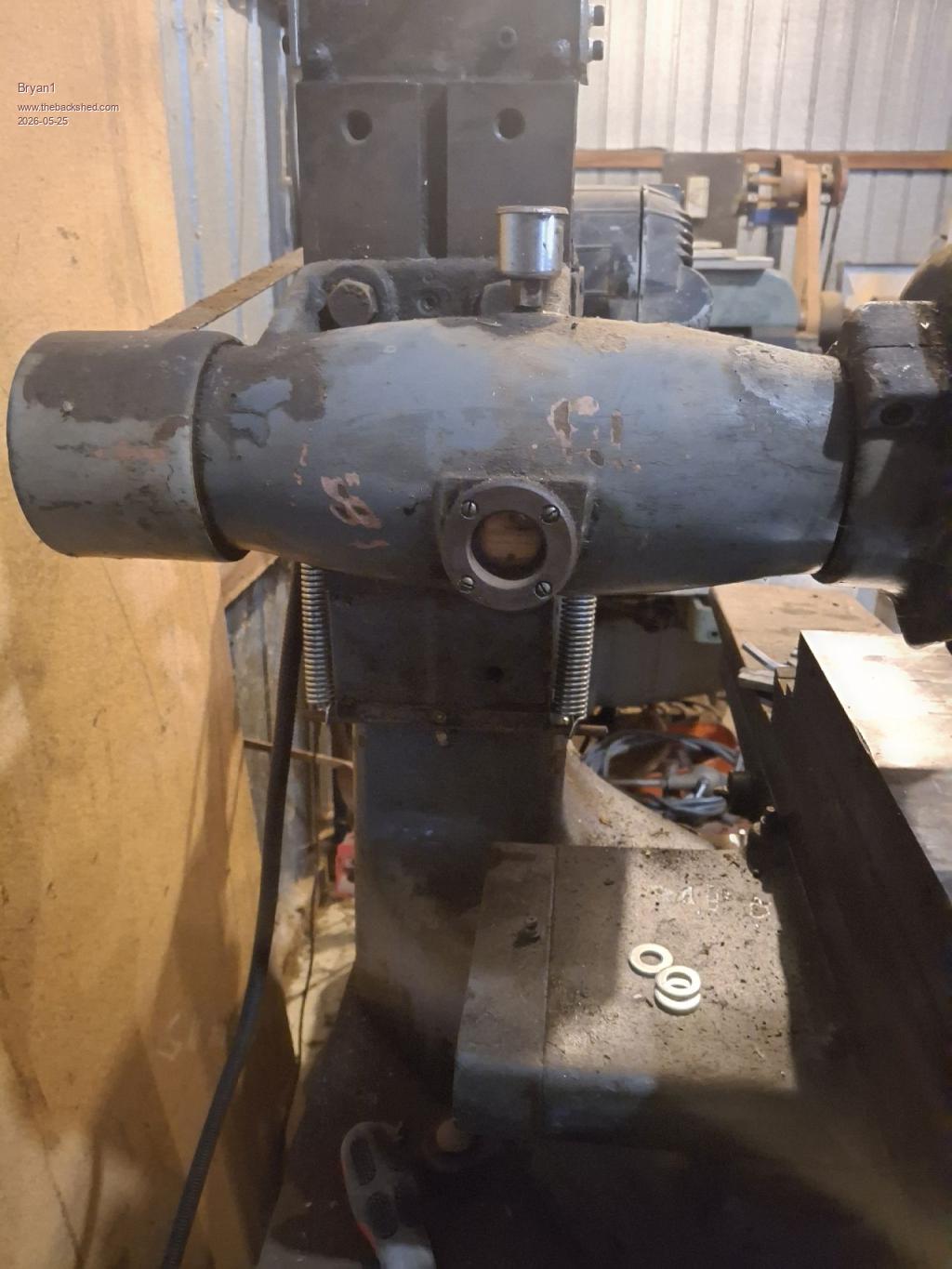

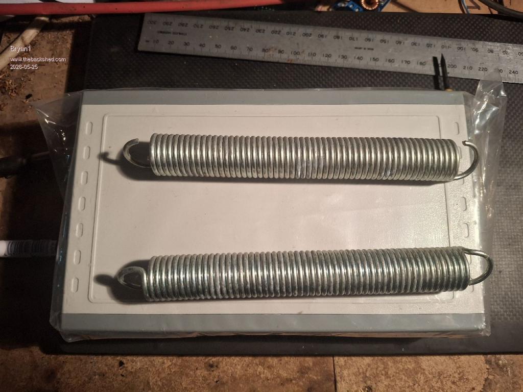

Well while walking up my shed this morning thought about those heavy springs I had in my shed
So I do think they may be strong enough to take the slop out of the Z axis so I will fit them and give it a try.
Also shown is the project box I will be mounting the LCD screen on and the PCB's can also go in there and I'll make a mount so it's easy to see on the surface grinder.
Regards Bryan

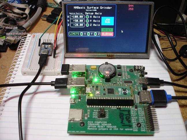

mozzie
Joined: 15/06/2020
Posts: 505
Posted: 04:49am 25 May 2026
G'day Bryan,
Those springs look like they will be up to the job    My little sis had a trampoline but in the end all the springs went missing, me and the old man had better uses for them
Some further thoughts, if you say you are getting 1mm travel with 6450 steps at 8000 steps / REV that means 1.24mm pitch leadscrew, that doesn't sound right
A simple test would be to draw a line on the coupling (or use the grub screw as a reference) and see if it does 0.8 turns, otherwise something is up s**t creek.
With Peters addition of the GUI system to the HDMI build we might be close to being able to use much larger HDMI / touch monitors for a screen, more testing to follow. This is just a mockup test but it does work
Regards, Lyle

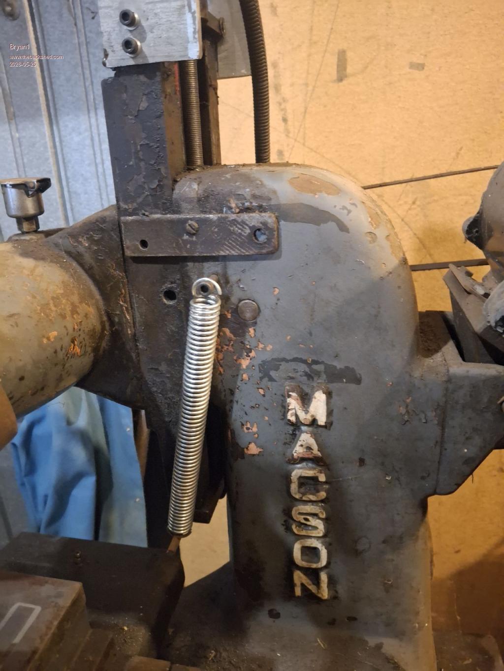

Bryan1
Joined: 22/02/2006
Posts: 2298
Posted: 05:18am 25 May 2026
Very nice Lyle   Just did a test with these springs and I reckon the drift is now under 0.1mm on average, now it could be put in the code when the Z axis goes down it goes straight backup to putting pressure on the thread. I did measure 1.6mm backlash using 1mm of travel and my metric dial indicator which does let me see the drift happening.
Now for the top of the springs there is a 1/4"BSW thread so I put longer set screws in to accommodate the springs. Now on the rear there was a hole at the same height so the springs are balanced.
For securing the other side of the spring I just used some 1/4" round bar and it sits nicely under the bottom plate.
Now just tested on the up travel and the coupling does go about 0.8 of a turn and it's the same on the down travel after the backlash is taken up.
