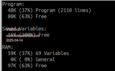

Posts: 6253
Posted: 04:59pm 13 Apr 2025
  Mixtel90 said  The Library is, in fact, really simple. The only weird thing about it is that LIBRARY SAVE should really be called LIBRARY MOVE because it moves the code from program space to the Library then does a NEW, there is no copy of it left in the program area.
Typically you would run something like "fm", which would call "SUB fm" in the Library. I suppose this could be fm "A" or fm "B" to select the initial drive.
The rest of the Library routines are ordinary SUB and FUNCTION routines as you'd expect. The beauty of the Library system is that all the routines stored there can be run from a user program, so an input routine, for example, even though it would be intended for SUB fm could be used anywhere.
I've also run TassyJim's file manager from drive A. That worked out ok. I hate losing another flash slot - I can't see any reason to do so unless it's only during development.
Hi Mick,
Including a program into the library, something as large as the filemanager, may not be a good thing. Note that the filemanager then is part of your user program. All the memory it reserves (for all the filenames) become part of your programs heap. And to handle large (SD card) file systems, they reserve quite a lot of heap (59k of 100k on a VGA unit with twofingers KLINGON version of the filemanager).
The result will be that your user program can only be small (cannot use large arrays or lots of strings). Maybe sufficient for your fish tank controller, but that is it. And since it is in the library, that accounts for ALL program you want to run on that pico.
When it is in a flash slot, it is -either-or-. So it is a separate program, and yes, it uses a lot of heap, but when you close the fm, and start your own program all heap is yours.
I think it is wise to keep it in a flash slot.
Edited 2025-04-14 03:15 by Volhout

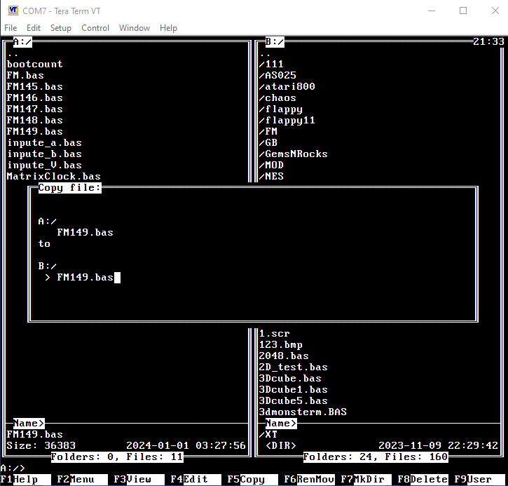

Posted: 07:30pm 16 Apr 2025
FM 1.49
NEW Input Line EDITOR. Thanks @twofingers
CHANGED some file coloring colors @Volhout
You can disable file coloring by explicitly specifying the color of the constant.
DFColor=15 for all white!
In the future I want to make a configurator for color settings and other things in the program itself
FM149.zip
With the terminal properly configured, File Manager works simultaneously on both the local PicoMite VGA/HDMI screen and the PC terminal.
Edited 2025-04-17 05:34 by javavi
homa
Joined: 05/11/2021
Posts: 754
Posted: 09:00pm 16 Apr 2025
Great!
question: How can I rename a file with "F6 RenMov" without moving it to the other drive? Somehow I can't get it to work and I think I'm missing it.

javavi
Joined: 01/10/2023
Location: Ukraine
Posts: 636
Posted: 02:08am 17 Apr 2025
  homa said  question: How can I rename a file with "F6 RenMov" without moving it to the other drive? Somehow I can't get it to work and I think I'm missing it.
Hallo! Matthias,
To rename a file, you need to select the same directory on both panels and change the file name when moving it using F6.
However, I checked and I couldn't switch the panel to another disk via the console.
It looks like the console doesn't transmit the Alt key code. It looks like the terminal doesn't transmit the Alt key code, but uses it to switch to its menu.
I'll fix this and also see what can be done about other issues.
Thanks for the feedback ;))
Edited 2025-04-17 12:21 by javavi
