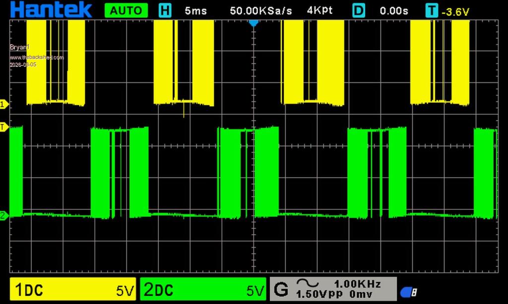

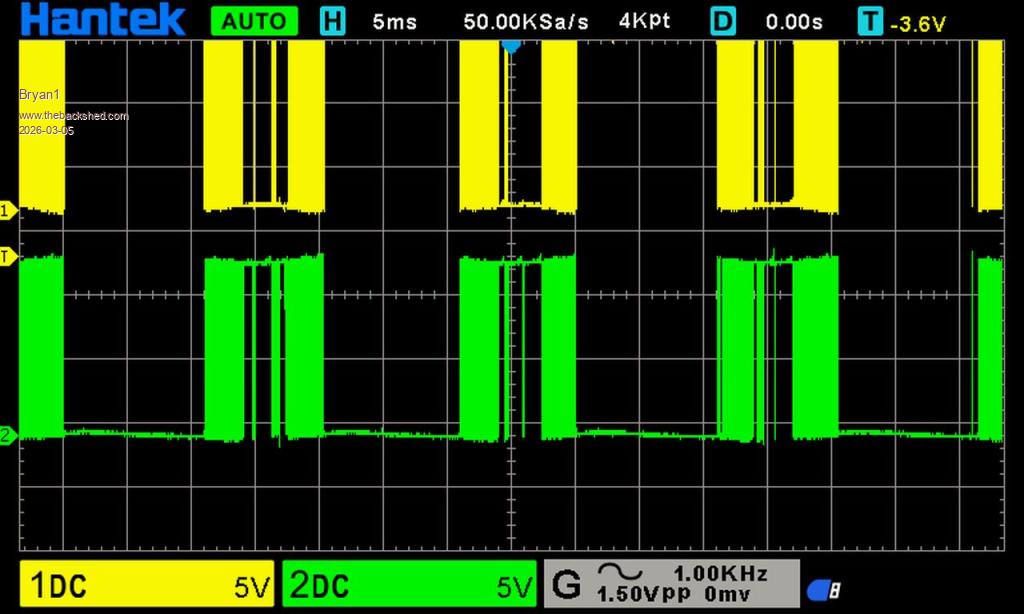

Here is the test for pin TinyT suggested
tinyt
Joined: 12/11/2017
Posts: 564
Posted: 01:39am 05 Mar 2026

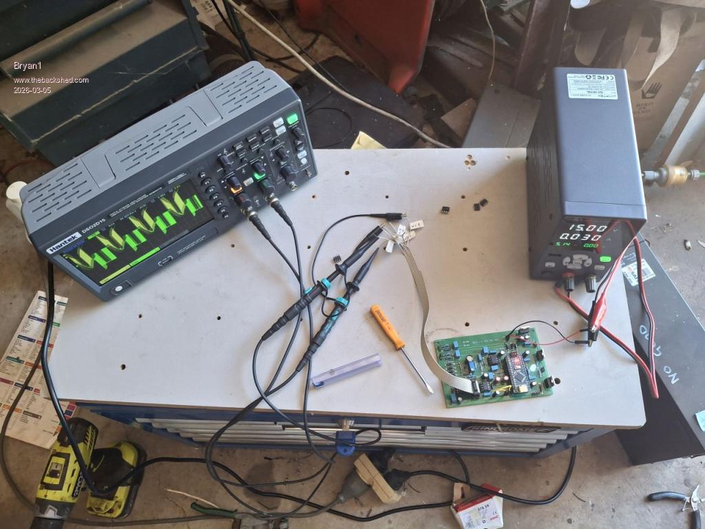

  Bryan1 said  Well it is amazing what happens when one turns on the control board
CH1 L01 Gnd VS1
CH2 L02 Gnd VS2
My setup for these tests
Now for that pin test
Looks like probe grounds are not connected to the controller board ground.
VS1 and VS2 wires should be connected to ribbon cable wires for pin 9 and 10.
Edited 2026-03-05 11:41 by tinyt

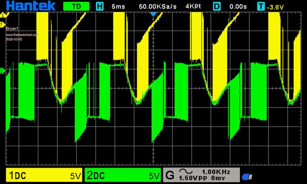

Bryan1
Joined: 22/02/2006
Posts: 2297
Posted: 01:48am 05 Mar 2026
Ok time for a reset as learning here
Ch1 L01 gnd VS1 + gnd
Ch2 L02 gnd VS2 + gnd

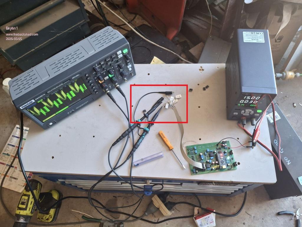

tinyt
Joined: 12/11/2017
Posts: 564
Posted: 01:51am 05 Mar 2026
Can you post close up picture of the area inside the red rectangle?
Edit: Have to go, hope others can continue helping.
Edited 2026-03-05 12:01 by tinyt

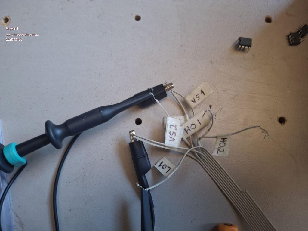

Bryan1
Joined: 22/02/2006
Posts: 2297
Posted: 02:00am 05 Mar 2026

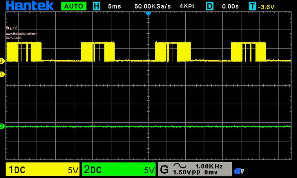

Here is the test for CH 1 L01 Ch2 H01
Now for that close up
CH1 L01
CH2 H02
Edited 2026-03-05 12:06 by Bryan1

tinyt
Joined: 12/11/2017
Posts: 564
Posted: 05:04am 05 Mar 2026
Ribbon cable wire identification looks good to me.
Can you capture again:
Ch1 L01
Ch2 L02

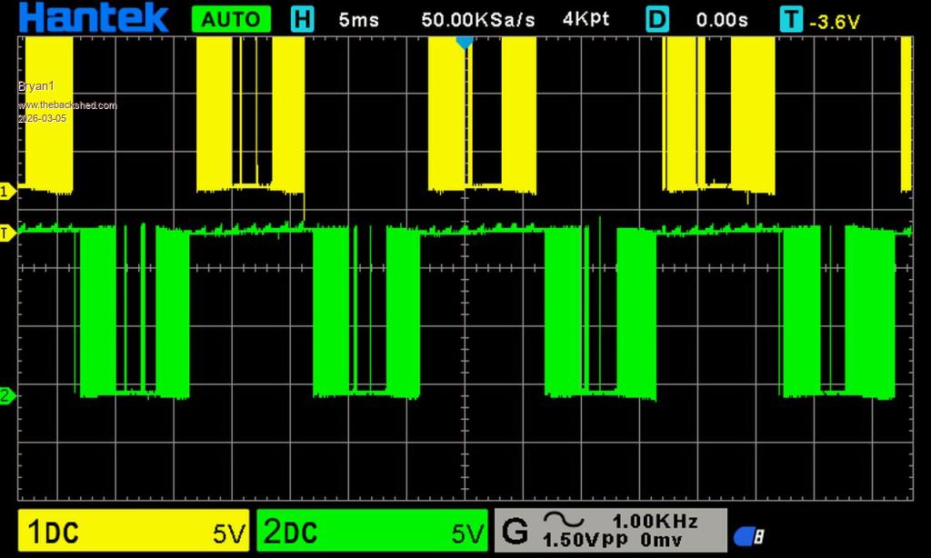

Bryan1
Joined: 22/02/2006
Posts: 2297

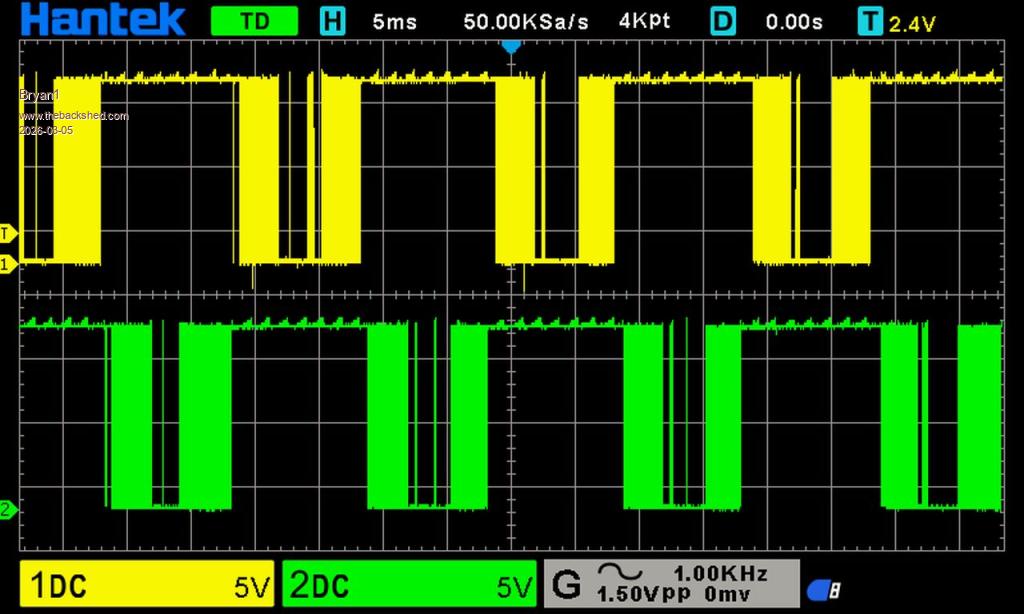

Posted: 06:34am 05 Mar 2026
Ch 1 L01
CH 2 L02
tinyt
Joined: 12/11/2017
Posts: 564
Posted: 02:54pm 05 Mar 2026

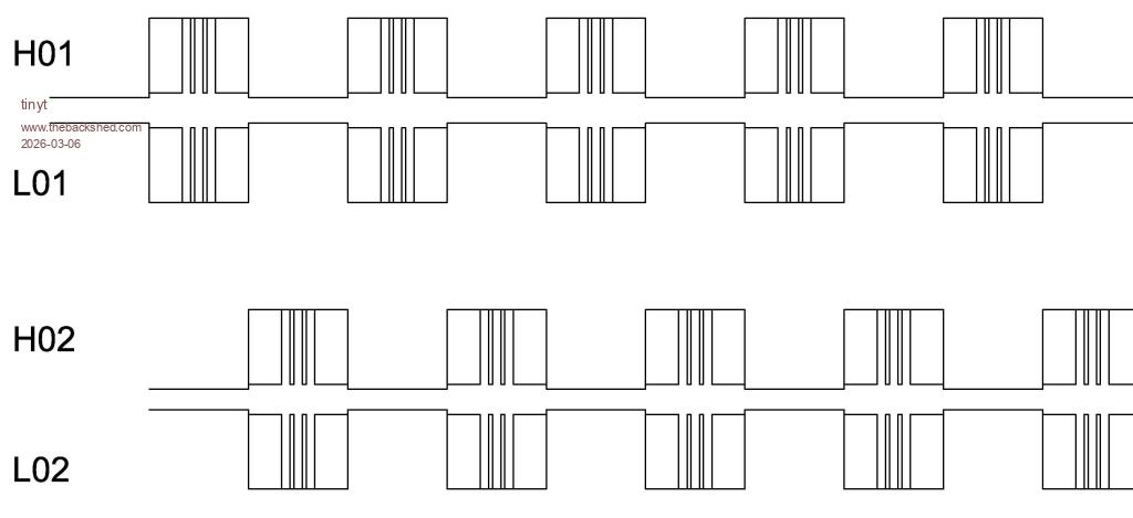

If the intent of the nano code is to produce the waveforms and timing relationship is as shown in the sketch below, then the picoverter board is working correctly.
I guess it is time to examine the power board.

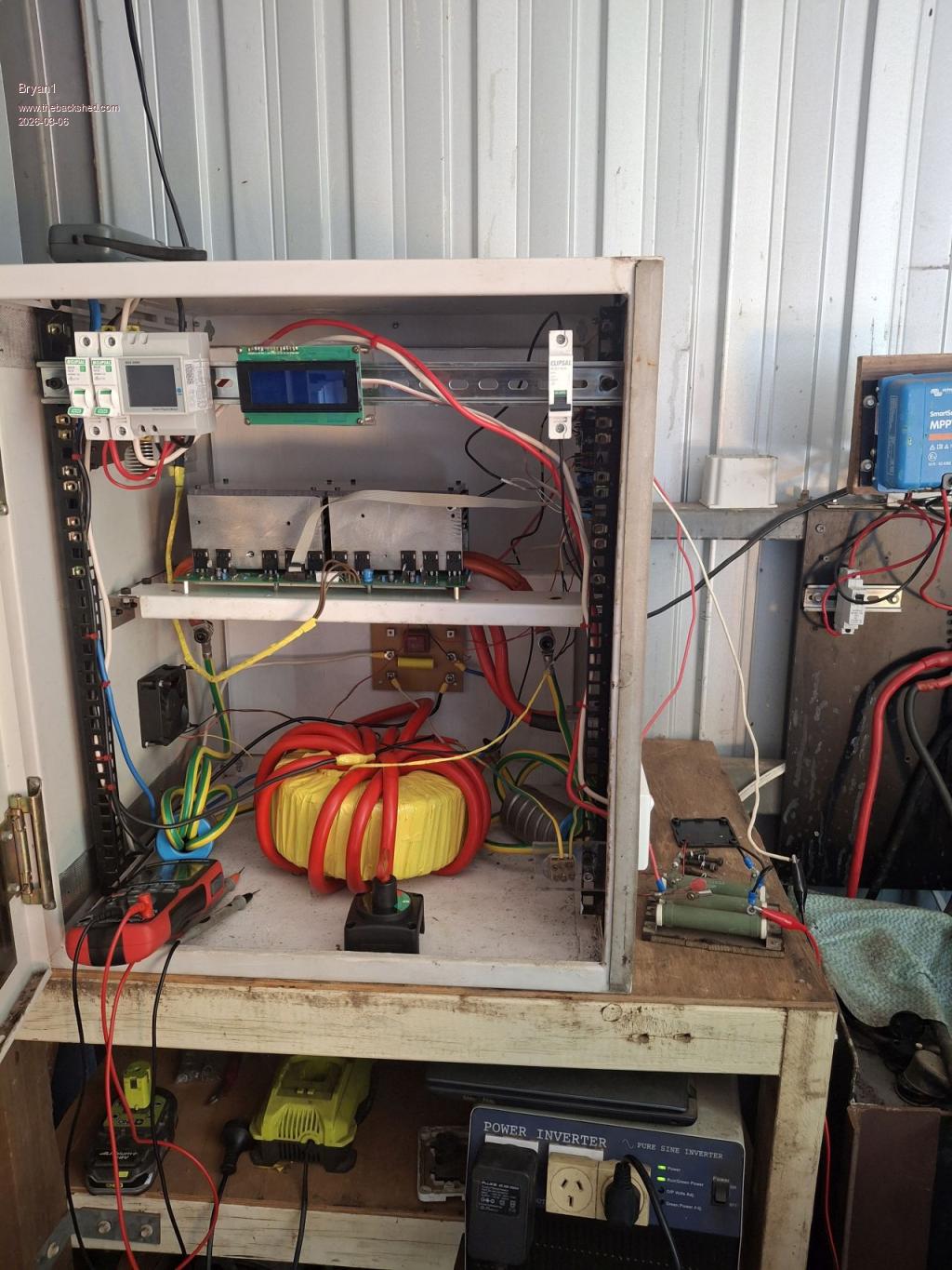

Well got the controller board back in and all connected
Now in the box is my 450 amp on/off switch I'm going to use, so on the inverter side of the switch can be powered by the resistors then when the caps are pre charged just turn the switch on and turn off the switch for the resistors.
By the way that inverter below has been powering my shed since 2005
Edited 2026-03-06 09:39 by Bryan1

Bryan1
Joined: 22/02/2006
Posts: 2297
Posted: 12:21am 06 Mar 2026
Well it just as before and did have a bit of fun as on startup the nano was off even with the on/off switch on and had nothing on the lcd. Tried a couple of times and it was the same so used avrdude and a 5 metre usb cable and reprogrammed the nano. The nano kept playing up so soldered up a new nano to use.
Now when I set the voltage to 15 volts the BV stops at 11.4 volts still even when the voltage is raised to 24 volts with the nano turned on, by turning the nano off the BV does rise to Vbat
Now the current draw was staying below 100mA so not sure what is going on.
Edited 2026-03-06 10:42 by Bryan1
