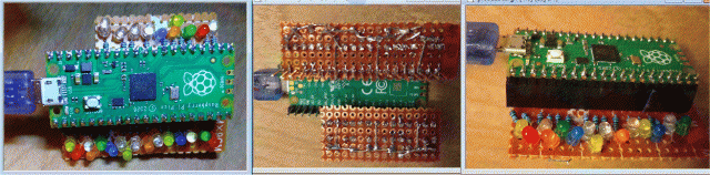

Posted: 02:18am 17 Jun 2021
More Playin'
With 26 LEDs on the PicoMite with 1K resistors on the LEDs.
dim integer prtm(9),pr(9)=(21,22,24,25,26,27,29,31,32,34)
dim integer pltm(15),pl(15)=(1,2,4,5,6,7,9,10,11,12,14,15,16,17,19,20)
' half-second time resolution--500ms
for i=0 to 9: ?pr(i);" ";: setpin pr(i),dout: next i
for i=0 to 15: ?pl(i);" ";: setpin pl(i),dout: next i
t=timer
for i=0 to 9: prtm(i)=rnd*10000+t: pin(pr(i))=1: next i ' random delay times up to 10 seconds
for i=0 to 15: pltm(i)=rnd*10000+t: pin(pl(i))=1: next i ' random delay times
pause 2000
do
 for i=0 to 9
   if timer > prtm(i) then: pin(pr(i))=1-pin(pr(i)): prtm(i)=rnd*10000+timer: endif
 next i
 for i=0 to 15
   if timer > pltm(i) then: pin(pl(i))=1-pin(pl(i)): pltm(i)=rnd*10000+timer: endif
 next i
loop

Very pretty, Lance. :)  Just watch the max total IO current allowed on the RP2040 when you are plastering them with LEDs. It's a bit stingy even compared to PIC chips.
IOVDD input current must be less than 50mA - that's the max total output from all output pins at the same time.
IOVSS sink current must be less than 50mA. Once again, that's the max. across all the pins at the same time.
To stay within logic levels:
Individual pin source current should be below about 25mA max.
Individual pin sink current should be below about 15mA max.
I suspect these will both actually be defined as 12mA by default on the Pico.

Thanks for those figures. I knew that they needed attending to, but hadn't found them. I figure all LEDs on for 2 seconds, about 85mA with 1K resistors, so over the limit, but for a short time, so it hasn't mattered so far. On average, about half are on at a time, so ~43mA.
I looked for some 1K2 resistors that I know I have, but didn't find them. Looks like 1K8 would do it. I'm pretty sure these "ultra-bright" LEDs would illuminate well enough with 1K8. Maybe they'd reduce the glare in my phone camera sufficiently to enable a better video.

I've found that with a lot of modern LEDs you only need a couple of mA, especially for indoor use. You can sometimes manage with less than that. On the other hand, I have some old red ones that are almost useless below about 12mA.

Thanks Lance, that's given me confidence to try running my 8x8 hand-made LED matrix on the Pico bare-back ... at least on the input side, I'll sink it through some transistors.
