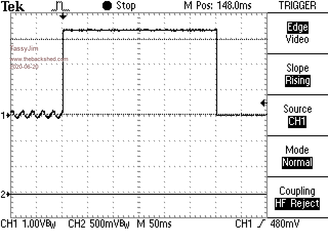

To test the CMM2s long line capabilities, I add extra capacitance to the pin 40 and turned on.
I made a total balls up with my testing. I will start again with things connected to the right pin and report later.

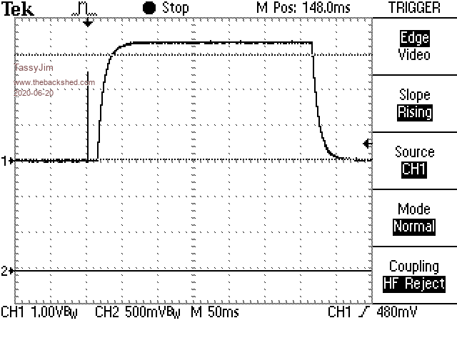

But pin 40 is the correct pin in question? ie. PB13, based on the schematic.
Posted: 11:22pm 19 Jun 2020
  Quote  But pin 40 is the correct pin in question? ie. PB13, based on the schematic.
Yes but I didn't have pin 40 connected.
This makes more sense.
250mm of IDE cable to a breadboard. I measured about 30pF
A short turn-on pulse then 15-20 mS later, the test starts. Pin 40 pulled high for 300mS
If the reset button is pressed, the initial 15-20 mS delay is eliminated.
Add 33pF to the mix
no visible difference
I had to go to 0.22uF before there was something worth looking at
Every thing is fully settled down by 50mS at worst.
Sorry about the earlier mess. I lay awake last night, knowing that something was not right.
