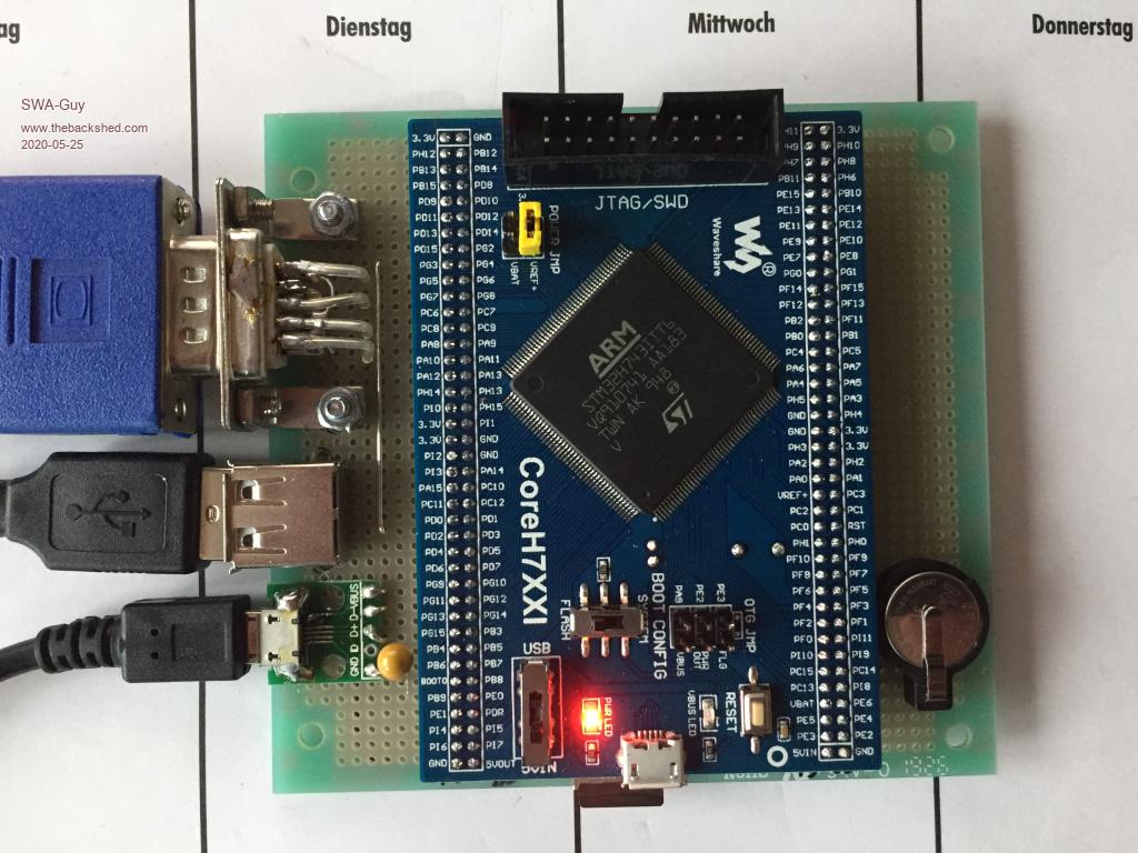

Hello Peter,
thanks for fast feedback.
I rewired the VGA-signal just like in your schematic. Now I have fantastic coloured screen.

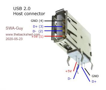

Another point I found, is the numbering of the USB-Host Type A for the keyboard. Attached the numbering I found in the internet. It is different from your schematics as well as in Geoffs.

  Quote  Another point I found, is the numbering of the USB-Host Type A for the keyboard. Attached the numbering I found in the internet. It is different from your schematics as well as in Geoffs.
The pin numbering is totally arbitrary and depends who drew up the schematic. Mine is the one that was provided by DesignSpark who happened to label the GND pin as pin-1 and then move forward.

  Quote  The pin numbering is totally arbitrary and depends who drew up the schematic. Mine is the one that was provided by DesignSpark who happened to label the GND pin as pin-1 and then move forward.
You are right, but if you (or me) use the schematic for your own testboard, you wire the connectors as shown in the schematic. And when then the numbering is not the same as in the standards declared you have problem. Just like here the keyboard would not work.
Sorry about my know-it-all instruction, but I'm an electrical engineer and deal with these things every day.

Hello Guys,
today I played a little bit with my color maximite 2 test system.
I noticed two things:
1. The core temperature goes up to 53°C with a current of 220mA for the complete system. The current for only the single Waveshare-board without my selfmade board is 210mA. Is this correct? In the beginning I read anywhere that the current should be ~145mA. I have two Waveshare-board, both have the same current.
