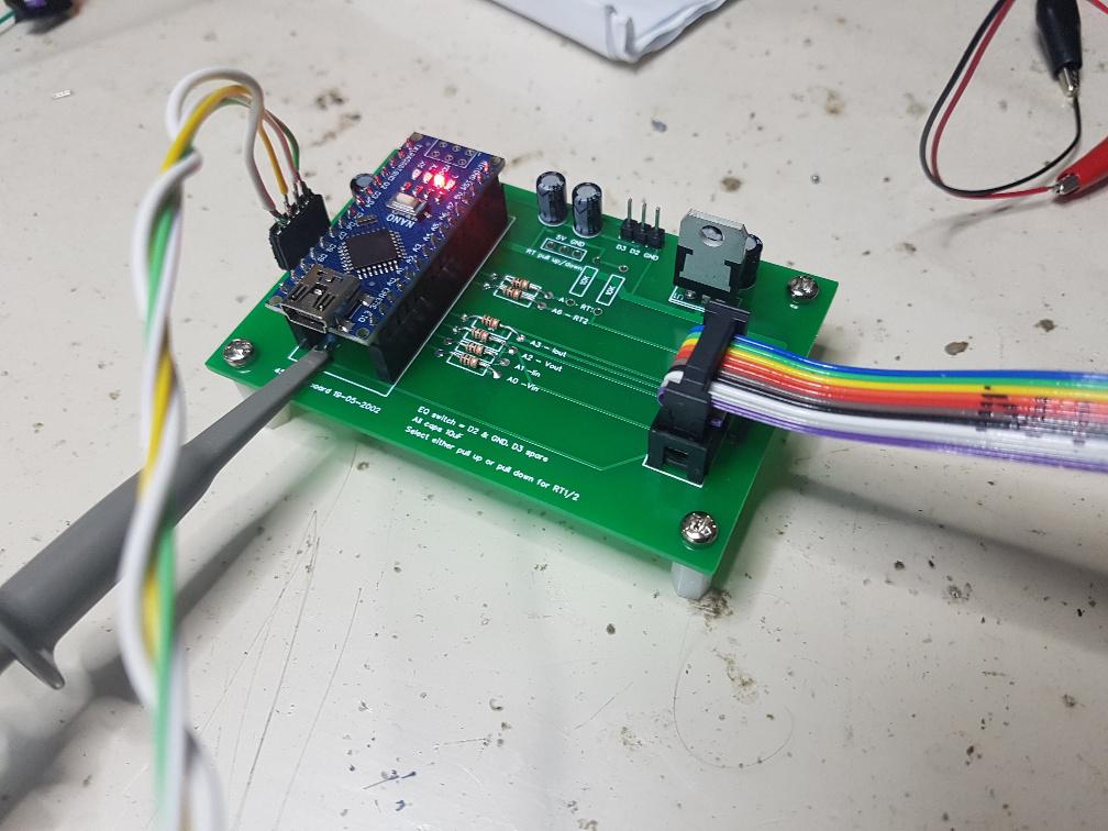

We can choose to enable the hardware overcurrent protection now.
If you choose to not build in the current sensor needed for this, disabling it
might be the way to go.
The brainboard will need a bit of extra soldering, for the overcurrent protection.
Two wires for the set point and current signal, one for 5V, one for ground.
And a trimpot to set the setpoint. Not too bad. Maybe add this to v2 of the board.

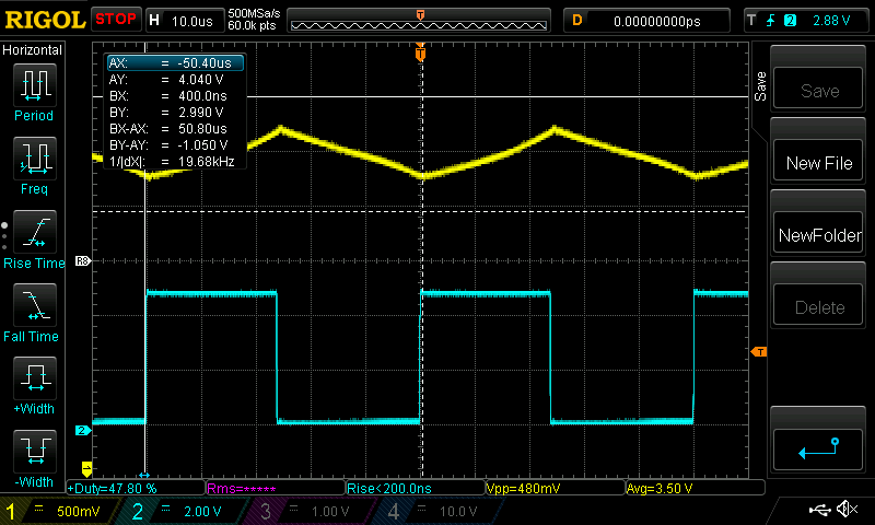

The Inductor:

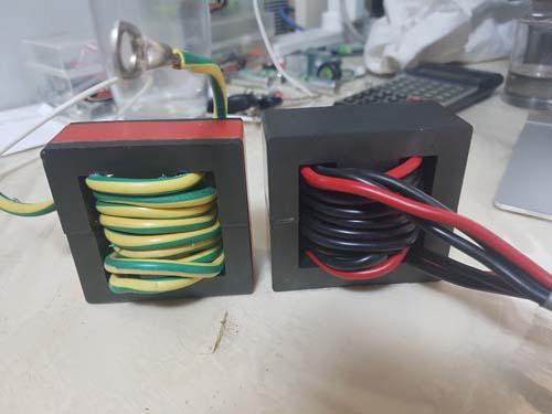

Earlier I compared one inductor to another.
The big one which saturated with too low current,
(the one on the right)
had I think 5 turns and no gap.

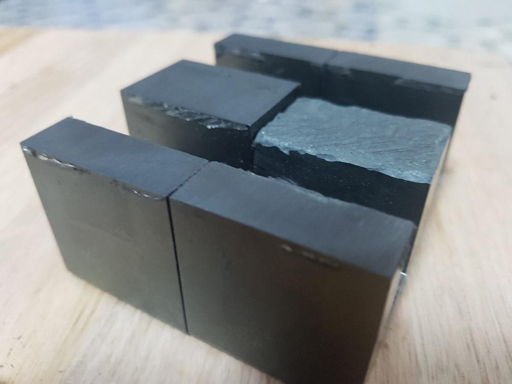

I rebuilt it today with a gap.
Now it's 37uH with 8 turns.
Here is the gap I chiselled with blunt instruments.
In my view the magnetic field in the air gap does not
care very much how good the workmanship is with the cutting
of the gap. There are still remnants of the epoxy on various edges too.
I made a gap of 1.5mm

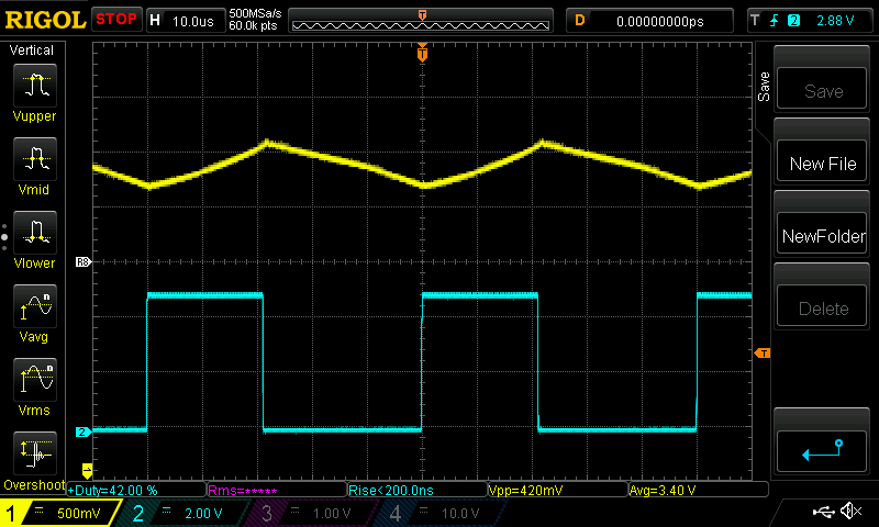

How does it perform, with 108V input, 2kW out and 20kHz pwm?
Recall this test shows clear signs of saturation with all the combinations
of inductors I have tested so far.
Really well as it happens. This is all I need for the controller.

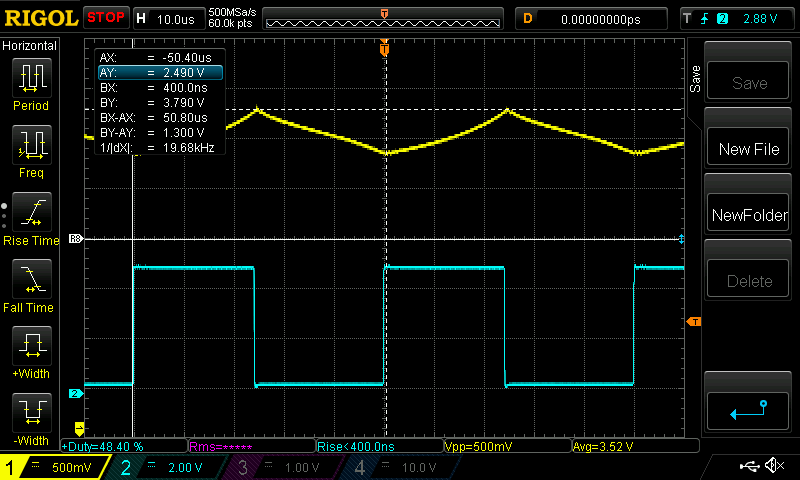

(from the DSO)
zero current = 2.53V
peak to peak current is 0.42V
average current is 3.4V
with a current sensor giving 0.0202 V/Amp we can see the average current through
the inductor (and through the load too) is
(3.4 - 2.53)/0.0202 = 43 Amps. This is confirmed by the current sensor on the output of the converter board.
The ripple current is 0.42 / 0.202 = 20 Amps.
This is sort of 50% ripple. It might lead to heating up of the output capacitors.
But no saturation. I thought I would eventually arrive at a suitable inductor.
I like how this one can cope with 20kHz pwm.
Even though I test to 2kW and the design output power is 45A at 57V which is
2565W I think this will be good enough. I doubt many of us will have
a battery sucking 45A at this absorb voltage for hours on end, assuming a 48V lead acid bank.
And here it is at 2450W
this is good.

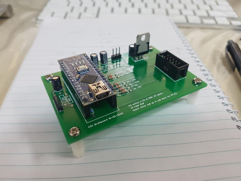

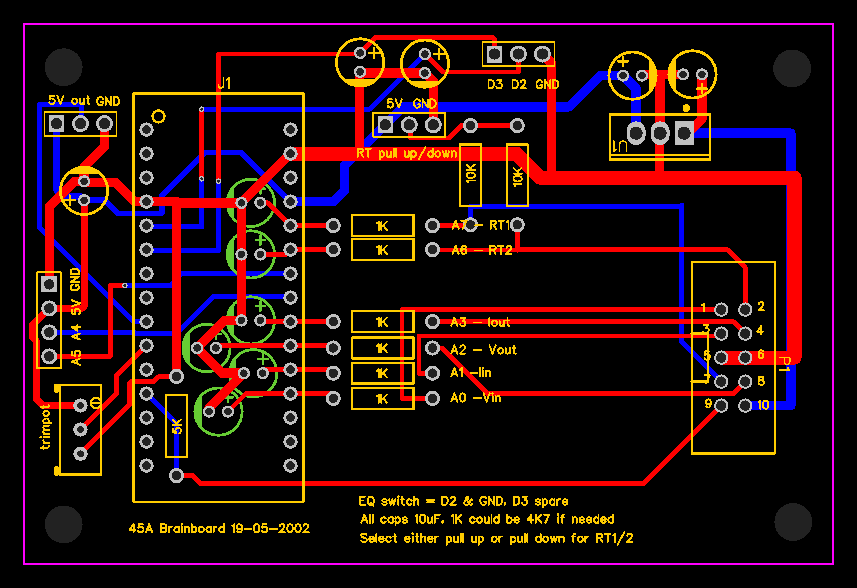

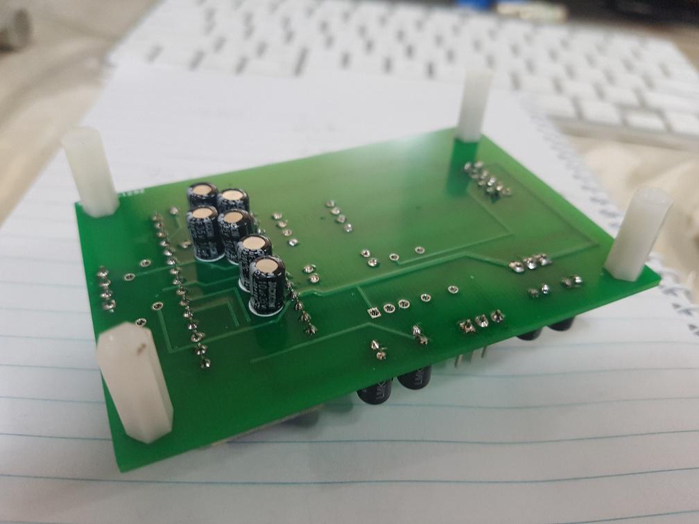

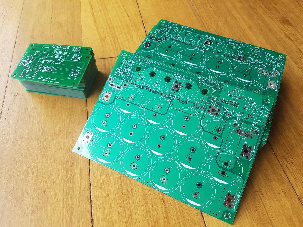

After discovering the need for over current protection, I thought it best to review the brainboard.
I have 25 boards coming from JCLPCB soon but I think I will order another 25 of
these, to replace them:
which have provision for a multi turn trimpot to set the max current and a 3 pin header
for the current sensor. This later board design will avoid needing a small
hack that has a trimpot, some leads hand soldered to the nano and what-not.
The current sensor will need be be something capable of 100 Amps or more.
Allegro make some that do that. I am using a LEM LTS 16 with a shunt.
(this is the sensor that I used in prior DSO captures, with it's 0.0202V/Amp sensitivity.)
I think that all we need is to have a current sensor on one of the inductor leads,
with 3 wires coming back to the brainboard, to the 3 pin header.
So if I get these boards, it will be another 2 - 3 weeks before I send out power and brain boards to those who want them. I want to combine postage and send out both a brainboard and power board as a unit.
Edited 2020-06-01 20:31 by poida

Poida what I sometimes do is fill the empty space on the pcb with via's (exposed copper) so I could add some stuff later on. Like an experimentation pcb.
wiseguy
Joined: 21/06/2018
Posts: 1335
Posted: 12:35pm 01 Jun 2020
Good point Nicks, I often do that too, & Peter dont forget that small via holes can add extra cost - the ones on the PCB shown look like a pretty small drill, they should be around 0.5mm (or whatever minimum hole the pcb manufacturer can do before adding cost).  & remember to keep the PCB dimensions within 100 x 100mm
Cheers Mike

When testing inductors on the bench with the pulse tester, I can determine the inductance from recording the change in current, the pulse time and the supply voltage and using L = V x s / A
s = time, A is Amps, V is volts
All things being equal, the inductance needed for a change to 100 Hz from 20kHz would be 200 times bigger. We would need a massive inductor.
I have ended up with an inductor choice of the above core or something similar, with a 1.5mm air gap, 8 turns. With the 50% duty cycle, 100V and 20kHz I find it can handle 3000W without taking peak current levels beyond about 70A.
Yellow is the current sensor, with 0.5V/div and 0.0202V/Amp
Blue is pwm. We can see the current increase when the DC supply is switched through
the inductor. Then the switch opens and current now drops.
The cursor line is at 1.3V from the 2.5V zero output of the sensor.
This is 64 Amps at the peak.
The low point of the current waveform is at 3.35V, that is 40A.
So the current grows 24A over the 24uSec period.
With much longer switch ON periods, the inductor will have to store massive amounts of energy. 100Hz is not feasible.

The boards have arrived today. I ordered them 15th May.
This is 12 days or so turnaround.
Last night I ordered 25 of the version 2 brainboards with the added trimpot and 3 pin header for the over current sense.
There are choices to be made I suppose.
I post you the boards, including version 1 brainboards now.
And post again v.2 brainboards later.
You end up paying 2x postage.

Nicks: That's probably a good idea but I tend to do the experimenting using
flying wires. The over current sense works perfectly well with 6 inch wires everywhere picking up EMI etc.
Wiseguy: The tiny vias are built in from EasyEDA PCB editor, I use defaults. Since JCLPCB is closely aligned with EAsyEDA I figure their users would be given cost effective and sensible defaults. When ordering the boards I found no option to reduce cost by via diameter choices. I reckon the vias are done with a laser and the sizes they get the easiest are the sizes baked into EasyEDA defaults. Who knows.
I too was looking at cap choices. The one in the parts list is just a start point and there are better options with lower cost & better performance.
I think I will use 1,000uF 200V caps with 4A ripple, maybe mix 4 x 1000 + 1 x 470
for the DC supply, and 2 x 1000 + 1 x 470 on the output. Don't know yet.
But it would be best to keep the total capacitance to about 4,250uF and 2,350uF
so that the firmware has a chance to work well. +/- 30% or so..
Probably well worth the time to have a look at digikey's caps, those ones you found look ideal and cost effective.
I find RS to be a lot slower with COVID19, I think I will start an account at digikey.
There will be a few changes to the build as we go.
For a start, the 2K7 on the input voltage divider (with the 47K) is too high for voltages over about 90V. Depending on your application, you might be OK with this.
Else a different resistor will be needed.
I calculate 2K should be good for 120V input, to give the Nano a less than 5V input to the ADC channel, about 4.9V actually.
I attach a good sized rendering of the power board schematic for reference.

I built a brainboard and it runs Nick's power board really well.
It's much nicer to not have wires and crap everywhere now.
The sensed inputs (Vin,Iin, Vout,Iout etc) are clean and the closed loop
control runs smoothly. Important this, it depends on a clean input.
(I can get a DSO probe on pwm output too!)
I did not fit the 2K2 resistors for I2C since they are not needed any more.

I used 1K resistors for the low pass filter for the 4 inputs
to see how they go. The signals are not too bad at all.
If needed we can use 4K7 or larger to kill more noise.

the switching node.
Mike's PCB addresses this issue and has a good many detail improvements
and I expect clean signals for all 4 inputs.
