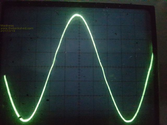

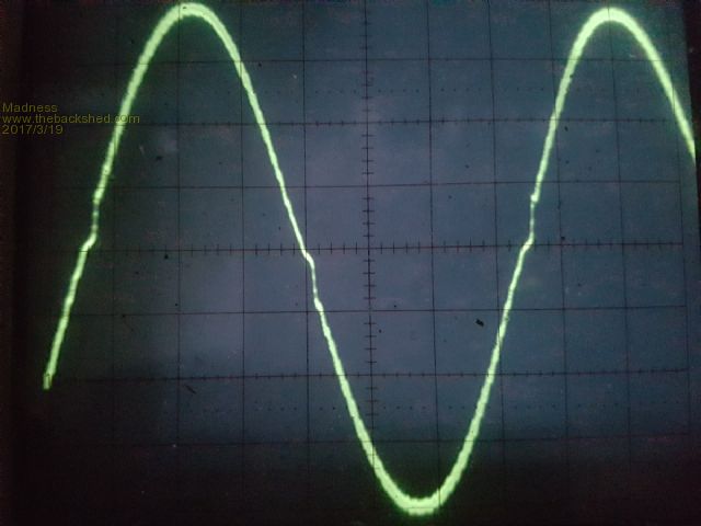

I built another power board last week and it all worked perfectly with 24 MOSFETs giving a perfect waveform, then I added CAPS to the board and spikes appeared and the idle current went from 0.25A to 5A.
Meanwhile I have been trying to isolate why I am getting different results to others and in Poida's thread there is mention of tank circuits etc and what could be causing ripples etc. My heat sinks are very large and electrically part of the primary circuit to the transformer. So I have made a half size test PCB and used some offcuts of heatsinks to make a minimal size version. So far this is woking perfectly. Idle current with the single core toroid is around 12 watts.
The heatsink on the control board is from a flat screen TV, they have lots of nice squat heatsinks like this that don't add any unnecessary height to the PCB.
This is with no load
This is with load as shown in the first image

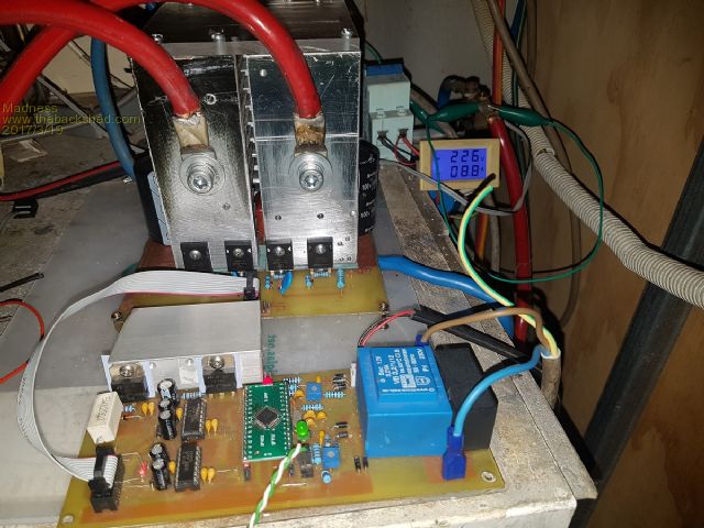

Thanks to Solar Mikes help to post the gate drive circuit here I have the best results I have got so far.
Life has got in the way the last week and finally today I got the PCB completed.
There is room for 4 extra MOSFETs but I don't think they are needed as the HY4008w's are rated at 200A. Idle power with the big Toroid is 40W, I have had it running at 5KW for about 10 minutes, I will give it a bigger load test tomorrow when the sun is out.
Here it is running at 350W running the house.

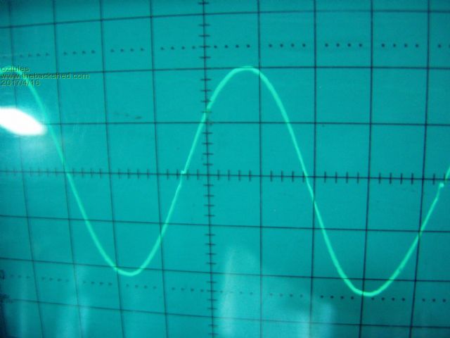

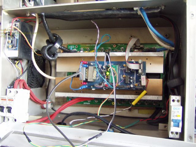

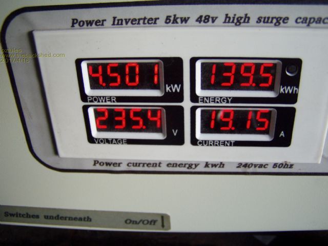

i still just don't know why... walked out to the shed, turned on the scope, the unit was doing 4-5 kw, and the wave was perfectly shaped but for a slight zero cross over on one side of the wave only.
I just cant see why yours is warped and mishapen.. danged if I can... it is annoying, as your board looks the full monty too ... very nice..
I wish I knew why.
Wave at 4-5kw ( see next pic for figures )
Curent status is:
So this one has been under test for 140kwh
Mad, this one is running 4 hy4008 on the outputs, still does the 20kw thing for the 5hp motor... so 6 is excessive for this size unit I think.
The waveform barely differs from the 6x4110's, but easier to build and cheaper on the fets too
............oztules
Edited by oztules 2017-04-17

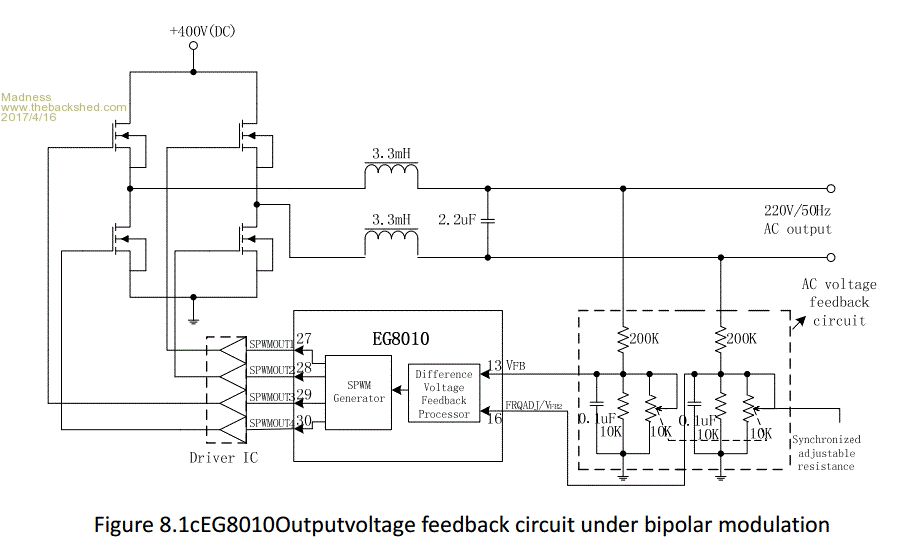

Chokes....
I am about to start winding my choke and have a question that perhaps someone can enlighten with an answer.
Why do we have a choke with a single winding on it, connected to either leg of the transformer?.
We know that at the instant of switching the mosfets, the transformer primary wants to draw an enormous short duration spike, supplied by that big bank of C's until its magnetising field builds up, the choke reduces this for a short time until it gets saturated then acts like a short piece of wire.
So what would happen if the choke was wound as per a common mode, with opposed windings, each connected to a leg of the transformer, the inductance is thus on both sides of the transformer and the current induced magnetic fields would cancel, so preventing saturation ?
Thoughts....
Mike

  Solar Mike said   Chokes....
Thoughts....
Mike
This is a complex issue, and there are several quite different problems and solutions.
As we know, PWM involves an extremely violent switching from rail to rail at a relatively high switching frequency, and what we need to do is average out these fast transitions to recover some kind of long term averaged value that hopefully comes out looking like a 50 Hz sine wave.
To do that we need a low pass filter with some energy storage capacity.
This filtering must have very low power loss at 50Hz, and have suitably high attenuation at the PWM switching frequency.
Another requirement is that the input impedance of our filter must be high enough that we do not produce very large current spikes when attempting to drive it.
A third requirement is that the output voltage stays where we want it (240v) and have fairly good voltage regulation over a wide load range, which means a low output impedance at 50 Hz.
All this is not an easy thing to achieve.
The basic building block usually starts off with a transformer, often with a fairly large step up ratio. This transformer will have some particular characteristics depending on size, method of winding, and type of core material. As a result it will have some primary leakage inductance, and a self resonant frequency, mostly due to the unavoidable inductance and capacitance of the high voltage secondary that has a great many turns.
Primary leakage inductance is what you can measure across the primary with the secondary shorted out. A perfect transformer with perfect primary to secondary coupling would look like a short at the primary, when the secondary is shorted.
A real transformer will always have "some" primary leakage inductance.
But the amount of leakage inductance is highly variable with turns ratio, physical size, method of construction and winding method.
Self resonant frequency too will be highly variable, and if its above the PWM switching frequency, the transformer primary will look like an inductor at the PWM frequency. If the transformer self resonant frequency is below the PWM frequency, the primary will look like a capacitor, even with nothing connected across the secondary.
So before we even start to look at designing out output filtering "system" we have some fairly significant unknowns about what the transformer primary is going to look like as far as being driven by the PWM power stage at the switching frequency.
If its predominantly capacitive, there are going to be some current spikes.
Even more so if there is a fairly large capacitor connected directly across the secondary winding, as there often is. Or maybe the primary leakage inductance is high enough for that not to matter ??? No way of knowing without measuring what you actually have, instead what you think you have.
Now driving a highly capacitive load at high switching frequency is really bad news, we really need for our PWM output to go into something that looks more like a buck regulator, with a series inductance, where the current ramps up and down controllably. Maybe we need to add some extra inductance to the primary, or maybe not. How much is anyones guess unless you can look at the current in the primary and know what is really happening.
The problem here is that too much inductance (or resistance) in the primary will create a power loss and degrade voltage regulation. If the necessary inductance is provided by the transformer leakage inductance, it will always be there, and will hardly change over the whole power range, because the transformer never magnetically saturates. The same may not be true of any externally added choke.
Here it starts to get really complicated, because we can add a primary inductance that deliberately saturates at very low current for a specific purpose. This adds a fair bit of inductance to greatly reduce turn on switching loss for a very short time interval when the mosfets initially turn on. This can significantly reduce the no load inverter idling current, but its tricky, because how much inductance and how quickly it saturates and at what current it saturates has to be matched to the particular switching times and what the primary looks like. All of which is highly variable.
What works in one inverter may not be optimum or work at all in another inverter, so its wide open to experimentation. But what you need is a fairly large ferrite core with high permeability, and an optimum number of turns found by experimentation. More turns are not always better. Its a case of sustaining sufficient inductance for sufficient time, and more turns will saturate sooner than less turns, but more turns would have higher initial inductance. So its cut and try, rinse, repeat...
What you end up with probably will not work for someone else.
This magic ferrite primary choke is just the icing on the cake. If your transformer has insufficient leakage inductance, your mosfets are going to have a very difficult time at high power, and a larger non saturating series inductance in the primary may be required. Just about all grid tie inverters that run at high voltage have such an iron cored monster, usually about 2mH to 3mH. But low voltage battery inverters usually do not, often the transformer itself is quite sufficient.
Old inverters with E and I transformer laminations almost always have sufficient leakage inductance, but modern toriods have much more efficient primary to secondary coupling and that high efficiency and better coupling may be creating a problem.
So in the end its difficult to know where you are, or what to do without having the equipment to look at voltage and current waveforms in the primary, and trying to make life for your mosfets as stress free as possible.

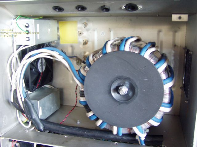

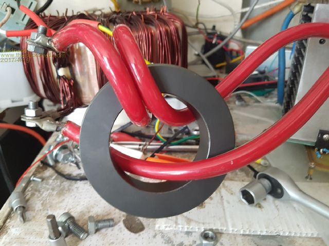

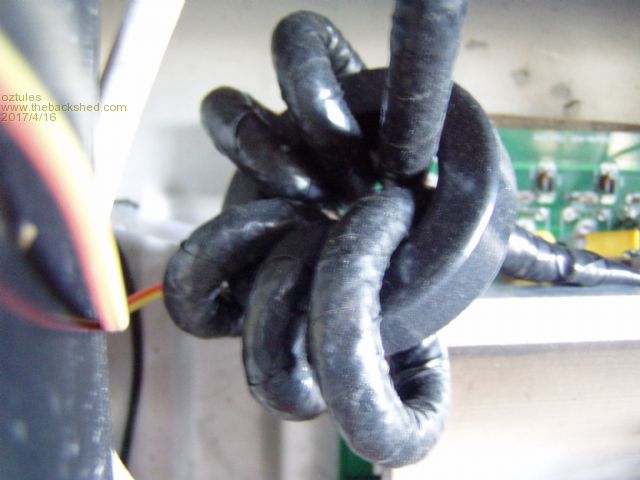

Ok Mad,
It is a torroid ( powdered iron I think ) with 6 or so turns..
pic tells it all....
Here is the set up.
........oztules

Warp, thanks for the very detailed response, I will need to read it few times to get my head around it all.
Oz, I see you don't make any special effort to wind the inductor tight or anything, maybe I am barking up the wrong tree with the inductor??????
Another thought I had after sleeping on it is to try Bipolar, I see that would involve some modification on the control board as well as per the circuit below.
Also I am thinking if a common mode ferrite ring choke would work with it.
Posted: 02:05pm 16 Apr 2017
A toroid can be as ugly as sin and it will work fine. One pass through the hole equals one turn, no matter what the wire does to get back around to the other side around the outside of the toroid. One pass = one turn even if the wire around the outside as a foot long. No need at all to wrap it tightly.

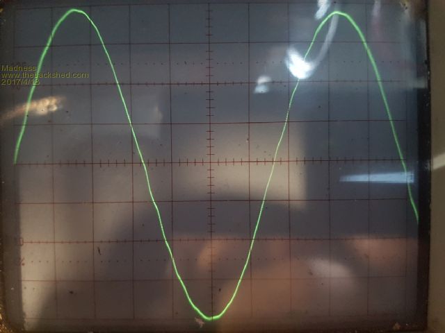

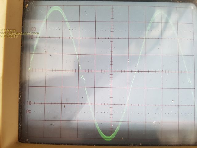

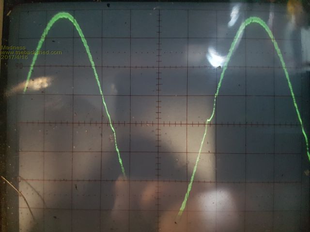

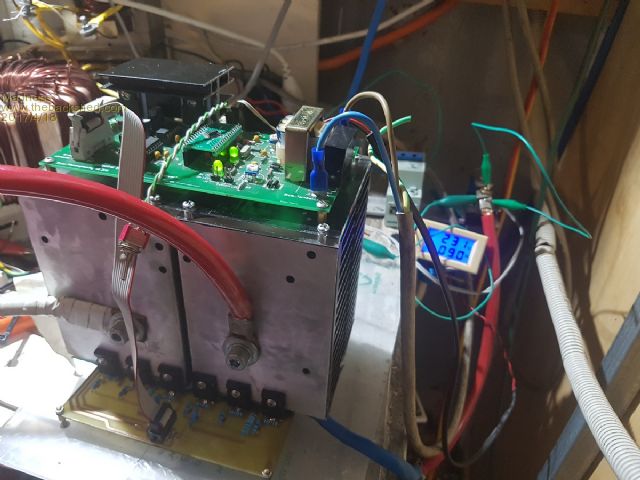

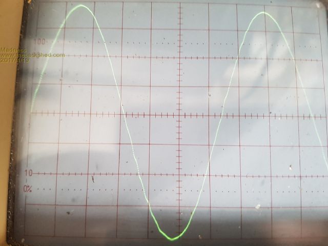

I finally made a proper heatsink for the mini Inverter shown here previously. It has 12 4110 FETs all standard Oztules circuit just minus 12 FETS and 2 caps.
It is connected to a single core toroid and a 65mm ecore choke with 3.5 turns.
Here is no load, idle current is about 20W.
And 9A @230V fan heater load, runs very cool, no fans and the heatsink just got to 10 degrees above ambient..
Only parts in common with my big inverter is the battery bank and the Oscilloscope.
I will try a few different choke setups to see if it will improve.
Edited by Madness 2017-04-19

Nice little unit.
I expect it would drive a normal house just fine.
If it does not get hot... ignore the waveform, see how it runs longer term if you can keep the house loads under say <4kw for 10 minute periods, and <2kw for most of the time. That would be most houses off grid.
Check the leg connection of the 8010 to the circuit board.... maybe intermittant fault in there somewhere when it runs for 10 days and fails.
What was the sine wave like when the heats sinks were not attatched?
........oztulesEdited by oztules 2017-04-19
Posted: 11:10am 18 Apr 2017
My plan is to put it in a single case and eventually be a backup Inverter. In the meantime, I want to see how it goes with a GTI connected.
I have not tried it with no heat sink, I did put it on one of my really big heatsinks and it performed the same, won't take much to try with no heat sink.

I have made some progress with this in a number of areas.
I changed the choke to a ferrite ring, I got the best result with 2 turns from the SPWM side of the inverter and one from the other side, Idle current went up a little to around 25 watts but the waveform is better.
No Load
Under Load
After making these changes I tried the GTI on it and it failed again so I changed the GTI main PCB and IGBT driver boards and it now works with this inverter. Then I tried it with the big inverter and it failed after only 30 seconds or so under load. Later I will transfer the Ferrite to the big Inverter and see how it behaves with the GTI.

I found what was causing the GTI to fail, the 600W UPS I had connected to my electronics in the house.
Removed it and the GTI and my big Inverter are now playing nicely together.

Gary, what dead time are you using now?
The above inductance explanation from Tony has me wondering now if making the primary with 90mm sq wire was perhaps not so good an idea. Looking up the inductance formula, the wire area does play a part here.
What primary winding wire area do you use now?
