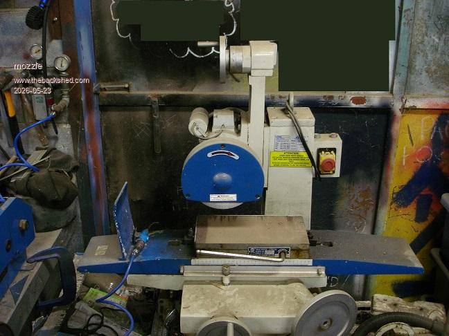

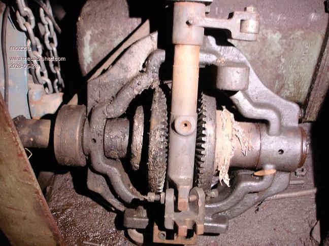

Don't want to take over Bryans thread, but now I've finally realised the old surface grinder is no longer here I should post some pics of the unit to be automated.
And this is the carriage drive out of the old surface grinder, there are two cone clutches between the bevel gears that operated the carriage left and right, and then a ratchet mechanism moved the table across the grinding wheel. Aren't we lucky we now can do this with stepper motors instead
The spindle motor is around here somewhere as well, I think thats all thats left.

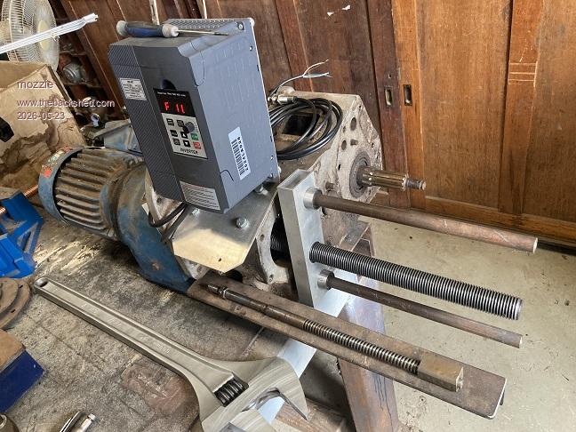

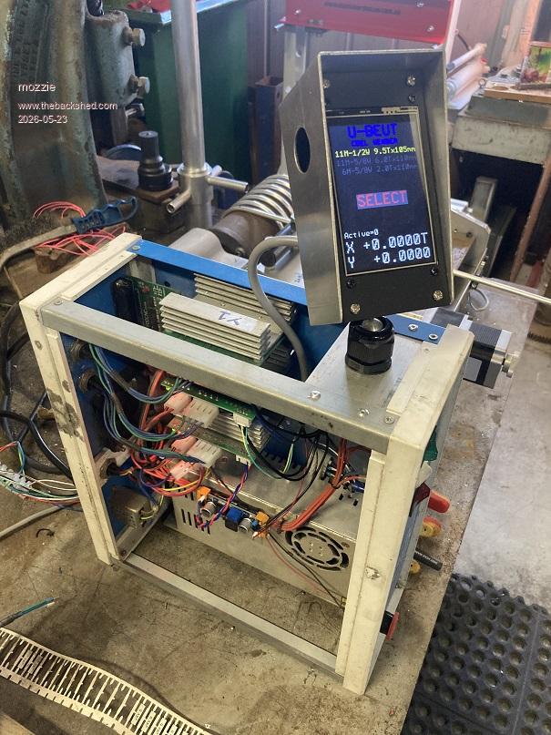

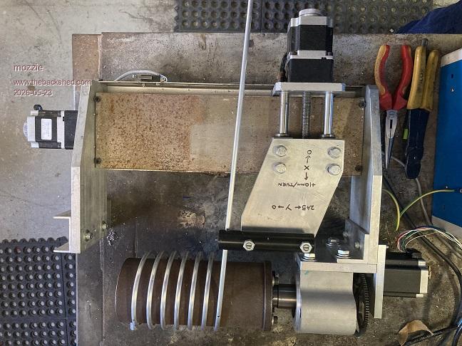

And a couple more of the coil winder machine I have mentioned a few times.
First version mechanical coil winder:
3phase motor and 90:1 gearbox, Landrover S2 transfer case + Rover V8 timing chain, M30 allthread
New MMBasic Stepper coil winder:
Y-Axis off CNC machine, Overhung load adaptor for hydraulic motor, modified S2 Landrover output shaft, gears from photocopier

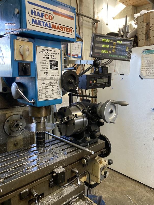

And my favourite machine, maybe PicoMite CNC one day:

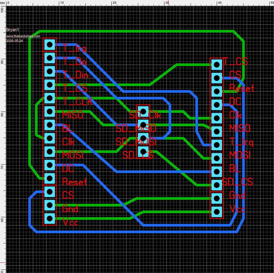

Just had a play in sprint layout and designed up the LCD Board   Got it fitting on a 50x50mm pcb so the cost maybe even cheaper
Anyway the connector on the left is for the LCD, the one in the centre for the SD_Card and the one on the right is the PCB connector so hopefully I got all the connections right and as usual the experts will find something wrong
