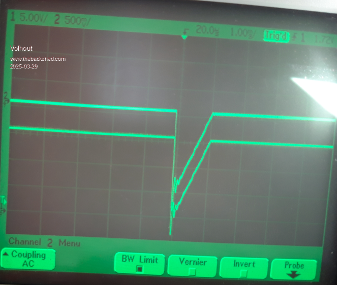

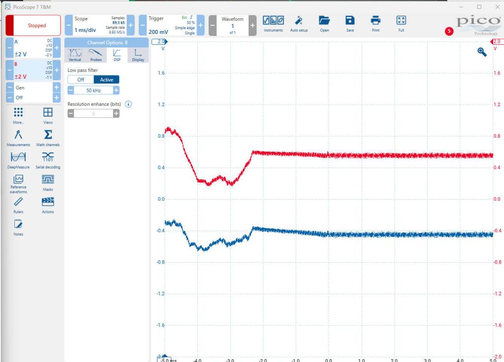

Did some more testing, playing WAV and PLAY STOP.
At roughly 15% of the cases there is a plop/glitch. And when it happens, it is (up to now) always on both channels at the same time.
This is on the last RC8 test version you released for VGA 2040 only. update:Not on the above mass release. Our posts crossed. Is there anything changed in the new RC8 mass release that makes these tests useless ?
The WAV played (Dire Straits live) starts with a low audio amplitude, so that is why it looks as if nothing is played.
Edited 2025-03-29 22:40 by Volhout

Posts: 12176
Posted: 01:05pm 29 Mar 2025
Fixed the download - sorry, and just been testing and can't break it irrespective of the direction of the taper - about 50 trials so far
play wav "future":pause rnd*10000:pin(gp0)=0:play stop:pin(gp0)=1
Edited 2025-03-29 23:12 by matherp
