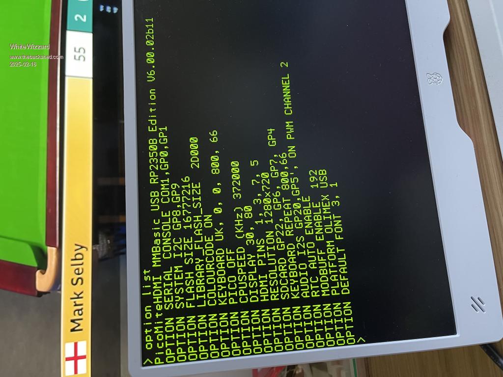

Currently working with Pimoroni Pico Plus 2 (ie RO2350B) with HDMI+USB firmware b11. This is on a OLIMEX PC board. Also have unpowered 4-way hub, RTC, I2S module, and usb-to-serial module to console in from laptop too (TeraTerm)
Hardware wise, everything is happily working as expected. Resolution is 1280.
The only thing plugged into the hub is a USB keyboard.
On power up, I see the ‘MMBasic welcome message’ on TeraTerm, but not on HDMI monitor.
QUESTION 1:  Is the welcome message meant to be on HDMI too?
About a second later (after power up) the system reports any USB devices plugged into the hub.
Channel 1 correctly shows keyboard, but channel 3 is reporting an unknown device (with pid and vid values).
QUESTION 2: I remember seeing a post about this before, but is this expected behaviour?
If I have a program running that uses a ‘large font’ (such as a large format clock on the HDMI screen), AND if I set Option Autorun On, then on power-up, I correctly see my clock (in large font), but then about a second later, I see the USB devices listed also in large font (which totally messes up the time shown on the screen).
QUESTION 3: is there a way to suppress the ‘usb device list’ so it doesn’t show at all?
Thanks in advance for any clarification…

Posts: 2998
Posted: 06:17pm 15 Feb 2025
Have a Pico Plus 2 (RP2350B) with b11  HDMI USB firmware installed. Mouse and keyboard attached to hub (and both are recognised by the Pico).
Keyboard working as it should do; but mouse doesn’t seem to be doing anything. The manual implies there is nothing else to set up for the mouse however, there is no highlighted character in the Editor as implied by the manual.
Is there anything I need to set to enable the mouse??

Posts: 2998
Posted: 08:40pm 15 Feb 2025
I am confused by some contradictions and now need clarification.
What does OPTION DEFAULT MODE do/set?
My understanding is that on power-up it will switch to this mode (with the exact pixel resolution dependent on OPTION RESOLUTION). My understanding is that this mode can be changed by using MODE x at command prompt.
What does MODE do at the command prompt?
My understanding is that this will switch to mode x until changed either at the command prompt or changed from the program (and upon exit of a program, the mode will remain as last set by the program)
What mode does the EDITor use?
You have previously mentioned it switches to mode 1 but if this is the case, why mention above that my default mode being set to 3 will mean I won’t see the mouse highlighter?
I need to ensure that I understand the above fully as  currently I am performing thorough testing which is required prior to several magazine articles I am writing in the very near future.
It is vital I get a stable hardware setup, understand any limitations (hardware and software), and am aware of any ‘gotchas’
Posts: 2998
Posted: 08:55pm 15 Feb 2025
Think I need to ask slightly differently:
With having set OPTION RESOLUTION 1280, is there anything I need to do/change/set to get to see the mouse-highlight in the editor?
