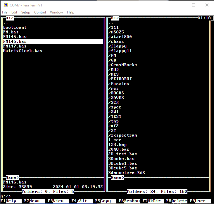

Installing the Perfect_DOS_VGA_437 font partially solves the problem of displaying the pseudographics symbols of the PicoMite encoding.

I am talking about a simple version of FM without adaptation for VT100.
For me, if I turn on the "Terminal" font in TeraTerm, everything looks like this.
Maybe it's a question of choosing the right encoding for the country, I don't know, but with the installation of a new font for DOS, it solved the problem with pseudographics for me.
My desire to make all the symbols of the PicoMite font appear the same in the Terminal on the computer.

@Vadim:
  javavi said  ... I don't know, but with the installation of a new font for DOS, it solved the problem with pseudographics for me. ...
This is what your FM145 looks like with the 437 (Perfect DOS VGA 437 Win.ttf) font:
Michael
My goal was to create a file manager for "bare" PicoMites. I believe that's been done sufficiently with the FMVT for Klingons. I don't think it's a bad idea to have an FM for VGA and one with VT100 escape codes.

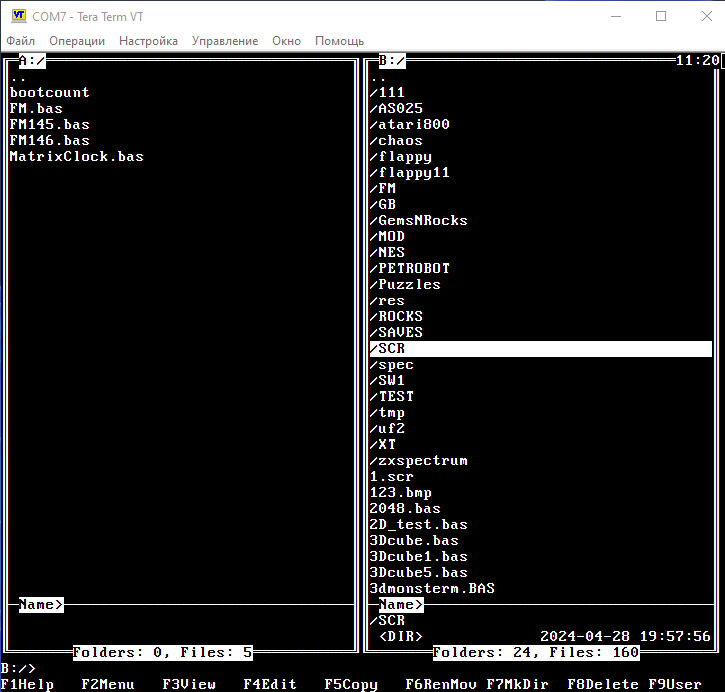

  twofingers said  This is what your FM145 looks like with the 437 (Perfect DOS VGA 437 Win.ttf) font:
For me, FM in the terminal now looks good without any adaptation for VT100! Only in black and white display on the terminal.
Another possible reason is in the terminal encoding settings.
FM147.zip
Edited 2025-04-12 22:08 by javavi

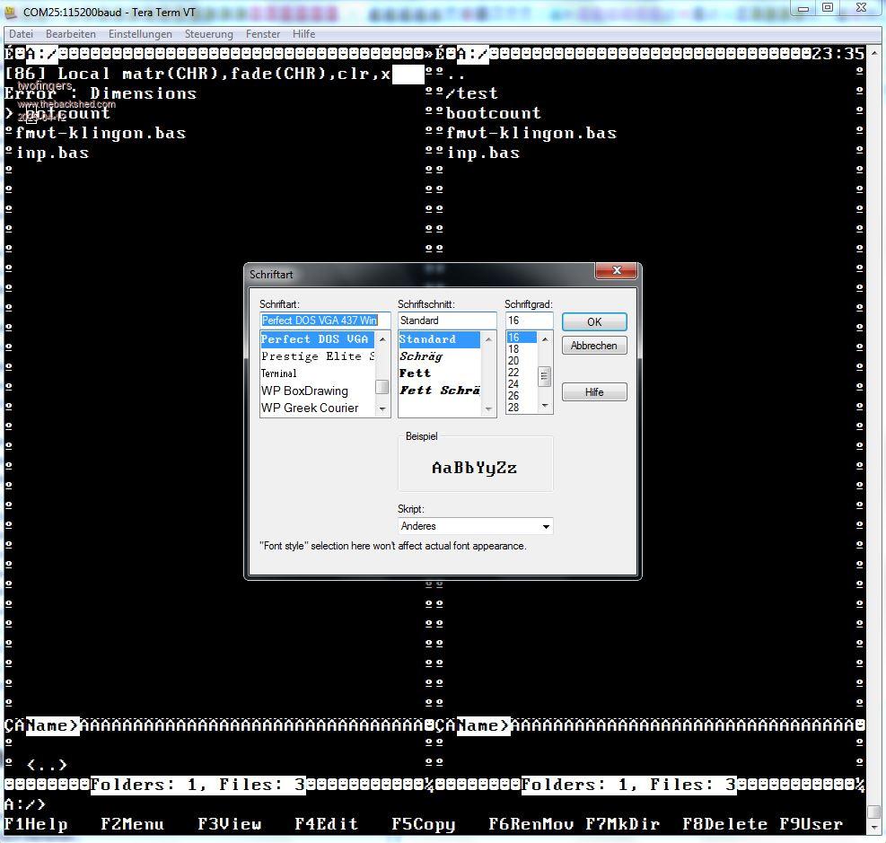

Posted: 12:35pm 12 Apr 2025
This is what your FM145 looks like at mitr with the 437 (Perfect DOS VGA 437 Win.ttf) font:
Michael
