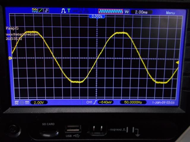

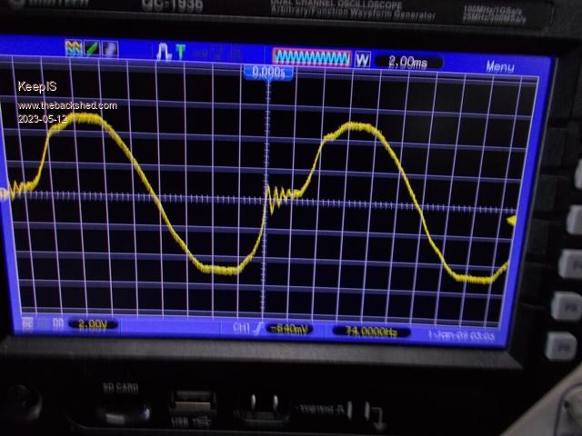

This is the waveform at 2.8kW load looks really good to me, again, for someone just reading ONE post, the flat topping is NOT the inverter.
Now that Nasty Heat gun on LOW.
It's blurred as I held  the camera with one hand and clicked as soon as I switched the heat gun through LOW to off. This is what I got.
Edited 2023-05-12 09:13 by KeepIS

Just for interest sometime try reversing the A & N to the heatgun to see what happens when you use the low setting. As the EG8010 only samples once every 360 degrees you cant know whether the inverter is regulating from the driven half wave or the idling halfwave. I am guessing it will be slightly better one way than the other.
By the way - I looked at those humungous current values you posted and I'm sorry to say you have just voided your warranty
With regard to the flat topping that is usually caused through load rectification followed by a capacitive or battery charging type load as the max energy transfer is taken near the peak, if there is no power factor correction circuitry.  Apart from that I dont know - usually our mains supply is even a bit flat topped as well...

That is correct, the Mains supply is exactly the same flat topped waveform.
I decided to let it run a bit with that waveform and it does not seem to worry it, just buzzes back at you.

Changing the A and N over at the Power lead has the same effect as changing the VFB connections over. Just moves it between leading and lagging, waveform appears to be about the same visually.
EDIT 1
Just started the Dust Extractor 520A, sine wave lost it's flat top, did not distort, or ripple, just looked like a normal sinewave as it powered up that load for 2.5 seconds, unless you were sitting in front of the inverter you would have heard nothing, it was virtually silent but for the faintest of a hum sound.
