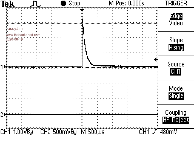

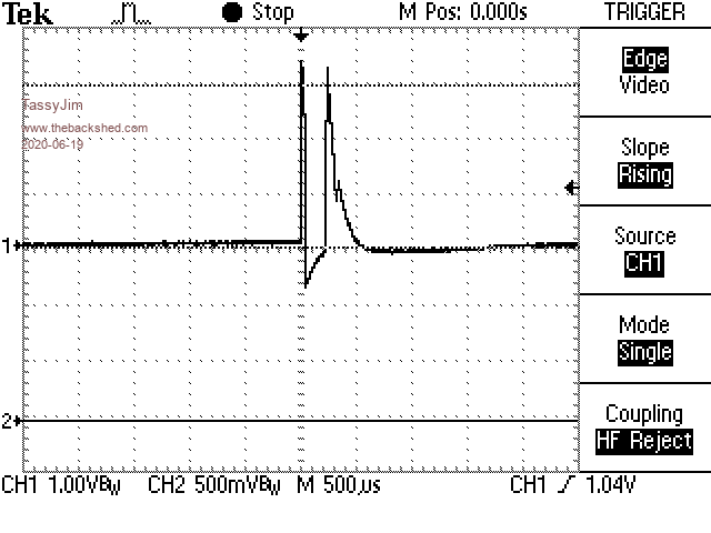

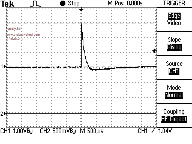

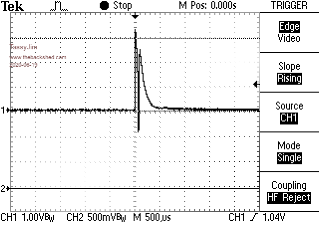

To test the CMM2s long line capabilities, I add extra capacitance to the pin 40 and turned on.
First with 250mm IDE ribbon cable into a breadboard:
Next as above plus 39pF
Next as above but 0.01uF
Finally 0.22uF
The ringing is most likely the switch bouncing. It occurred with all capacitors and only some times.
In all cases, the spike in voltage on the pin was fully ended in 500uS
The startup sequence now checks 3 times at 100mS intervals so I don't think long lead capacitance is going to cause any problems.
