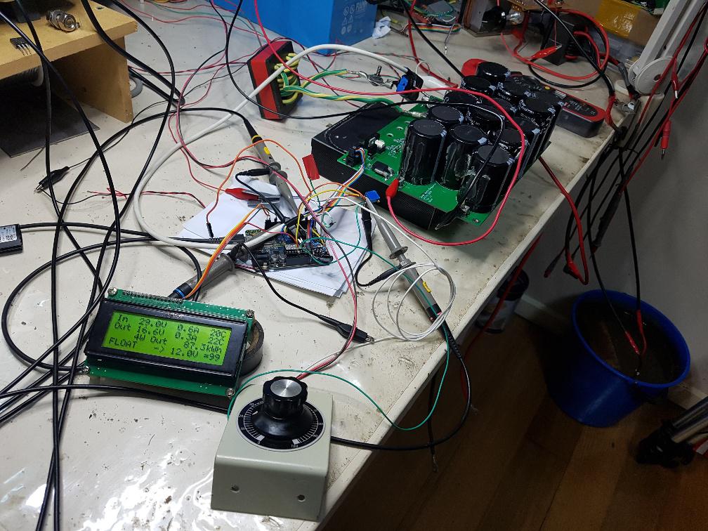

Here is the prototype with the fast over current protection, manual battery voltage
simulator (the potentiometer I drive to test the 4 state changes) and everything.
From such humble stuff a decent charge controller will be born.
You can see The Blue Bucket Of Resistance, the Arduino Uno and DSO probes and everything.

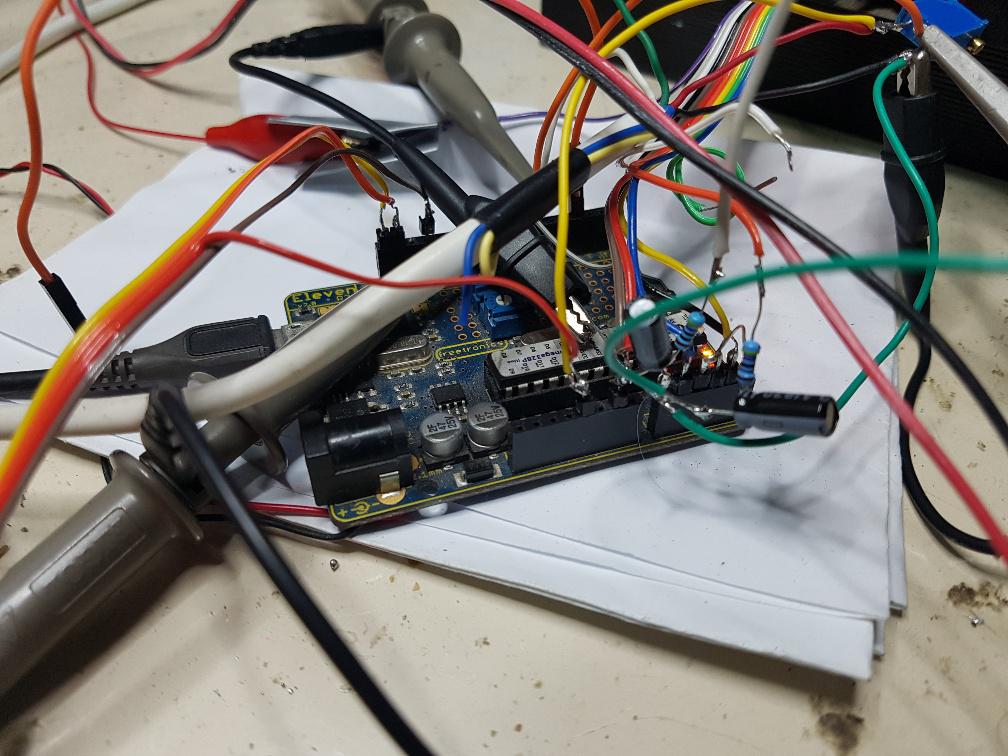

A close up of the Uno. Note that the Nano offers even more inputs useful for this project and that is why I use the Nano for the final brainboard. I just happen to have a Uno lying around..

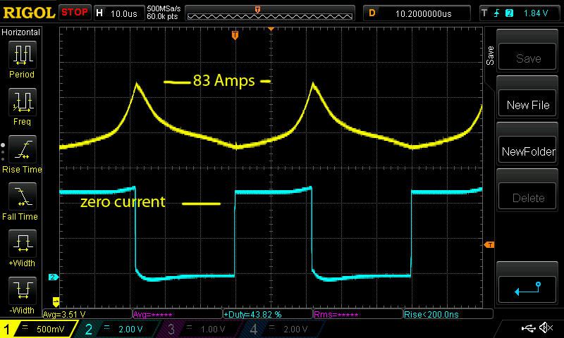

Why? I have a current sensor on the inductor now that can go up to 122A before
it clips the output. Before in an earlier post I showed the 49uH 1mm gapped inductor clearly saturated at high outputs with 100V input voltage.
Here is exactly how high the current gets.
Vin = 108V
Pout = 2000W
This is not as bad as I thought.
Peak current is about 83 Amps and this current is switched by the 2 MOSFETS.

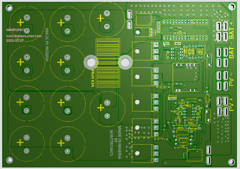

Hi Peter, i've been following this topic as its progressing.
Though I was working on a similar project before i joined, all thanks to everyone who has contributed to this.
I've done some pcb on proteus.
I added an smps that can handle 120vdc without frying the chips.
