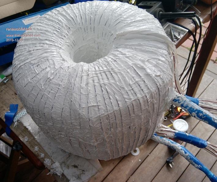

OK torroid all done.

The third winding had to be done with a small solder spool.
Fourth one couldn't even be done with a spool, it had to go back on with a shuttle.
Very time consuming to get each turn on loosely, then hand smooth the wire and then pull it tight, then try and keep it tight while the next turn goes on, do that 128 times and it gets pretty tedious.
Fourth wind went around the core two times with a poly and mylar layer between which added time.
So this was a very time consuming transformer to make, reckon I could have done four normal ones in the same time. Hope it works well

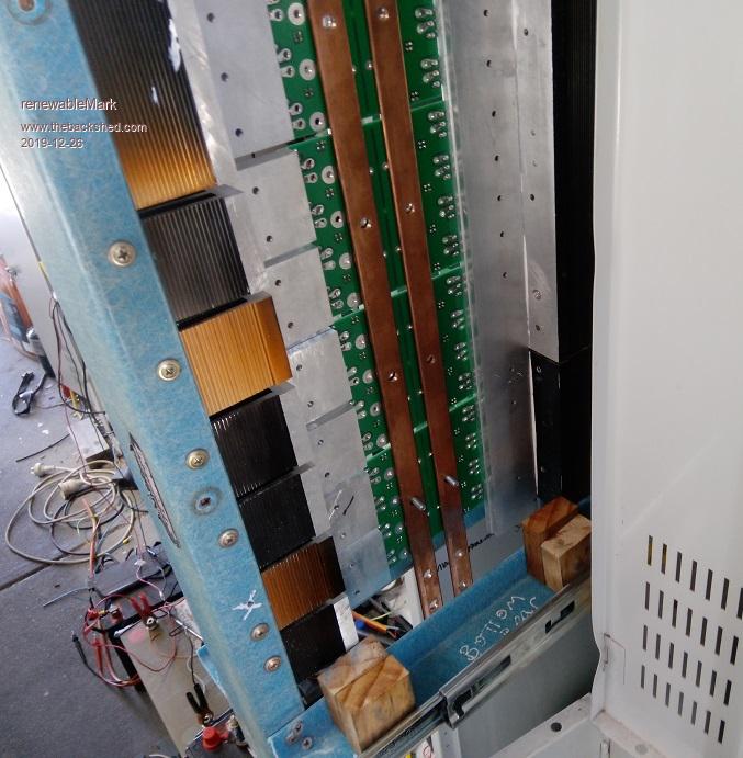

OK got some time up my sleeve now.

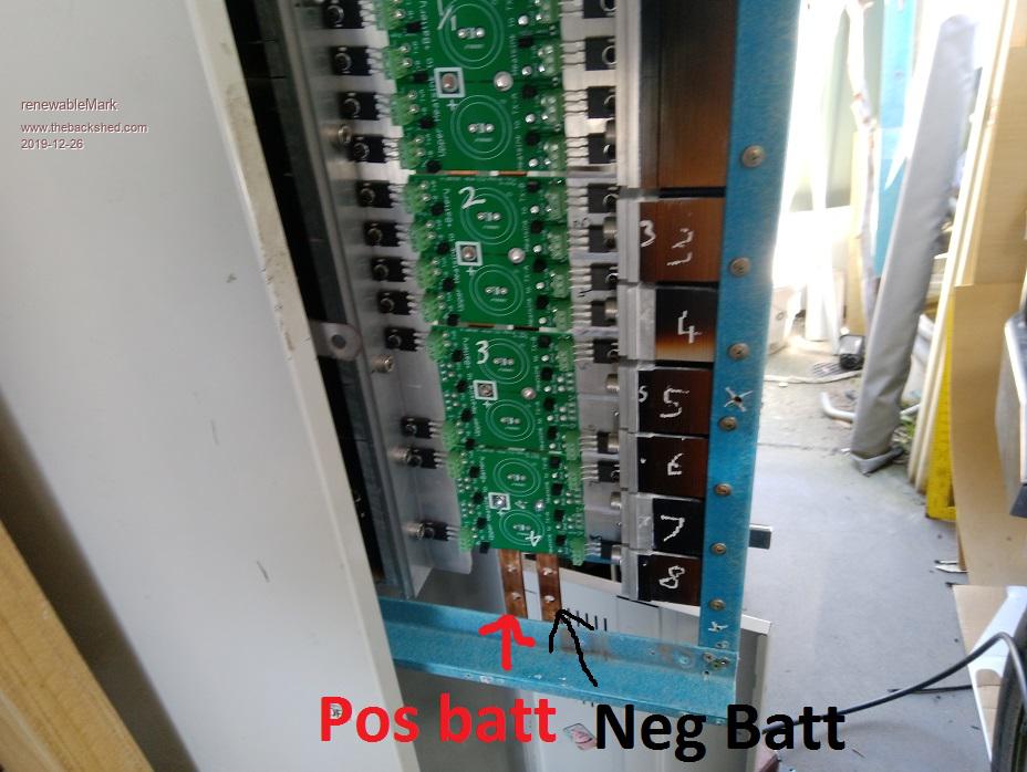

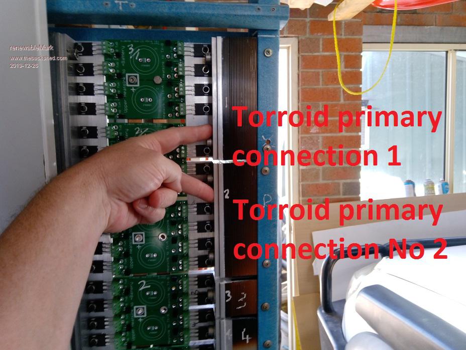

Just want to make sure of the connections before I start cutting cables.
So at the back will be these bus bars, caps will be fitted after testing.
Bus bar battery input connections here.
And then the primary connections from the torroid go to the two halves of the heatsinks on the right side.

Posted: 03:50am 26 Dec 2019
Gosh, that is a real work of art Mark far too good to use as an inverter.

Very nice I like how you encapsulated your toroid also

Thanks guys, not far to go yet.
We'll be able to see if that spaced torroid with the primary on first makes a difference.

Looks Good Mark
The connections you indicated are correct.

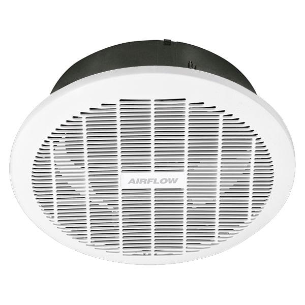

A lower cost alternative might be an ordinary ceiling exhaust fan to blow some cold air into the lower half of your locker and stir things up a bit, combined with one or more strategic holes at the back to let the hot air out ? Bunnings have such a beast for about thirty bux.
It may be a bit noisy, especially when bolted to thin sheet metal, but I doubt if its ever going to come on. Not familiar with those tall tower fans which may be better anyway.
If you want to make some nice clean perfectly round three inch ventilation holes in your locker, I have a three inch sheet metal punch.

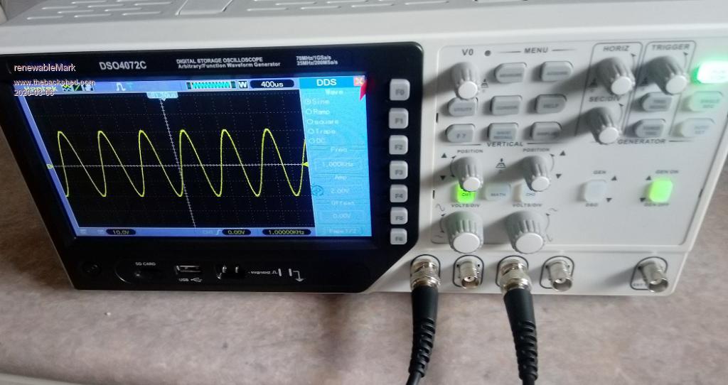

Got the new scope, it has in built sig gen.
Have to work out how to use a digital one now.

4 channels is good.
This will be a great tool to have and will help you get a good understanding of things inverter related. And other things too, ya never know.
You have 4 inverters, so you can check out the low side gate drive output, all referenced to DC ground.
This will show the 4 different PWM drive forms.
Take care when checking out the high side drive outputs. All 4 require different "earths" and all 4 are not and never will be DC ground.
But.
But you can still see them, just accept the zero for each of the 4 high sides
need to be subtracted from DC supply to see the actual high side gate drives.
So that's the gate drives. It's much better to check out the outputs of the controller board between the eprom and the gate drive chips. All of that will be relative to DC ground.
Take some care when attaching those alligator clips is all I am saying.
Every one of the 4 channel's earth alligator clips are connected to the mains earth.
One channel can not be used as isolated compared to the other 3.
All shared the same ground. (check with the multimeter, touch all BNC connectors and see)

Poida, it's a 2ch the left 2 are gen output and sync trig.
I only need 1 channel to look at, that's enough to confuse me.
This is what I got

That is very good value, it has a lot of features that will probably take a fair while to become truly familiar with.
I have had my new CRO for a couple of months and have barely scratched the surface of what it can do. To be completely honest its all a bit daunting.
