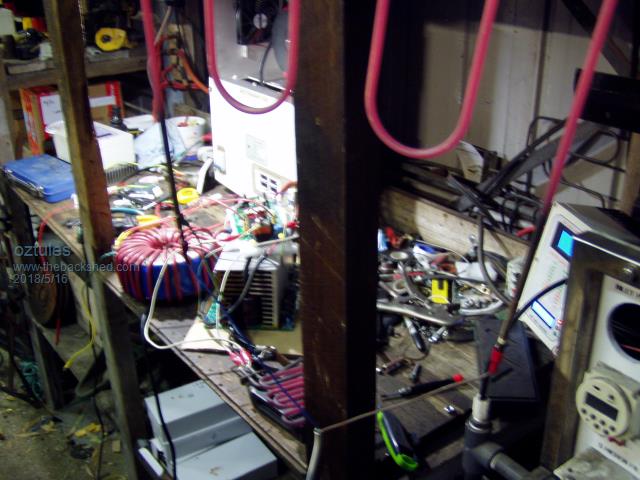

Actually, I am with ryanm on this, when making the boards up, I felt that there was only just enough pad showing to get a bit of heat into the pad to melt the solder...
I settled for heating the legs, and using the fact that there is good through plating, to heat the center of the hole up with the component leg, that then heated the pad ring enough to run the solder... so changed techniques.
I would have preferred a bit more real estate, but that said, it was not a show stopper by any means.
Ok Marks ,machine.

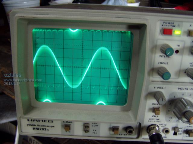

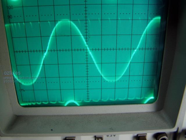

All up and running happily for long periods at 4kw or so, reset, and restart under full loading, no problem... very very quiet at 2kw for some reason, still very quite at 3kw, and not much noisier at 4kw and more.
Have not tried the high current bursts, as only 2 fets in 2 legs at the moment, and they stay pretty cool, it's the tranny that gets hot, it is only single core with 25mmsq wire.

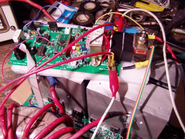

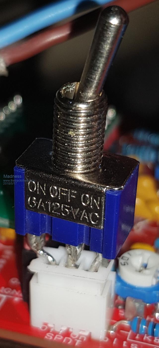

There is some sensitivity which I alluded to years or so ago, regarding the pin6. If you use big switches with long wire... there is a likelyhood that it will trigger oddly under high power, the faulty switch ( thing that introduced inconsistency, if not faulty) was replicated when I replaced it with a like sized switch. I use very small ones in my inverters, maybe why I have not seen this behavior...
So beware, if your unit turns itself on and off... fair chance it is your on off switch circuitry.
Yes, Mark, noticed the brushing, it helped show up the small voids around some of the legs.
Tomorrow will test out the start up characteristics, but the little tranny will limit us.
May send it back Friday or Monday if it continues to perform nicely.
pics.....
Here we can see the new switch.... glued to the caps... but no longer used... started to pulse at 4kw..... notice the jumper lead across the pins instead.
Here is a crappy pic, but shows both the 10amp grill and the 8amp element running together, and did so for 20 mins or more... but at nightime thats not terribly smart.
So I think we are pretty much there. bit more testing to go.
........oztules

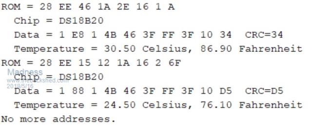

I had some real fun today tried the Nano in the control board and nothing, the 12V was shorted. After removing diodes etc on the positive rail the only thing left was the socket for the Nano which was a major PITA to remove. Turned out there was a fine strand of wire between the VIN & GND pins under the socket. I wasted over 2 hours, lucky it was there, could have been somewhere else and even harder to diagnose.
Would have liked to have gotten further with the code but here is what I have so far. It will run the fans and display but that's all at this stage. First off you need to find the address of the Digital temperature sensors with this code.

Upload this to the arduino and open the serial monitor under tools in the Arduino Software. If you hold one of the sensors you will see the temperature increase so you can identify which is which.
This then is entered in the actual code as per below.
DeviceAddress Probe01 = { 0x28, 0xEE, 0x46, 0x1A, 0x2E, 0x16, 0x01, 0x0A };
DeviceAddress Probe02 = { 0x28, 0xEE, 0x15, 0x12, 0x1A, 0x16, 0x02, 0x6F };
Probe01 is for the heatsink and Probe02 is for the transformer.

Well it looks like the mystery has been solved in this case.
With the large heat sinks radiating into space, and no close decoupling on the +5v, we seem to be getting too much noise into the switch circuit.
So I put two decoupling caps across the gnd and +5v pins of the switch socket, and shorted the 1k to ground.
This then seemed to calm things right down, even using the large switches, that would have attracted the most noise.
My board has direct line to pin 6 from above the board, and that seems to have saved me the ignominy of unforced shutdown at high power.
So it looks like this thing is going back home soon.
Was happily doing it's 4.5kw this morning . running around 90 amps.... and only 2 fets in 2 bridges..... these HY4008 are amazing things.... cheap Chinese chips be damned, these things are gold.
......oztules

Now for a few pics of wave form....
This is with 2 turns through the torroid ... so there are wave forms everywhere, and no filtering from the caps on the output, this is the raw data in the core....
So beware, there will be waveforms from the 50hzsquare, the spwm, the sum and the difference of all sorts of stuff... but the main fundamental is the sine wave, here it is at 2.5kw.. not too shabby considering no filter of anysort, just raw magnetics.
Note the other waves in there, some you may recognize too.
And this is in the 4.5kw range. Considering all the poor connections. I am surprised it is this good. Very surprised in fact.
I think thats pretty good . Filters will change things for the better, but the raw data is in the core....You get to see all the waveforms in there, just fiddle the CRO, and you get the whole gammit of stuff.... pretty interesting really.
..........oztules

I made up this switch for testing before the long lead issue was discovered. Main reason was I figured it was better than having it hanging off the end of the wires and the potential to short something. It is the wrong type off switch though with the centre off position, I have the right ones coming.
