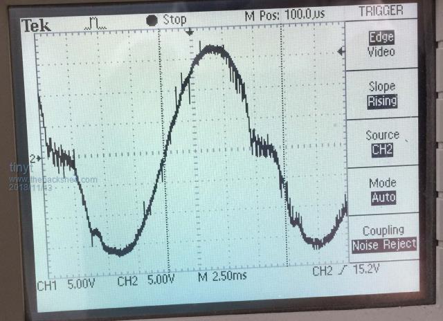

I modified the EGS002 to operate in bipolar mode (EG8010 chip pin 20 to +5vdc). The sinewave is ugly:
Looks like the EGS002 is not designed for it, maybe its cross-conduction transistors were messing it up. I don't know if anybody tried bipolar with the EG8010 pcb.

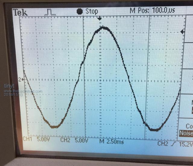

Went back to unipolar and re-scoped:
And kept staring at it until I became cross-eyed. Then it hit me that the non-symmetry could be causing flux walking especially when I was testing a toroid core rated for 2.5kw at over its rating. Maybe the overload for an extended period of time is exacerbating it. I don't know, I know nothing about magnetics.
So now I am abandoning the EGS002 and EG8010 and will be going the arduino way. Hopefully, I can understand what the experts like poida, gaspo, wiseguy and others are talking about.Edited by tinyt 2018-11-14

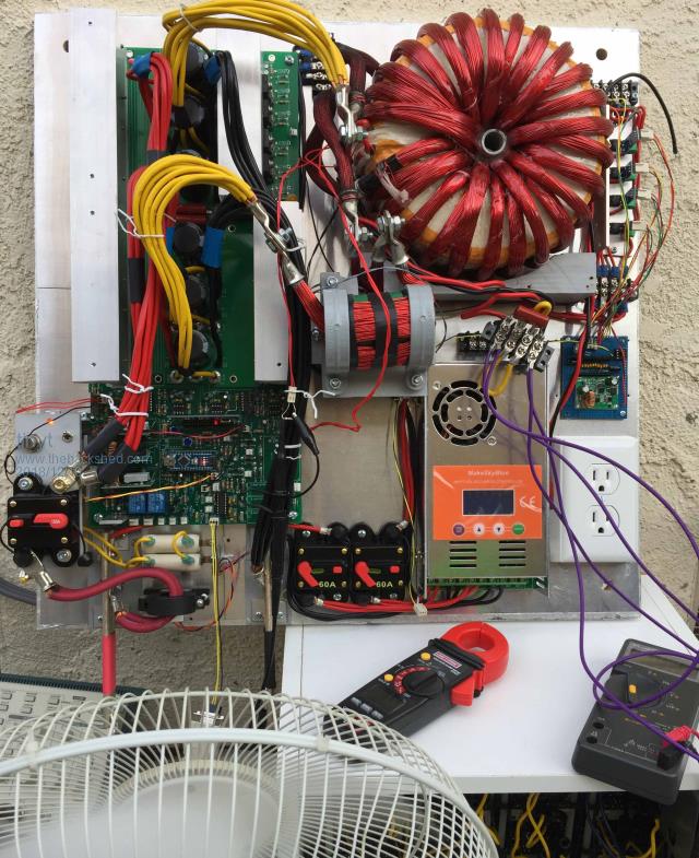

After a one month hiatus, my wife has started to ask about progress of this project. So I did some testing and found out that one of the IR2010 SPWM output starts at slightly low voltage from zero crossing and then flattens out to normal for the rest of the half sine. I replaced it and now the kink in the waveform is no longer discernible. This is with 3.4kw load.
So, I continued testing this EGS002 inverter with the existing toroid.

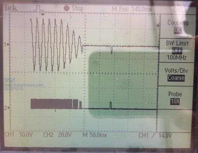

First I setup for two 2.2kw stove heating elements in parallel for load, It runs for about 30 seconds and then shuts down with under voltage LED flashing. Note that the EGS002 is not being fed by IFB. I scoped the AC output prior to shutdown together with the SPWM and set the scope time base to 50 ms.
Top trace is AC output, bottom trace is SPWM. Note that the AC ouput starts to drop but the SPWM is still maintained for about 90 milliseconds, and then shuts off after about 100 milliseconds. I think that blip after shutdown was also noticed by wiseguy.
Here are values before the shutdown:
Input DCV: 54.3V
Input Amps: 90.7A

Here is a picture of my testing.
EI choke was only warm to the touch. Also, for this size inverter, I think a fabricated heatsink is adequate. I am now happy with my testing and will complete the assembly.Edited by tinyt 2018-12-11

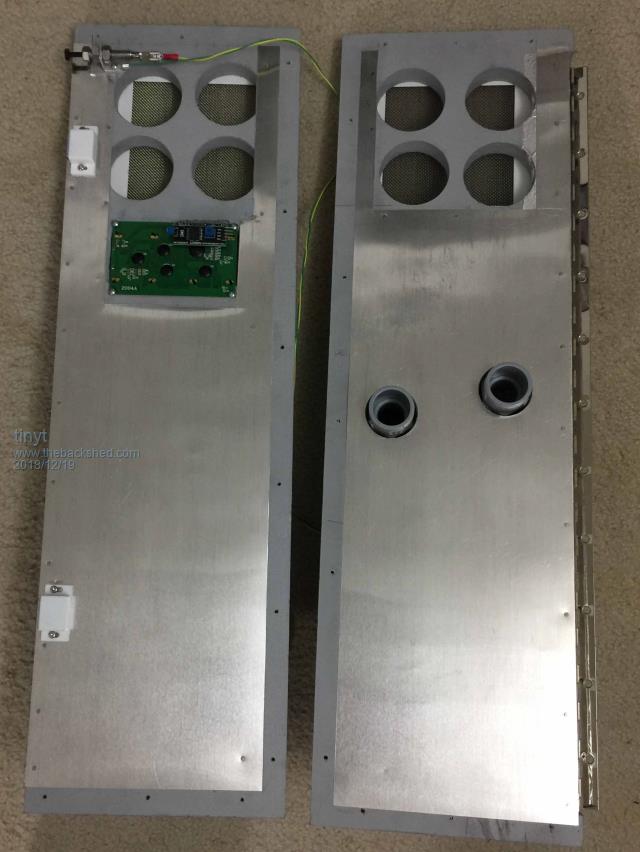

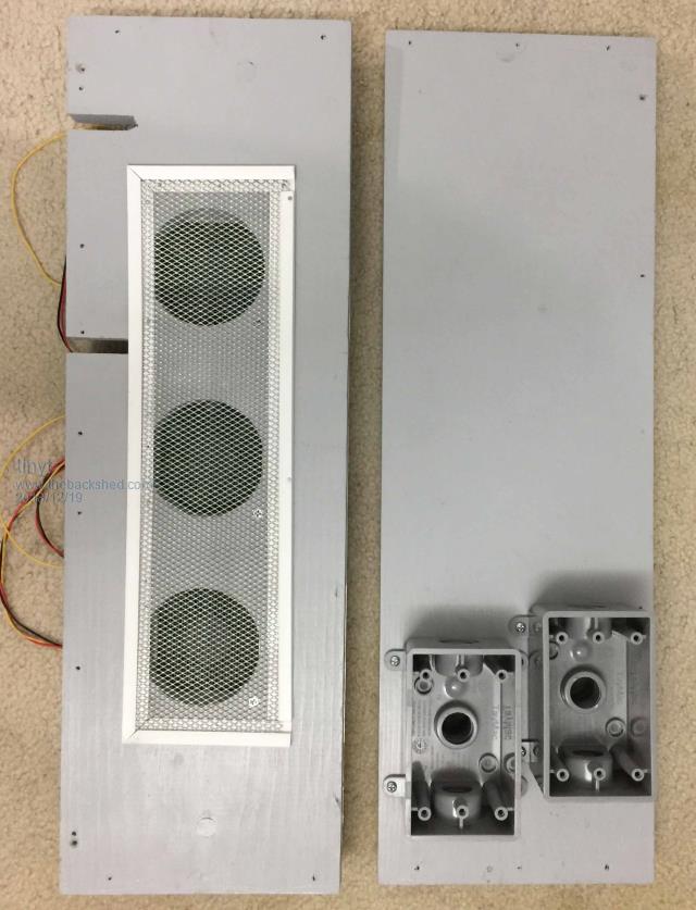

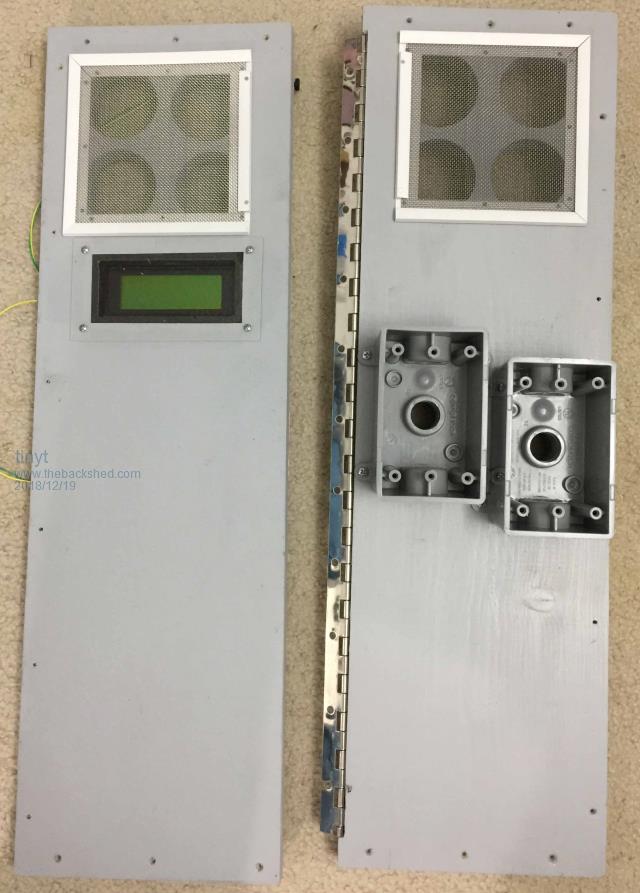

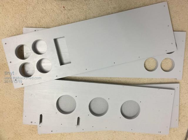

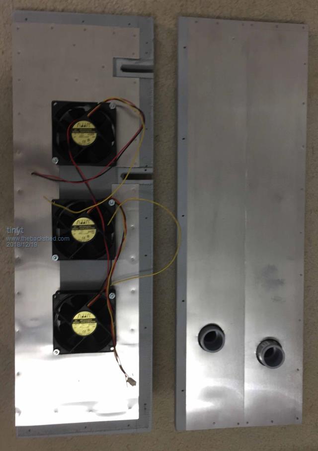

OK, started to complete the enclosure assembly. Here are the side panels. They are made from pre-painted pine wood about 19 mm thick.
Here are the inside surface views of the bottom and top panels showing the aluminum sheets. The sheet are glued with contact cement and then nailed with wire brads.
Here are the outside surface views of the bottom and top panels. The bottom has a screen to prevent insects from entering. The top has utility boxes to feed in the solar array wires. The second box is for future install of a second solar array. The bottom panel is closer to the camera, making it look longer than the other one.
Here are the inside surface views of the left and right panels. The white rectangular things are magnetic latches to hold the cover closed. There is a spring return switch (automotive hood/door switch) which will be used to switch on/off +5v to the LCD display so that the display gets power only if the enclosure cover is open.
Here are the outside surface views of the left and right panels. The LCD opening has a clear acrylic sheet cover. The black border framing the LCD display border is just paint. Utility boxes are for load wiring.
I am still working on the cover which is made of plywood with hardwood border. It will also have aluminum sheet on the inside surface and will be attached to the right panel using piano hinge.

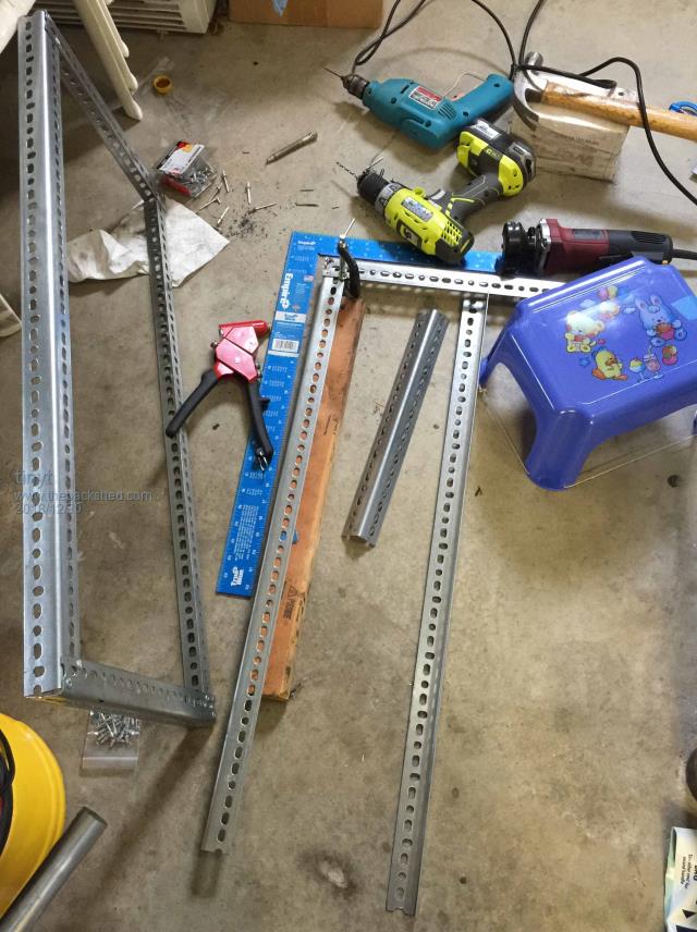

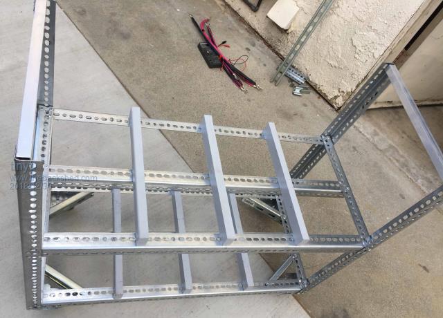

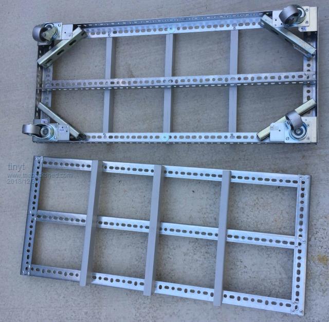

Update, fabricated the battery rack.
Materials used:
1. Zinc plated steel slotted angle bar, 38 mm x 38 mm x 1.2 mm thick
2. Pop rivets
3. Steel wheel casters
4. Simpson Strong-Tie 18-Gauge Galvanized Steel Angle (for caster mounting)
5. Pre-painted pine wood 19 mm x 38 mm cross section (for battery spacer)
6. Scrap pieces of steel strut channels (for caster mounting stiffener)
7. Scrap aluminum square tubing, 19 mm ( for rack handles)
I hope it is strong enough to support the battery weight,Edited by tinyt 2018-12-31
