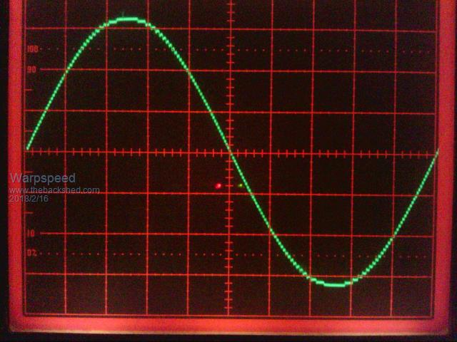

For those not familiar with multistep inverters, this is a picture I took about a month ago when I was playing around with my new document camera. There are 81 steps peak to peak and this was taken by poking a 1000:1 CRO probe into the mains active (100v/div on screen).

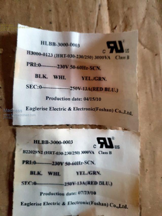

Tony, below is a picture of the label affixed to the outer side of my 3KW Aerosharp toroids. All three I rewound had a similar label on them.

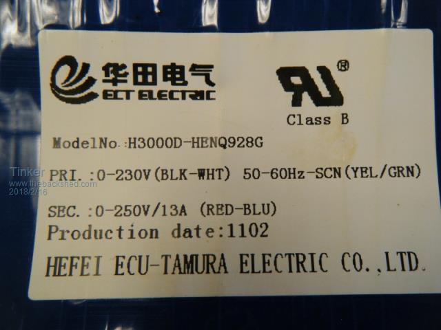

This is one type that I used.

Mine was the same as Mad's one.

O/k thanks guys, seeing is believing !
It looks like a rewind job then, which should not be too difficult.
It also means that it does not really matter which winding is inside or outside as both will have very nearly the same number of turns anyway.
