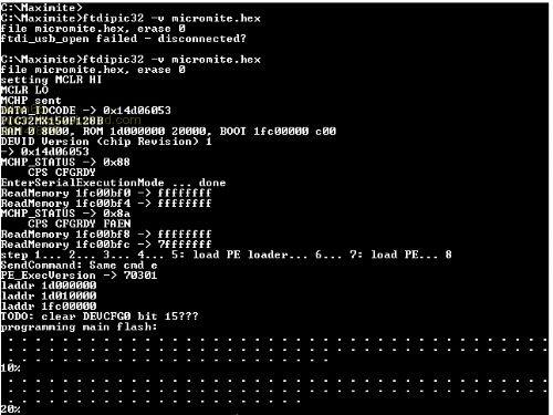

I'm for sure not doing it to save 20$ (and anyway I already have a PICkit3), it just seemed a challenge.
BTW, I put the full table of PIC32s and both variants of the PE in so it "should" program any PIC32 (incl. 170).
It would be very easy to add more PE kinds and by all means a few more pins such as for fast RS232 and thus speed it up a lot. I'm quite happy with the idea that anyone makes changes and time willing will try to help.
MOBI's version will run lots faster than mine now does.
It just seems like being "self supporting" is the way to go. As well as "fun" (by which I may mean "weird").
Posted: 05:26am 14 Aug 2014
Testers wanted please!
I'm expecting for Windows (I tried Win7) so here's a ZIP with an EXE and howto (but I can provide a Linux one if wanted).
It'd be wise to have a PICkit 2 or 3 in case this doesn't work but has erased your PIC32.
You need a suitable FTDI board. I've tested using one of these FT232RL
edit: Be sure to set it for 3V3 not 5V :)
So here's the file 2014-08-14_152431_ftdipic32.zip
JohnEdited by JohnS 2014-08-15

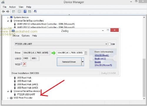

OK I keep getting
FTDI_USB_OPEN Failed - disconnected errors.
I suspect it is something to do with Zdiag.. I am not sure what I am supposed to put in the box.. it doesnt have anything detected in the pull down selection when zdiag runs..
I tried creating my own device and added the PID VID in the USB ID box but Zdiag fails when I click install.

I played around a bit more and `installed' a winUSB driver. now the FT chip appears as a FT232R USB UART (no port No as before)... Ok I try to do a program and this is the error I now get.
PS I will pack it up for now I am obviously too dumb to do this.

Hi Mick,
try connecting PGD to RSD
I'm also using windows 8.1
I got the same error, it now works
Edited by Alan68 2014-08-16

Yes that is what I have it connected to.. I suspect that my problem is either my CPU speed is too fast (i7 4770) or it is my FT232RL module. I might give it a go on my laptop, although that is an i7 as well.
As per an earlier discussion on TBS I suspect (read that as 99% certain) that my Chinese module uses a fake FTDI chip so that could also be the problem.. the only guaranteed FTDi module I have is the one I got from WhiteWizard but it doesnt have the required pins going out, not that that would stop me but it isnt my preferred option.
Did you have to set the device type first? If so what is the string it expects for device type?

Hi Mick,
I'm using a cheap red module from China.
I was using my fast AMD Win 8.1 laptop, but I need it for work.
I now have it working on my old laptop a Centrino Win7.
It programs at the same speed, very slow.
I set the device up as JohnS explained.

BTW, it runs a bit faster without -v (verify) but mine failed to flash without logging an error a couple of times (no idea why, unless it's the wiggly wires I'm using). I resorted to -v and then -R (resume) and all was well.
I'll clean up the code and see about posting it. I ended up building the Windows EXE using MinGW (32-bit) cross-compiling on (i.e. hosted on) Linux. Didn't need to change any code at all, it just compiled, linked to an EXE and that EXE runs fine.
JohnEdited by JohnS 2014-08-16

Bottom line is a cheap USB-ttl adapter (which is needed to talk to the uMite anyway) plus 5 wires and an hour or so and its done.

(When I say it's SLOW... I mean S-L-O-W.)
It's fine to kill it any time and restart, though another erase might be a good idea.
Looks like worst case to undo the driver tweak you can follow this
Which basically removes what was added so Windows can go back where it was.
I'm wondering about putting my code into a umite i.e. making a HEX file that can be flashed into a umite (slowly, if it's done this way) and then the umite can be used as the programmer from then on. I'd rather MOBI's code be used, though, as that way MMBasic can be used to flash PIC32s, even if the very first board a new user creates uses my slow stuff.

Posted: 01:27am 15 Aug 2014
10 hrs - aargh :(
It was a lot less for me on Linux. More like 3 hrs.
Anyone else with a time please?
(I suppose even 10 hrs is bearable if you've no PICkit2/3 but it's dire.)
The slowness is a combination of:
1. using USB packets, 1 packet per tiny transition on PGD / PGC etc
2. needing to turn PGD around (from In to Out and back) all the time
3. the OS slowness - Windows seems to be about a third of the speed of Linux
This makes me want to program the bare minimum (a 1K bootloader or whatever) then with more connections blast the rest down.
Currently there's a tiny PE loader then the bigger PE. Both of those need a staggering number of ICSP transactions, with endless USB packets.
I'm not sure what Mchp say about pullups except I think they say not to. Something like 4K probably won't hurt any silicon and can't possibly do anything worse than stop the app from working - which is no big deal at all.
I did have to set my FT232 board for 3V3, of course. Never tried (fried?) it at 5V.
