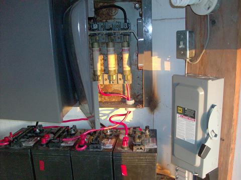

Thought I'd post a picture of the wireing out in the mill base.
(The wireing so far that is)
Both positive leads are routed through 100 amp fusetrons. The ground is not fused.
The box on the far right of the picture is 240 volt AC, 50 amp. and will be used as a service for battery chargers, lights, welder plugin access, ect.
If anyone can see something not correct, or a better / safer way to wire this, then please speek up.

idwatt
Posts: 5
Posted: 01:34am 25 Nov 2011
Well i hate to appear picky mate but you did ask
Speek is not correct "speak" is and your sign off sounds very security conscious "reguard" - a simple regards would be fine.

I would not have a clue as to how to advise you on the technical side mac46, or wiring, but I remain transfixed as ever at beholding your awesome mill.

Your wiring ect,is very neat and orderly,it could even be said your in the pink!Cheers Rastus

Thank you for the compliment, I'm not sure how well this will work...with some of the batteries out in the mill and some in the house, but I think it'll work. In time I'll add more batteries in the house to help with where the load is, and hopefully the batteries in the mill will catch up to them and balance everything out. I don't think I'll be haveing to much of a draw on them for any length of time. I've purchased a 2000 wt. inverter, (12 volt to 120 volt), and plan on purchaseing a much smaller one to be used when only very light loads are needed. Also, I'll be setting things up to use 12 volt lighting directly in a few spots around the house.
