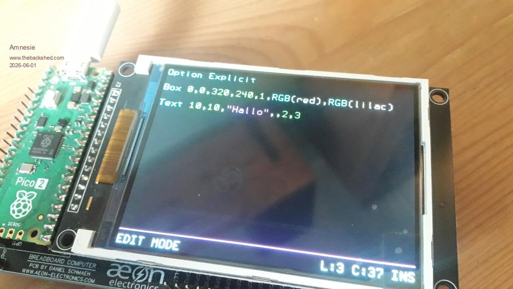

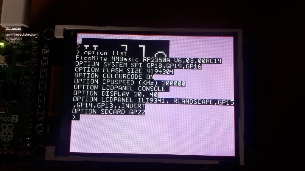

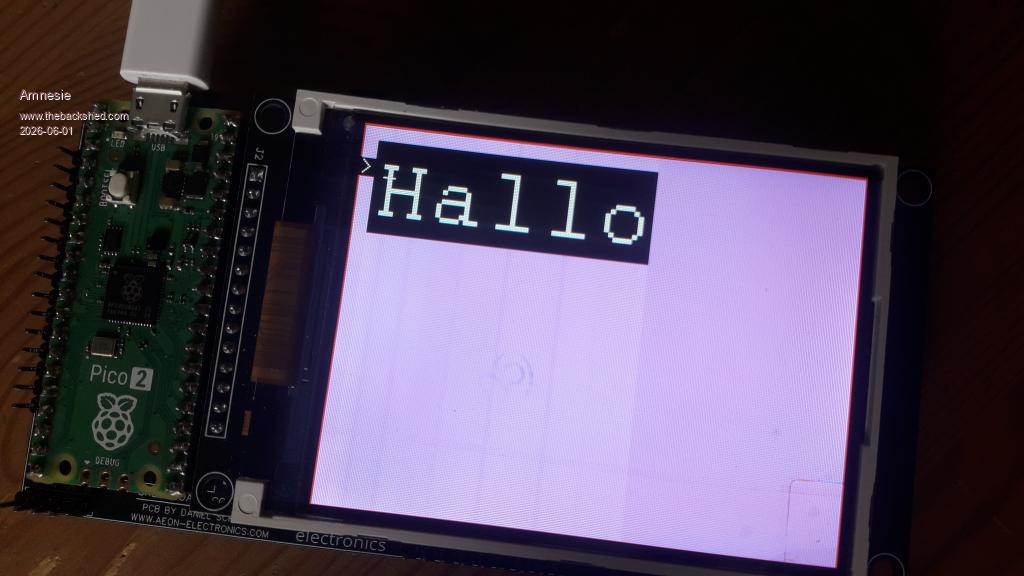

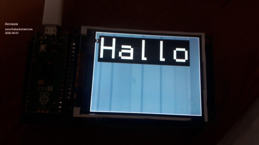

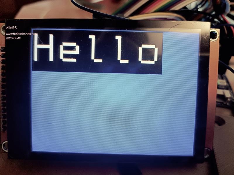

there are some problems with the ILI9341 display when using "Text" command. On some colours it is less visable (like for example blue background), but with "lilac" and some others it is really annoying. I have tested a few ILI9341 displays, also different sizes; all the same problems.

  Mixtel90 said  I don't think it's anything to do with the signal from the Pico as the text appears to be clear enough from your pictures, without tearing. The ILI9341 driver has been in use for quite some time now so I doubt if it's related to that.
I suspect power supply problems. How is the backlight being powered? That can be quite some load.
You might get something like this from a GND connection to the display that's got too high an impedance from the incoming GND.
I don't know your hardware, but try 10uF, 1uF and 100nF in parallel directly on the supply pins of the display, and possibly a wire link between the display GND and the closest GND pin to the incoming supply to reduce the impedance.
Or, of course, you might be being supplied with low-spec displays.  :(
No, none of that leads to this problem. I tested 6 different displays. The backlight has nothing to do with this behavior, since it is an LED (!) - the problem is "pixel related". There are decoupling capacitors and in fact, I also tested it with my lab bench power supply (Siglent SPD1168x) with a resolution of 1mA. No drop, no peaks, no nothing.
The problem is only with Text and follows a pattern. I am 100% sure you can reproduce this, since I tested this on 3 different PCBs of mine and 6 different ILI9341 and two firmware versions (PicoMite firmware V6.02.01, too). As said, the visablility depends on the background colour.
What also speaks against a power supply issue: The pattern is 100% the same and reproducable + related to the text pattern. It does not change in any way, it is static. I don't know how to describe it in english; it is like a rock solid shadow of the Y-axis along the text. It is some kind of artifact.
  Quote  I don't think it's anything to do with the signal from the Pico as the text appears to be clear enough from your pictures, without tearing.
As said, the reason you don't see this "tearing" on the console text oder other text in the editor, is because the background on the other text you see is
1. too small (this artifacts go along with font size!!)
2. black background
Greetings
Daniel
Edited 2026-06-01 02:30 by Amnesie
ville56
Joined: 08/06/2022
Location: Austria
Posts: 665
Posted: 04:59pm 31 May 2026
ILI9341 with IPS panel, all is fine here ...
IMHO must be a problem within the panel itself. Looks like ringing on the internal connections or an internal wiring problem of ground or supply lines (too thin, bad bonding, etc). Could be bad luck with "Cheapo Chinese"?? Mine are the same "brand" but seem to work on the display side. OTOH they hat SD card sockets wired completely wrong, rendering them useless. Could fix it with spare sockets, but have no idea how to fix your issue. That could be a different class ...
NB: if you are not of the fainthearted variety, try to resolder the flexible PCB from the panel to module PCB. Maybe there is a contact problem. But this means to seperate the panel from the PCB (just cut the double sided tape) to have access to the connections. You can the heat the upper side of the flexible PBC carefully with the soldering iron, going from side to side. This should remelt the solder beneath, resoldering the connections without the danger of separtion or shifting. I've even alread changed a TFT panel with an IPS panel, just desoldered the old one and resoldered the new one. So not very challenging.
Just one point regarding the driver:
The driver in the pico is only involved at the moment you write the text to the display. The refresh of the display is internal to the panel. So you can try by overwriting a portion of the blue screen with e.g.
box 100,100, 200,200, 1,rgb(blue),rgb(blue)
this should remove the pattern if the driver would be mixing text contures with fill colors.
Edited 2026-06-01 03:25 by ville56

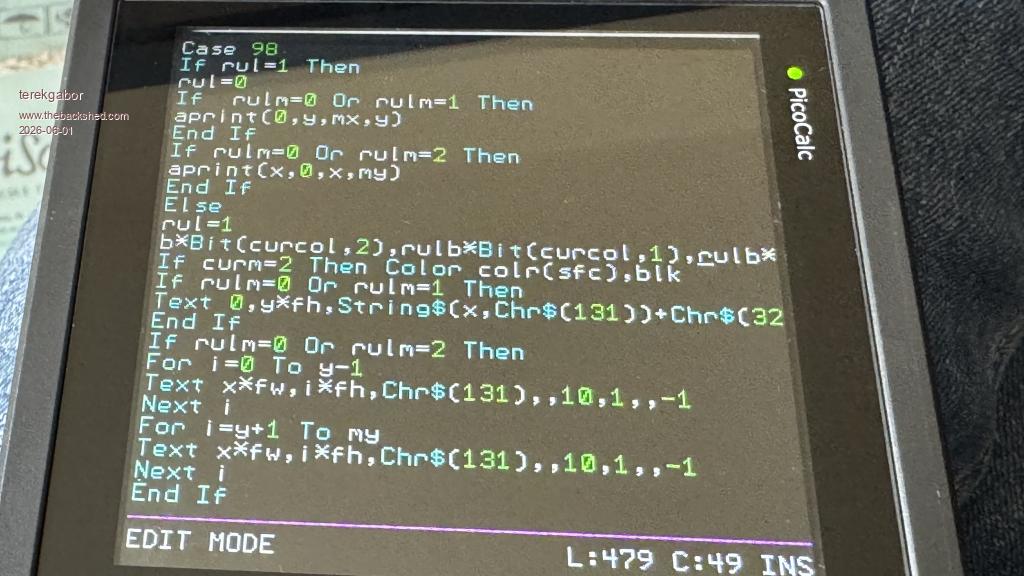

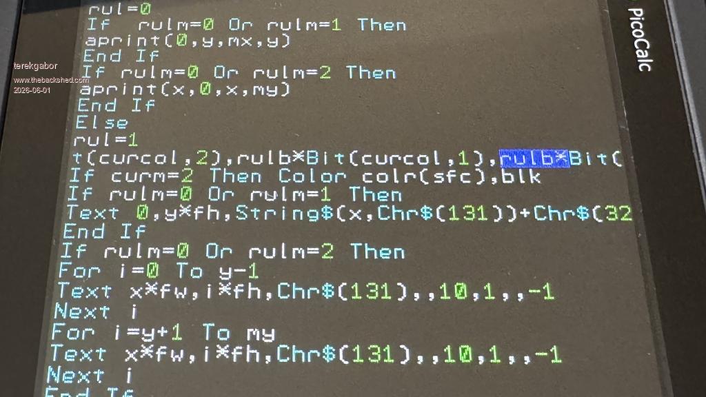

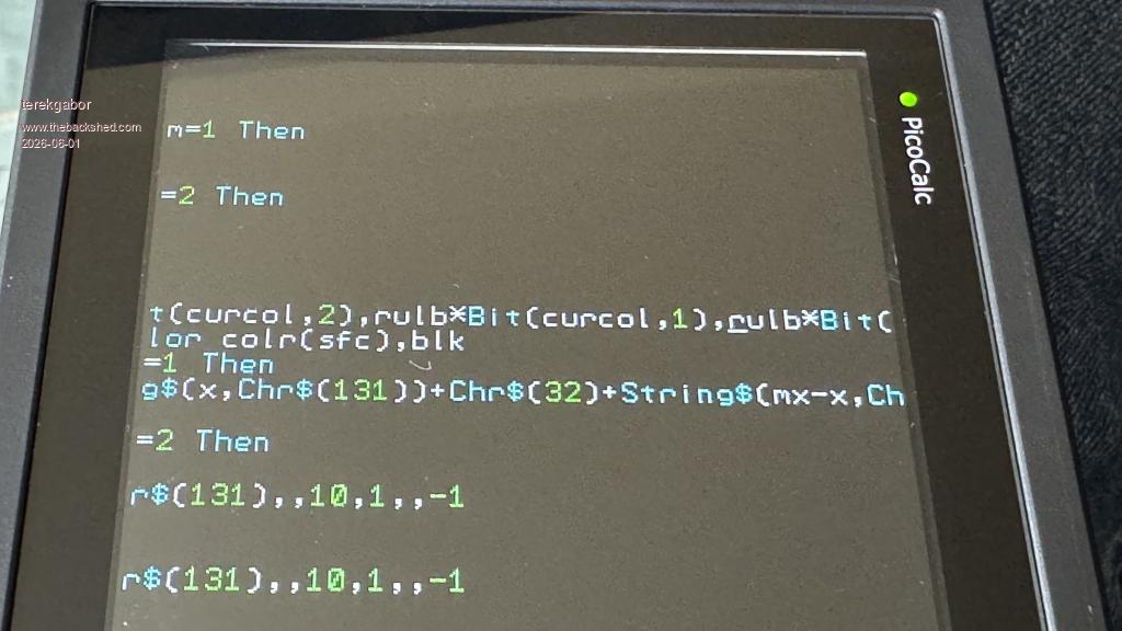

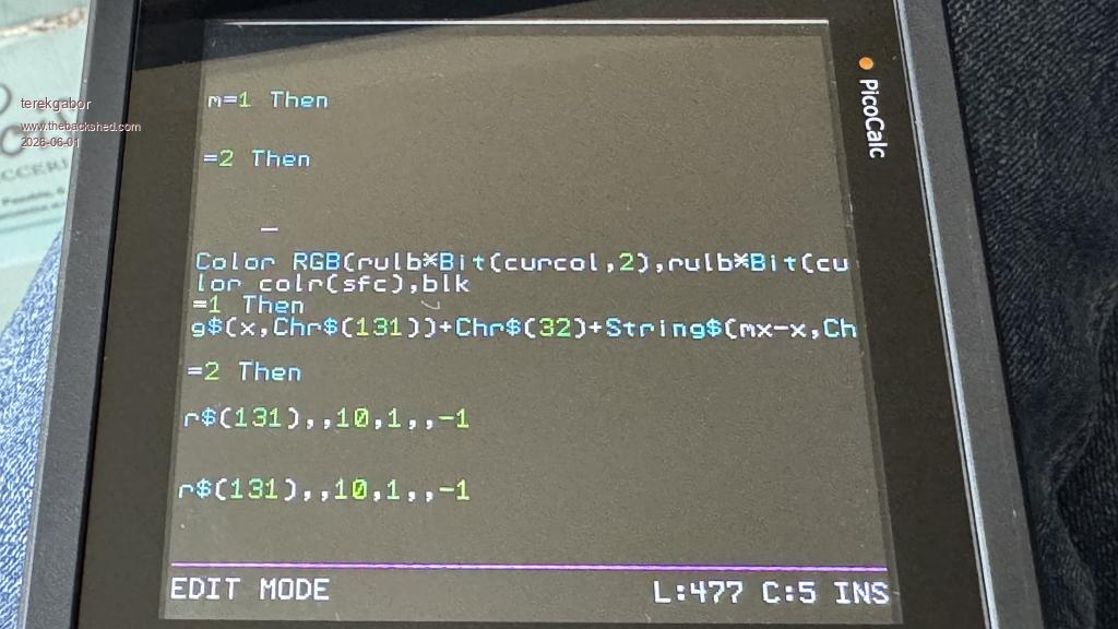

I have found an other error with long lines in editor with Picocalc. (Webmite 2350 version RC14)
When I am in a long line and go right with the cursor the long line is scrolling good. But when I select an area here with F4 button, then press F4 or F5 to copy or cut it something happend with the other lines as you can see on pictures. From that point I have to press F1 save or ESC exit then re-open the editor.

Gabor,
tried it on HDMI USB version, same effect. You can possibly use Pos1 or End key twice to get out of the situation, works at least for me (working over a serial console). But it is definitely an issue.
Gerald
