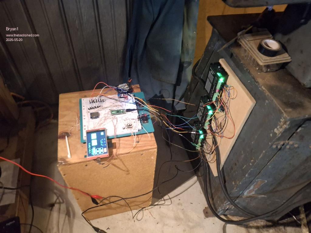

yes mate that code was buggy and the lcd did a white out, now with that code from yesterday got the X axis trying to move so playing with current and step resolution.
I did take some time to get it all wired up and here is a picture of the setup
Lyle I do hope this makes your day mate   got the X axis working on the grinder doing the calibration now and I did find putting the feedrate upto 1500 works a treat
Regards Bryan

Now what I've found got the X axis moving and calibrating is fun but getting there but with the Y and Z axis got no movement at all with both axis. Both are in holding current mode too.
Now when I jog the X axis the power supply does go just over an amp and with  switch 4 off on all 3 DM556's the holding current is 0.567 amps, when I do to jog the Y and Z axis the power supply doesn't move at all so it doesn't look like they are working.
I've checked all my wiring and nothing is out of place too

A couple of thoughts on the issue you are seeing:
The stepper drivers output a LOT of RF noise on both the power input cables and the motor output cables if they are not screened. This might be getting into the breadboard LCD connections and causing grief. Perhaps try sticking an earthed metal tin / box / cover / baseplate around the breadboard and see if it changes anything.
With multiple drivers being enabled together, there may be a momentary dip in the power rail, enough to upset the Pico / LCD. Try running with only the moving axis powered and see if it makes a difference.
The coil winding machine is much smaller and the Pico / LCD are in an earthed aluminium housing but until I connected a short 2.5mm2 direct from the control box to the machine I still had problems with noise / dropouts / missed steps.
There may also be a problem with your shed, I can see at least 2' square of bare concrete floor not something seen here in a while
