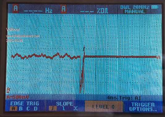

<ctrl>-C and PLAY STOP have a horrible sound now. The samples (for a short time) go to 0 volts (so maximum amplitude). You might better have simply muted the audio (write 50% dutycycle in the PWM. (**)

- play stop and <ctrl>-C still give the terrible click (have not used the scope, but it sounds the same as RC7_4).

  Quote  play stop and <ctrl>-C still give the terrible click (have not used the scope, but it sounds the same as RC7_4).
I've checked with the scope and before I could trigger on the pulse - now I can't.
PLAY VOLUME 25,25 PLAY TONE 400,400. Set the scope so it just doesn't trigger on the sine wav. PLAY STOP or ctrl-c and it doesn't trigger. Before I was seeing a spike to GND

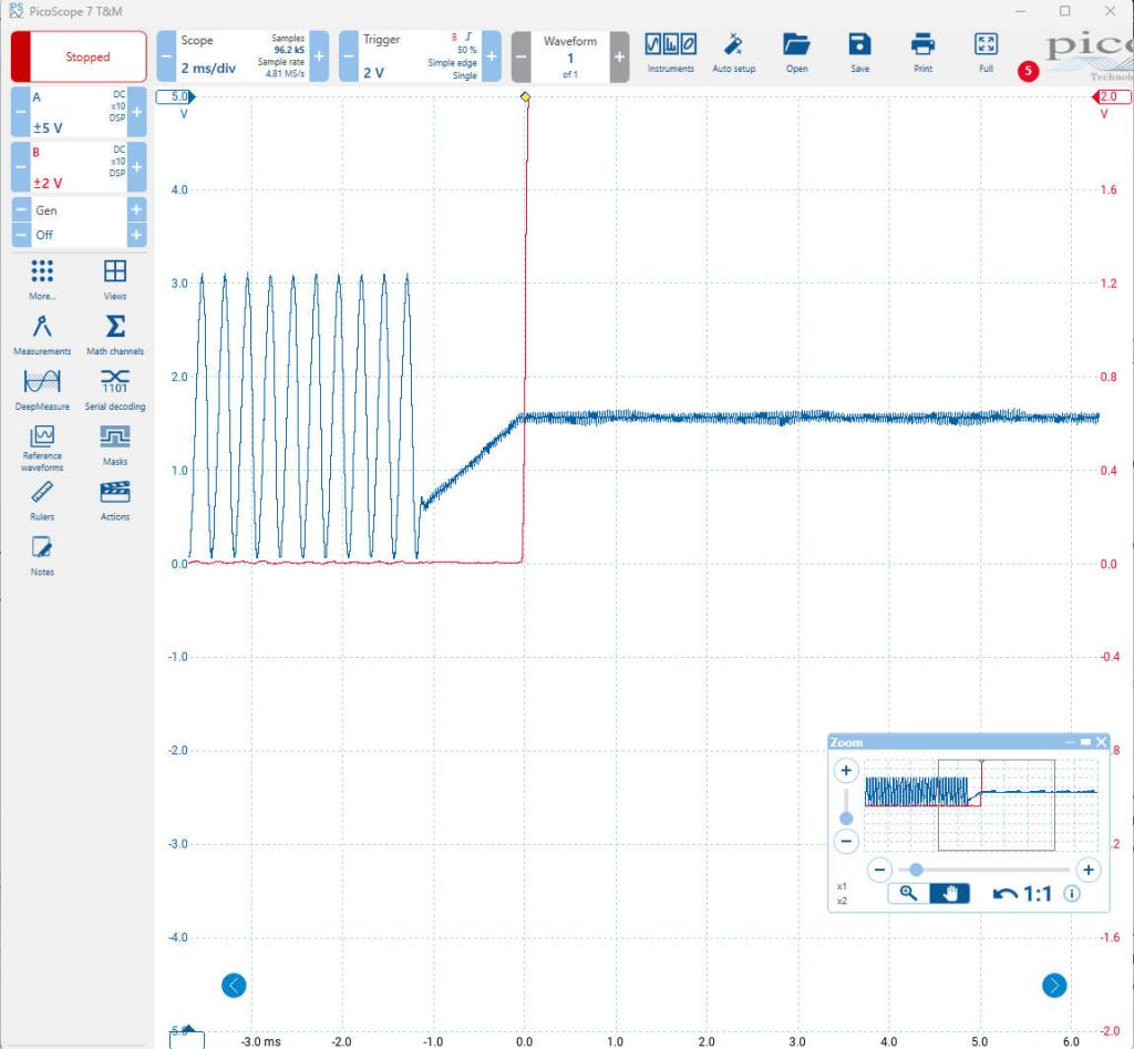

OK, I dare you to find clicks now
I used a GPIO pin to trigger the scope as either a timed tone ended or immediately after play stop. There were artifacts on the waveform caused by a couple of issue but I think I've stopped them all
PicoMiteVGARP2040.zip
This is a 4000Hz waveform stopped after 600mSec and you can see the nice ramp from the last level back to centre

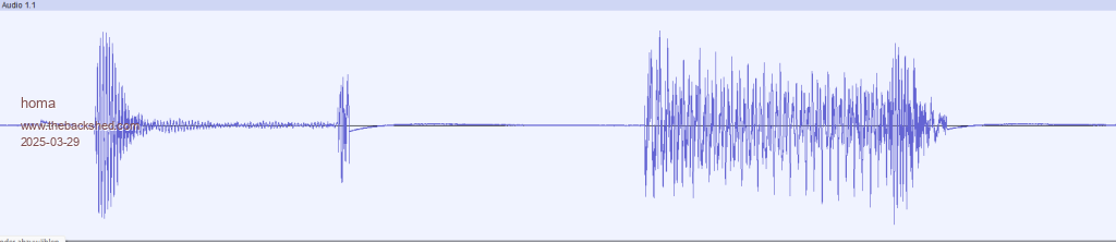

I have reactivated my old VGA board with the PWM output and installed the latest test version. Unfortunately the rp2040 does not support mp3.
So I used my Sultans.wav for it. What can I say? The sound output is perfect! No PLOPPS to produce, not even with [Ctrl]-[c]. Excellent work Peter!

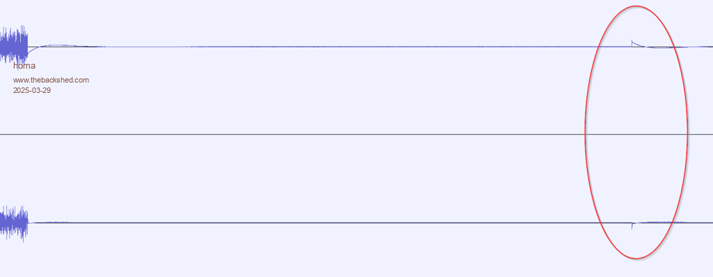

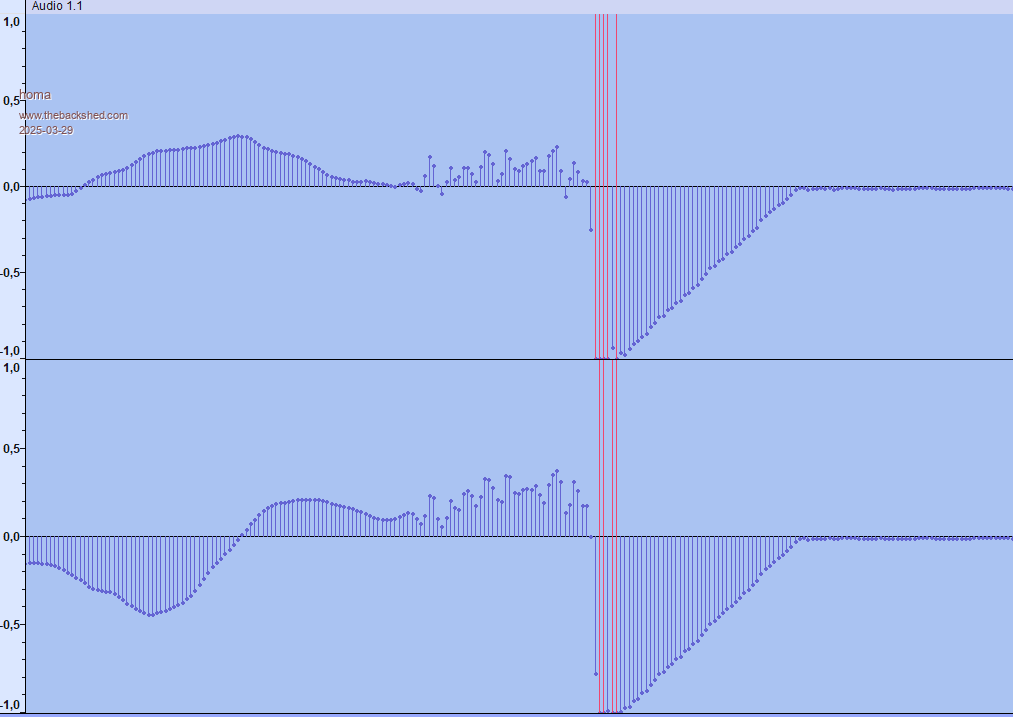

Posts: 6253
Posted: 04:43pm 28 Mar 2025

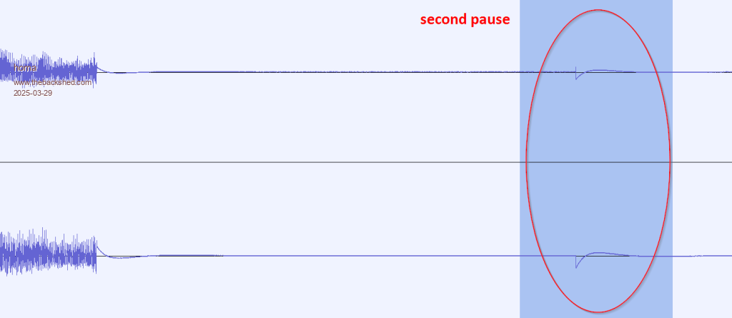

Sorry Homa,
I have to disagree to some point.
The PLAY TONE is perfect.
PLAY WAV and PLAY FLAC are not always. If feels a bit as if the actual audio sample value has impact on the behaviour. Pictures from a different scope.
Sometimes PLAY STOP is almost perfect. Here a single audio sample is wrong. This is almost inaudible.
Sometimes it is perfect. Like the soft return to 50:50 when playing tone.
But sometimes it is not.
Looking at the PLAY TONE (that always works perfect), the correction is always from values <2000 to 2000 (slope upwards). Also if I look at the waveforms Homa send: the correction is always with a rising slope. If you look at the above picture, the value of the signal is >2000, and should ramp downward to 2000 (falling slope). Is that the problem ?

with the latest version I have the problem in this case,
pause and restart playback too often:
> play flac "trick
> play pause
> play resume
> play pause
> play resume
> play pause
> play resume
> play pause
> play resume
> play pause
> play resume
> play pause
> play resume
> play stop
as a result:
double pause and stop is no longer a problem,
but this is still ...
> play flac "trick
> play flac "trick
Error : Sound output in use for FLAC
> play resume
Error : Nothing to resume
> play flac "trick
> play pause
> play flac "trick
Error : Sound output in use for PAUSED
> play resume
Edited 2025-03-29 03:30 by homa

With this version, there is always a plop with this pattern:
> play flac "trick
> play pause
> play stop

I think I'd got the left and right channels backwards so the slope was on the wrong channel. Of course TONE n,n would show that but TONE n,m gave me the clue

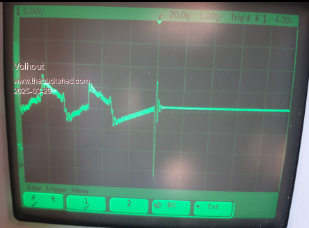

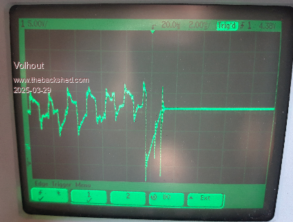

@Peter,
Last version, playing WAV, 90% good PLAY STOP, 10% still the(a) artefact.
Playing FLAC, have not seen it yet.
This version also plays Kong.
If you are close to release I will carefully test all programs more thoroughly.
Triggering: I set the volume so it is between 0.5V and 2.8V max. Then I trigger the scope on 0.3V. These extreme glitches always reach 0V.
The PLAY STOP artefact: I thought it looked like performing a signed operation on an unsigned pwm value.
Edited 2025-03-29 05:54 by Volhout

  Quote  I thought it looked like performing a signed operation on an unsighned pwm value.
No it appears that reading the current PWM output level off pwm_hw->slice[AUDIO_SLICE].cc is unreliable. Sometimes it returns zero. I've changed the algorithm to remember the last value I set rather than trying to read the register and I can't now  break it - but I'm sure you or Homa can

Posts: 6253
Posted: 08:01pm 28 Mar 2025
What Homa is seeing looks what I described as the risk of keeping the last PWM value, and not returning to 50%.
The "tail" of the audio is the AC coupling of the sound card, compensating the DC of the non-50% dutycycle to zero.
Then at resume, you have a charged AC coupling, that is driven by the new (silent ? around 50%) audio, and the capacitor discharges again, with shown result.
