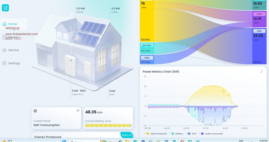

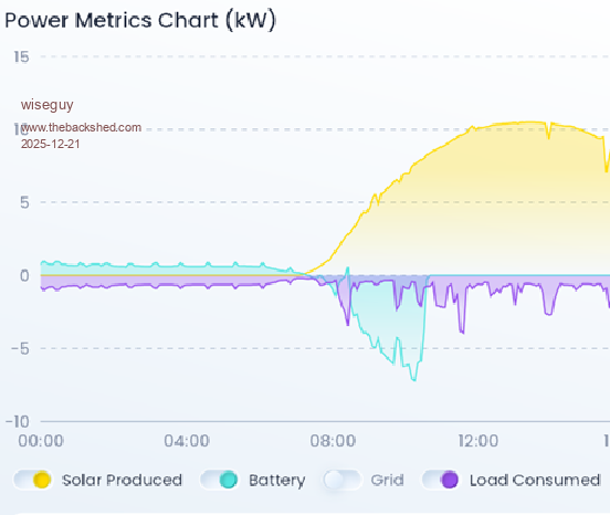

The Sig storage/inverter system has been in & operating, essentially beginning on 18/12/25.  I think its only fair to inform now about the negatives of a Sigenergy system and some of its internal workings and secrets. I was checking on our overnight consumption and was alarmed at how high it appeared.
First a bold statement. Overnight my 48kWh system appears to self-consume over 4kWh of standby power or close to 400W continuously, nearly 10% of overall capacity.This has nothing to do with phantom static loads of the house it is just what it requires to exist. So in a typical 24 hour cycle it consumes, I estimate over 8kWH of our solar bank consumption.
The Sig graphs gave the dirty secret away if you look carefully enough you see it. Overnight there is ~ 650W minimum consumption disguised as house standing load but curiously at ~ 7AM the house minimum standing power remarkably drops to ~ 200W then in the evening around 7pm it increases again back to ~650W.  The 7/7 time points align with the beginning of solar start and solar stop for this time of year. I could not understand why the 650W dropped by around 400+ watts before the solar appeared to start in the morning, then I started to realise what was going on & the reverse at dusk. Why was the standing 650W dropping to 200W before the solar appeared to begin?
The energy consumption is hidden in the daytime as the standing inverter self consumption appears to be robbed from the solar energy created before it actually reports on what is the resultant solar generation (ie what is left after we remove ~ 400W from the actual solar generation).
So a check with Mr Google and the first hit revealed some interesting information.
"There was a post in the Sigen app community about a week ago commenting on this. One user suggested 60W for the inverter plus 35W for each 8kWh battery module."
I knew there would be some inverter standing loss and 60W sounds slightly plausible albeit on the very light side for a 25kW inverter, the real shocker (pardon the pun) was for the 6 x 8kWH battery stack to be using over 200W continuously over-night. Some other Sig information on the Web mentions BMS and Battery monitoring and balancing power consumption as the cause.  Do we need a balancer overnight when not charging & surely monitoring and BMS should draw less than 5W.
I believe what is going on is that the 32V to 600V converters running continuously in each module is chewing up the extra 30+ watts per battery module.  This tells us that the overall trip from batteryV to mainsV ie inverter idle current is really around 400W. I am unsure if the 35W per module was calculated/derived/assumed from the total energy on the HV "bus" to the inverter, divided by the number of battery modules or if the standing current per battery module also increases proportionally for fewer battery modules ?
Sorry for the longish post but if considering a Sig system, be armed with some hidden detail of what is going on internally. Nearly 10% of your battery capacity is not available as it is eaten when the sun isn't shining, and when the sun is shining it takes ~ 4kWH of consumption before you ever see it.
Here is a picture of the Sig information graph. The green is battery energy being used, the lower purple is shown as energy for the house. Look at 6am and you will notice a decline of battery energy supplied to zero at about 7:30 as the solar is now reported to have started generation.
The decline in battery energy is caused by the true beginning of solar energy from the panels from ~ 6:am.  The 300W house consumption shown was a snapshot of the graph during a house minimum load during solar generation.
Zoomed in: The house load (violet) & battery energy required (green) magically drops from 650W to ~ 200W before solar supposedly "started"!
Battery was fully charged before 11am.
Edited 2025-12-21 10:29 by wiseguy
Cheers Mike

Wow Mike that sounds like a hefty self consumption.
Maybe you should start a thread about the Sigenergy battery system so we can keep an eye on it.
I have seen something about some of the Sig systems having failures on the power plugs, the claim was that the plugs were not crimped properly but that the company had changed the style of input/output connectors on the single phase units to use
Eye Lugs rather than crimped Ferrules.
I hope that there is a way to lessen the self consumption that would not be good if there were a few days of heavy cloud in a row.

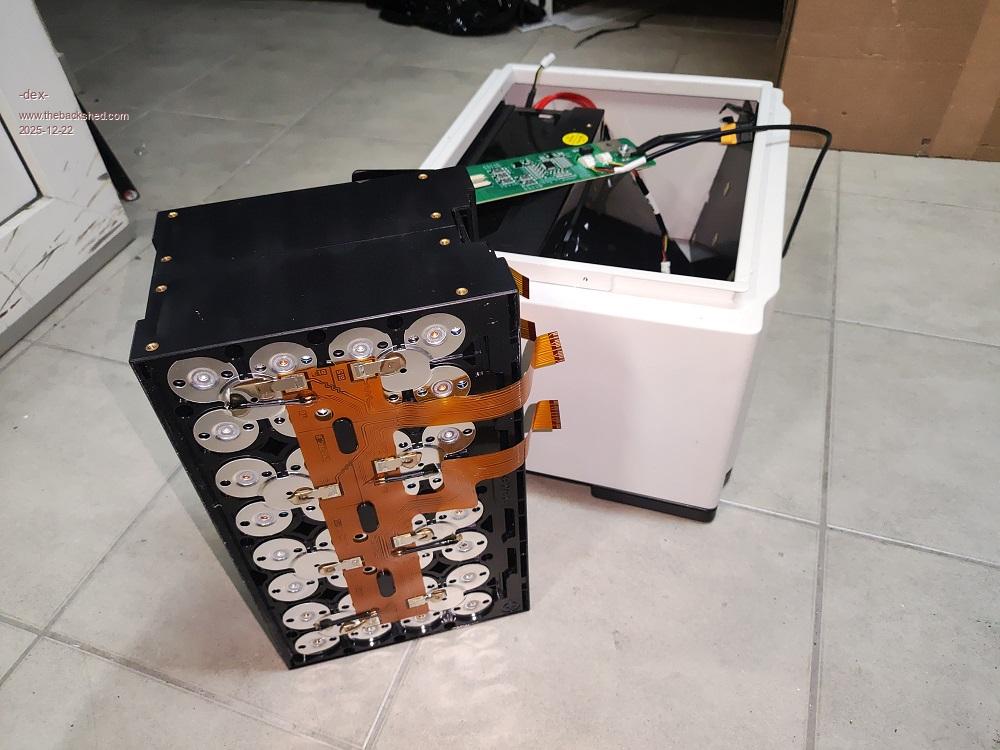

I have a similar commercial product here, very similar to yours, that failed. Actually, I have a lot of them. One single module contains two ~51,2V battery pack inside. They're 2 in series, providing a total of 102,4V. Two black boxes in one white box. These white boxes can be connected in few series, providing high-voltage storage up to several hundred volts.
One black box contains a total of 32 cells in a 2P16S configuration. From reports from other colleagues in the market, I know that many commercial products use this type of cell.
Oh... none of these inverters are LV inverters, or even those equipped with a toroidal transformer.

Our inverter has so far operated at about 3.5 MWh over within about 1.5 years. As we can see, our consumption isn't as high as we thoght.
For MTBF... What could be seriously wearing out? Probably the CAPs. I tried to calculate the operating time of my main CAPs when I bought them. There are ready-made formulas and operating time calculators, and I remember that the operating time is a solid several years. It's difficult to assess the wear and tear of contactors and relays. In winter, when there's no sun, the system disconnects and reconnects once a day.These little low voltage converters have an absurdly high runtime-MTBF.
Furthermore, in my inverter, nothing more than 6kW has ever been put into it.
If you are bored, try calculating the MTBF for your inverter   In my built MPPT chargers will probably fail (wear out) faster. This is still a short period of time to evaluate working time.
And we're still testing the commercial product in the photo. The devices report an energy storage error due to low voltage cell's error – on some cells, the cell voltage drops below a critical level. This is likely due to lower-quality cells (significant differences between cells, e.g., capacity or internal resistance) or an ineffective/too weak/too slow balancer. Unfortunately, the manufacturer used a passive balancing system here.

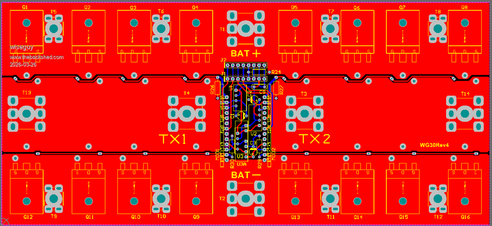

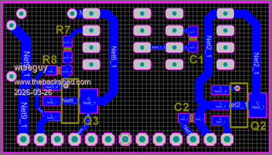

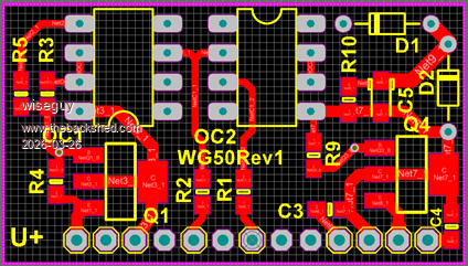

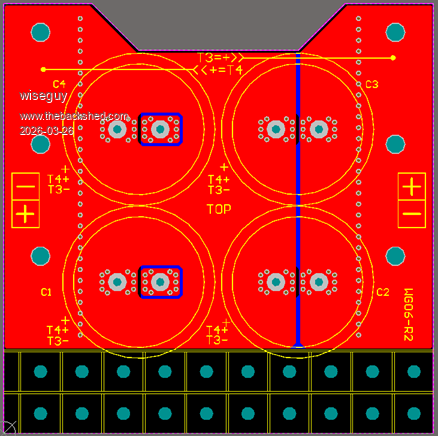

In the background I have been mulling over the current WG inverter design. Despite being on holidays travelling, sightseeing etc things of a technical nature are never far from my mind.
The main gripe was having to do a 3D leg bend on the upper Mosfet drain legs to accommodate a ferrite "bead".  During the design I thought only the lower FETs were affected but after testing the new PCB board it helped to have the beads on the upper FET drains too.
A solution to this issue needed a slab of uninterrupted design time for me to engineer a solution.  In my next post I will present some pictures of the changes that I have incorporated into the new power PCB design.
The board dimensions have changed (shrunk) from 18 x 36cm to 18 x 33.6cm.
The previous real estate used for the opto couplers and through hole parts has shrunk and instead there are 2 rows of pins for a small vertical sub board for gate drive on each side central to the power PCB.
The sub board has the 2 optos (DIP or Gull wing), gate drive buffer transistors x 4 (SMD) and ~ 13 other 0805 SMD parts, 2 of these PCBs are required. I have tried to avoid SMD parts in the past but these small modules are relatively easy to assemble even with tired eyes and the buffer transistors are only available in SMD now anyway, at least they are the larger SOT223 packages and not SOT 23's !
The small DC/DC converters are mounted central to the power PCB, between the two vertical module PCBs. Note the modules are intended to be soldered, using sockets here by all means do so but at your own risk - I don't recommend it!
The choke heavy duty connectors can either be soldered near the centre of the power PCB or to the outer edges. The Capacitor PCB are able to be rotated 180 degrees to suit either location. Note the new Cap boards no longer have a rectangular notch out for the choke connectors but a wedge shape leaving more current carrying copper on the PCB. The old Cap boards can be re-used but if reordering boards the new ones are recommended.
I have altered the Upper Mosfet leg bends required to simple 90 degree bends. The PCB Drain hole allows up to a 6mm "bead" to be used with no issues. The resulting lead bend changes means the gate trace now meanders a bit and is no longer a straight line. The gate trace looks a bit narrow, but it now has a second parallel trace on the bottom layer.
The result is that the high current paths for all the FETs travel from ~15 to ~20 mm less PCB trace distance to the high current connectors too.
The only catch here is that I have no plans to order any PCB's for myself at this stage. I am content to use the boards I currently have. The small gate drive modules have been tried and tested on my 12V inverter design and are therefore proven. The Power & Cap PCBs have not been tested but I am confident they will work first time as all previous boards did too (except for a small trace glitch on Rev3.... easily fixed).
Apart from a simpler FET lead bending regime, drilling the FET holes for screw mounting to the heatsink are very regular spacings, ie 22mm, 30mm and 48mm. If you use two aluminium bars as I do, easy! However if you mount the PCB straight to a heatsink face the two rows of holes are spaced apart by 86.6mm so in my case S.E.P.
I am just offering a second choice that simplifies the assembly a bit for any bulk orders that may be currently under consideration.
Cheers Mike

The power PCB:
Cap PCB:
Half Bridge Module, front & back
sorry for the slightly different sizes for front and back designs....

I really do like this final refined board layout

Hi Wiseguy, the Aussie build group is poised to group order our boards, but it might not be too late to incorporate these improvements. Do we only nèed to re-quote the power board and how can we get the Gerber files to do so? By PM to you?
