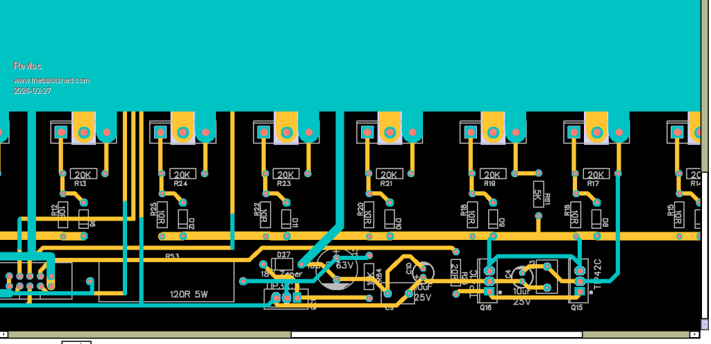

Brian, did you (or someone else) see the last Gerber PCB mad board file, there might have been some changes to the power board Depending on which board you have, the latest has a 10K on Pin 1 of the TIP35C, as well as the 18v Zener,  my board has not got the 10K, not sure if there was anything else, or if that is correct?
Don't want to create any confusion, but worth checking solder joints around the TIP41 and 42C just to be sure.

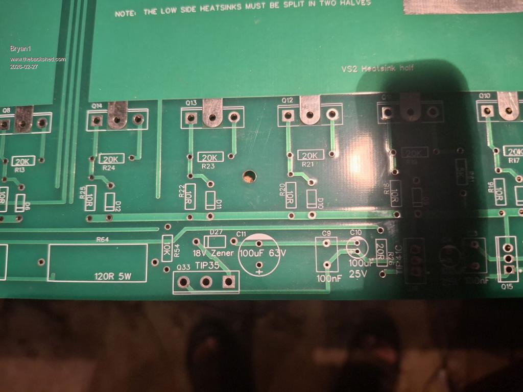

Hi Aaron I do have that latest board but that 100uf cap is around the other way
Now Keepis I always use that 60 ohm 120 watt bank of resistors and have a voltage meter attached also with the programmable power supply shows the current draw and on charging 400mA was the highest current until the caps got to 20 volts then the current draw dropped to 50mA.

Both boards look right with respect to the CAP, different tracks, unless I'm blind.
Brian, thats good that you are still using the resistors
BUT
if the voltage gets to 20V, then the resistor and the current limit mean NOTHING!
If you were to make a slip up when measuring components OR plugging in or disconnecting the Ribbon cable to the power board, Then the Charged caps, of the value you have, could deliver over a 1000A pulse to the FETS.

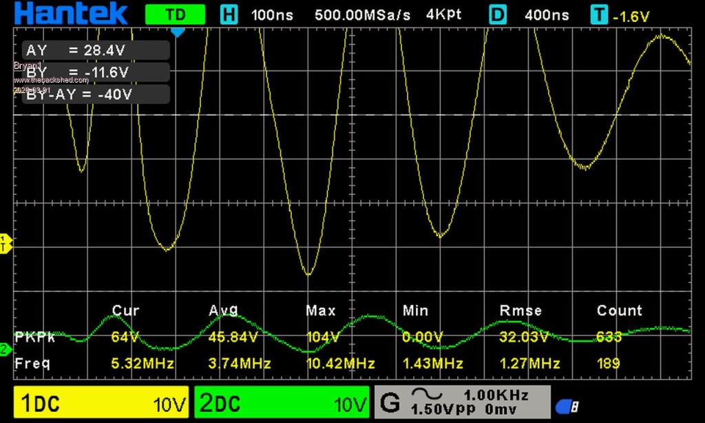

Ok with this wet weather got the noise of my genset going to charge the shed battery.
Anyway powered up the controller board and measured 17.8 volts on the 18V zener, now when the ohm meter is used the Vbat + and VBat - are shorted out. Doing an ohm check on a few fets shows the gate is isolated and the source and drain pins are a dead short, so would this mean the fets are gone?
Anyway setup the scope and got a pic of the L01 and L02 first test
Regards Bryan

They should not be the L01 and L02 of the un-driven power board. They should be the L01 and L02 signals coming from the controller board.
TinyT I put a 10 connector on the end of the ribbon cable where VS1 and VS2 were connected to the ground on the connector.
