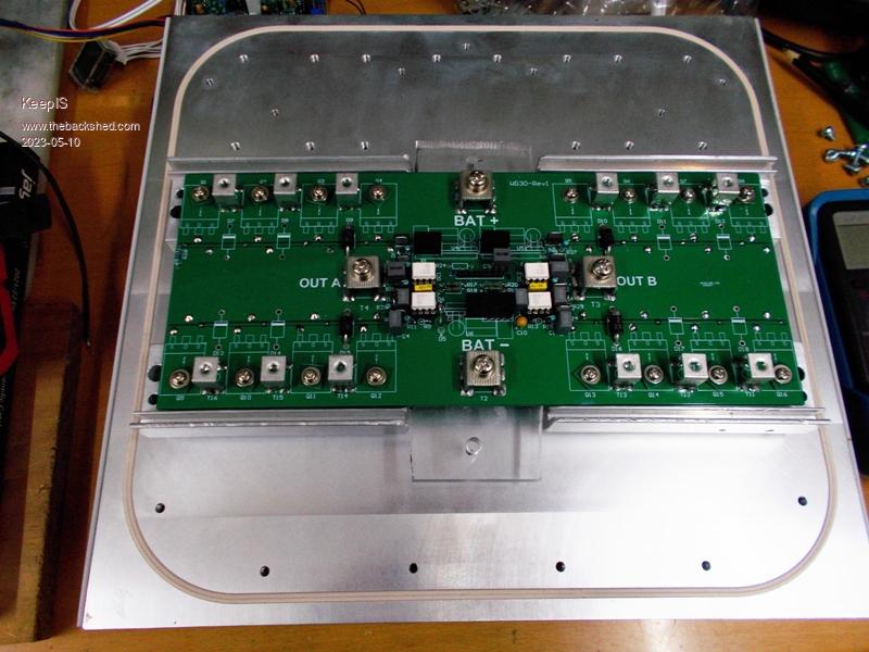

Finished tapping the heat sink, came up with a novel way to clamp the board with its intermediate heat bars to the base heatsink, fired it up and no smoke.
Tomorrow it gets fitted with big caps and plugged into the main Inverter cabinet, it will be driving the triple core Toriod for the first time, and some real loads. A tad nervous.

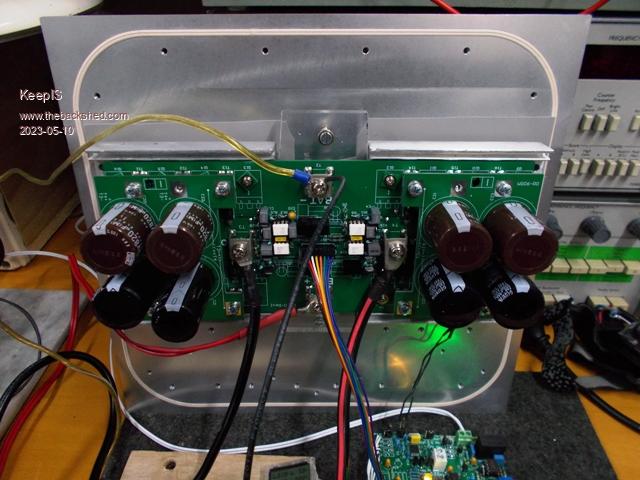

If you look closely at the last picture I posted [08:03pm] you can see the thermal mat underneath the heat transfer bars.
  Revlac said  Fingers crossed, hope it all runs well.
Thanks, if it does go bang, the great thing is, the way wiseguy designed the FET mounting and layout makes it so easy to replace the FETS, and along with the way I built it, there are just a six screws and the Power stage is removed from the big heatsink, a few screws and the Capacitor boards are off, and that's basically it.
If I have a problem it's hardly any effort to fix, the only pain is figuring out why, but I'll cross that bridge when /if I get to it.

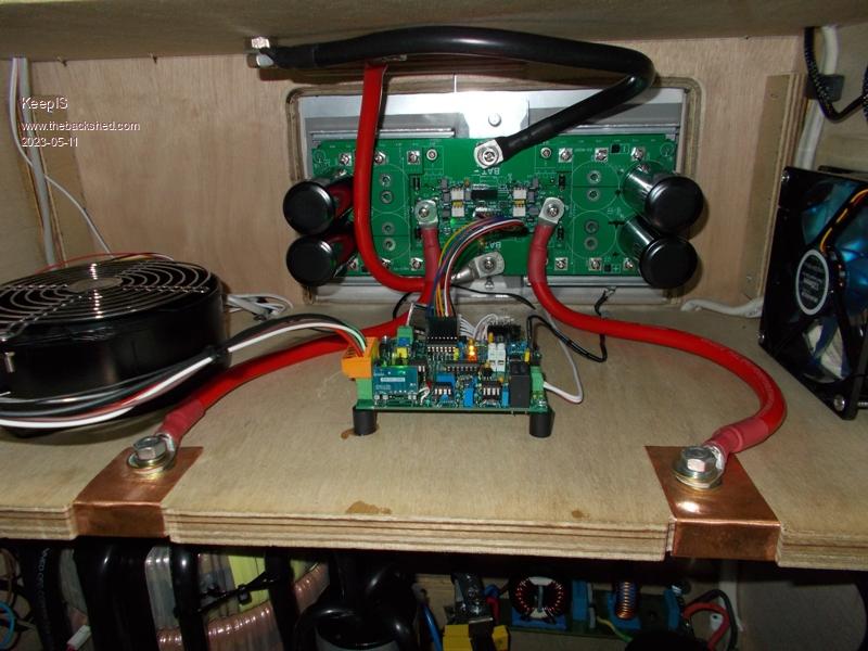

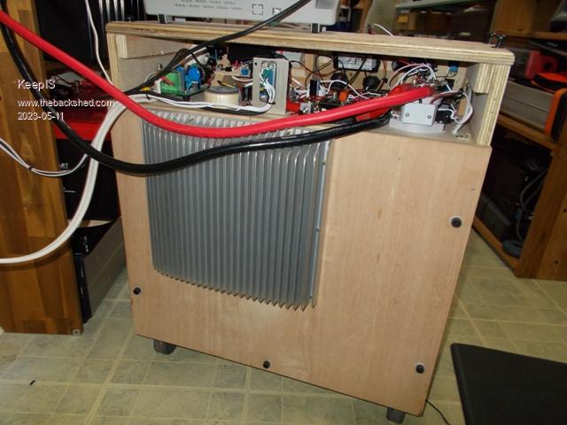

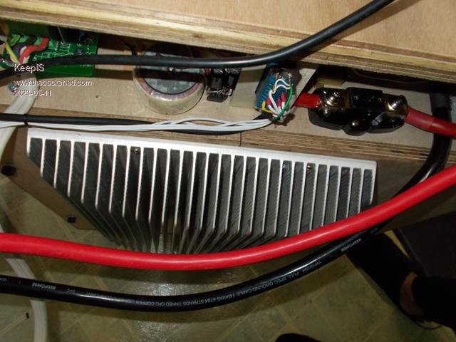

It took me a lot longer then I thought to mount the heatsink through the back of the Cabinet.
The Back simply unbolts so nice to work on, once I was certain it would fit and remeasured about 20  times, used the Band saw to cut the hole and rounded over the inside edge.
I fitted a total of 4 of the big 10,000 caps, cap boards can be removed and fitted in seconds thanks to wiseguys design, and the room I have ih there makes is even easier.
Here it is mounted to the cabinet getting ready for it's first detonation, there is so much room in there now.
Side view to show how little the Power board intrudes into the cabinet.
BTW that cutout is not as rough as it looks, it's very thick marine ply and the little trim router did the best it could making a beveled edge, it looks really neat in reality.

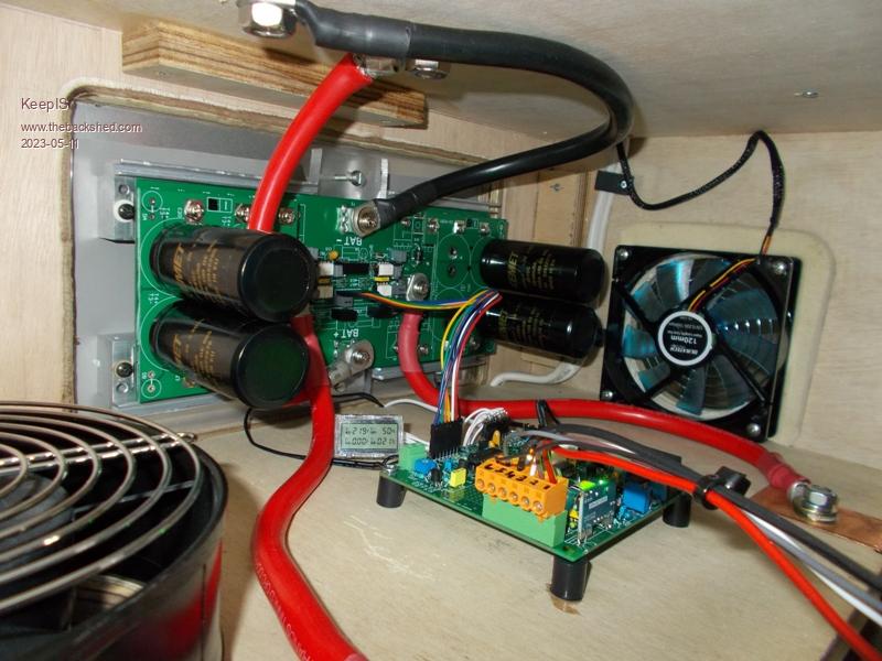

KeepIS
Joined: 13/10/2014
Posts: 2287
Posted: 08:12am 11 May 2023
Few more photos for prosperity, these heatsinks are really meaty and all fins are nicely rounded over.

Posts: 2287
Posted: 08:33am 11 May 2023
A short time ago I turned it on, and it powered up and ran, no smoke.
Tried it's first big load of 1500w heat gun, no smoke and not even a flicker from the overhead LED fluor lights.
Switched it across from mains to the Inverter powering the home, everything went as expected, I then switched on the heat-gun and bang, lights flicked as it auto switched back to mains power.
The bang was the big contactor dropping out, and the 8010 LED was flashing twice for over current. I wound the current trip all the way up.
BTW the Reset did not work, had to power off and on.
Retested and this time all good, the biggest DC current input so far is 186A, that from an external Vacuum system for the workshop (not the dust extractor)
I tried the Bandsaw, and as soon as I threw the switch it kicked back in my hand as the NVR switch tripped, auto back to mains and over current. The band saw draws around 390A.
Anyway, no blowup, current trip works but needs to be modified for higher current.

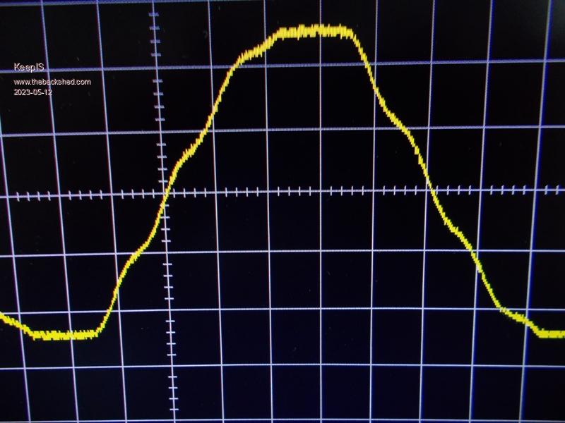

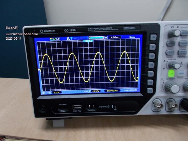

There is a slight ripple over the waveform and has nothing to do with filtering, I have a big mains filter as well. Chokes make no difference.
FYI: Nothing in the Lower compartment has been touched, Toriods, ac feedback, chokes, etc, when swapping the power boards over.
Now the interesting thing is, I got a glimpse of the Heat-Gun on LO, that big kink in the standard inverter is replaced with about 5 cycles of a small decaying sinewave [ringing) where the Kink would be, for now I did not want to test that any further.
So at this stage I would say it's looking pretty darn good.
BTW Under a heavy load, the sinewave is as clean as a whistle and absolutely perfect.

The CRO picture - was there no load on the output ? Whether there was or not the ripple appears to occur immediately after the zero crossings for a few wobbles, that is usually the result of the mains capacitor (1 - 10uF?) and the choke and tranformer winding resonating. I observed this to be worse with no load but mine went away as you loaded the inverter up a bit, it appears to be harmless.
A: CRO pix is No Load:
B: The Sinewave is perfect with loads over 1kW.
C: Changing Choke values did absolutely nothing.
D: Cap is 3.3uf and transformer resonances at 75Hz.
All same values as with previous driver board. The Aerosharp Toroid with 4.4uf did exactly the same thing, even without any choke, identical waveform.
Yes it appears to be harmless, looking closely at the trace, it's very very small and about the same level as the slight furriness on the waveform. This is after a 3 stage AC filter.
The big thing though is this! - There is now zero interference from the inverter in my HAM radio transceiver. Big copper magnetic Loop TX Aerial is mounted just above the Solar panels. There were a few big spikes across the band on the old driver board, now there is nothing but clear signals and normal background noise
Edited 2023-05-12 06:34 by KeepIS

Mike, just out of interest and to give a better view of the waveform running at around 280w load. This is early morning house load at a low point when I grabbed this image.
The Mains AC power has the same flat topping.
I have not got around to finding out what piece of equipment is causing this and I don't really care, it is what it is.
I zoomed in on this, so a but pixelated but it is symmetrical around zero crossing.
Edited 2023-05-12 07:48 by KeepIS
