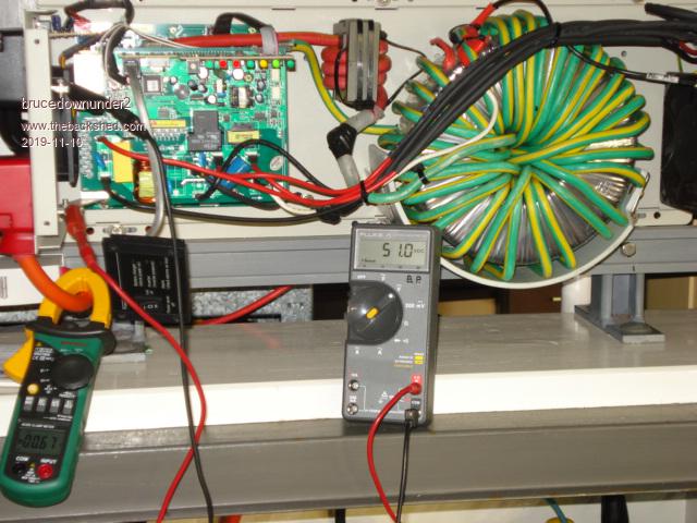

Yep,on mine years ago , I wound 25mm insulated wire building wire and had the same problem -so, I just kept going and had a few turns overlapping .
In the end result ,it made no difference ,all worked perfect.-looks a bit "ordinary" but so do I ,so no problems

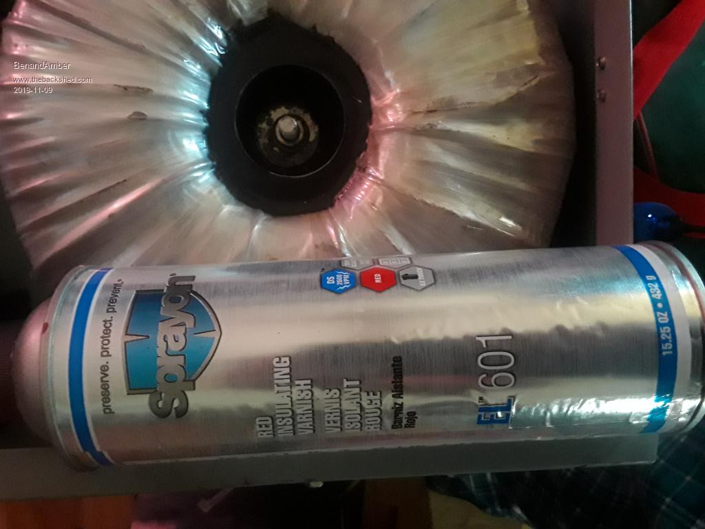

The wire we used on the last Transformer  was pretty scratched up
We purchased a couple cans of this stuff shown in picture
We painted the complete wire after stretching it up across the yard

All very good advice guys.

I remember now , you are talking about the secondary winding, mine was the heavy primary that I had to mess with .
I have not tortured myself with winding a secondary yet.  Mind you ,that 25mm insulated building wire was enough to settle me down -I promised myself ,stuff the kids,I'll spend some of their money on a factory built inverter !!.

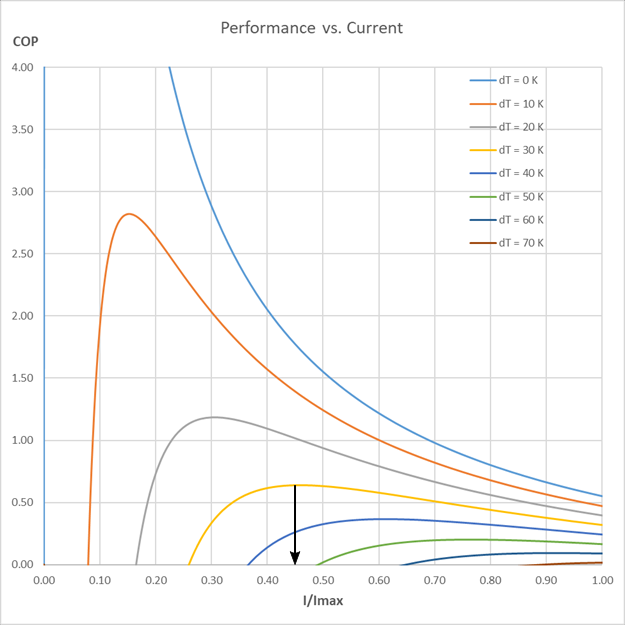

Here is are some fairly typical performance curves for a peltier device.
In this case the max rated power would be at the maximum rated input current 1.0 to the right of the X axis.
You will also see that as soon as the delta T (hot temp-cold temp) is more than about ten degrees, the performance shrinks down to nothing.
The best I could do with a low cost Chinese peltier was to run it at about five percent of full rated power, and keep delta T below about twenty Celsius.
Under those conditions I could measure something like two watts of dc power input, three watts of heat dissipated on the hot side and one watt of absorbed heat on the cold side.  That was for a forty watt rated device !
Any attempt to pump more power into it caused the hot side heat to conduct through the device onto the cold side.  The hot side becomes a LOT hotter, and the cold side temperature also becomes warmer, not colder.
Now you may not believe this, but try it for yourself and see.
You buy something that says 40 watts max power.
Peak efficiency 70%.
And from that you might assume 28 watts of cooling is possible.
Wrong ! the 70% will probably be measured at zero temperature differential and a couple of watts input.
And the 40 watts input, the point of actual device failure, not how you can run it.
But they don't tell you any of that.

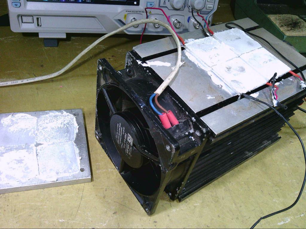

Here is what I finally ended up with, pretty much like that e-bay cooler I think.
Altogether a giant disappointment and complete waste of time.
Nowhere in that e-bay add does it specify any cooling capacity or temperature drop, there just might be a reason for that.

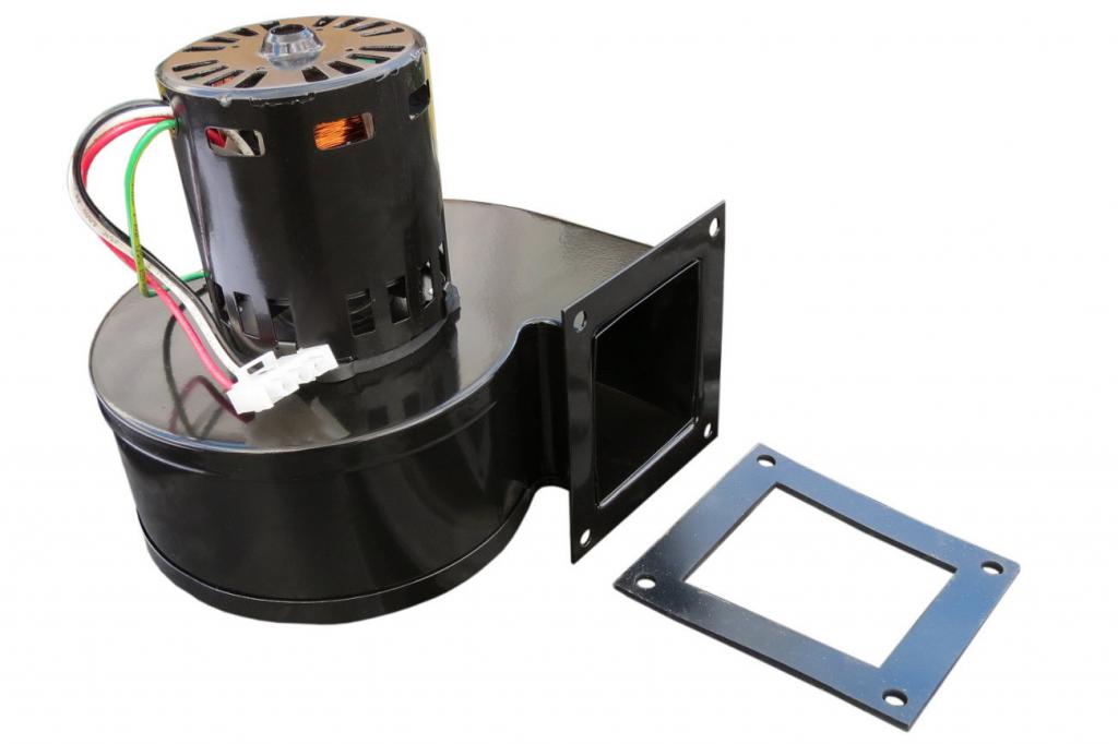

I use the blower out of a Rinai gas space heater. Heaps of air and its almost silent.

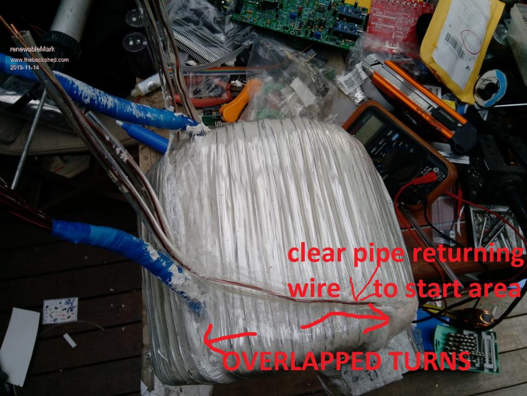

As the second winding had to overlap, the finish of that winding was further around the torroid to the rest of the start finish wires.
So it got a clear plastic insulation pipe and just taped it back to the start area, so easy connections can be made.
As it's on the outside this makes zero difference to the torroids operation correct?
