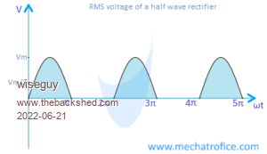

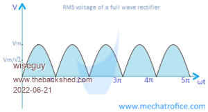

Lastly an update for the EG8010 controller. I put a unity gain precision rectifier between the little voltage sense transformer and the gain opamp and now it doesnt care about the phasing of the secondary. There is a 1.9V difference (234.9V - 236.8V) when I swap the transformer secondary windings phase. The small difference I'm sure is a minute difference between the 2 x halves of the opamps offset voltages - it is an LM358.
The prototyping area came in real handy this time !  So today I will get game and wire it into my inverter for a real test.
