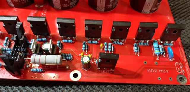

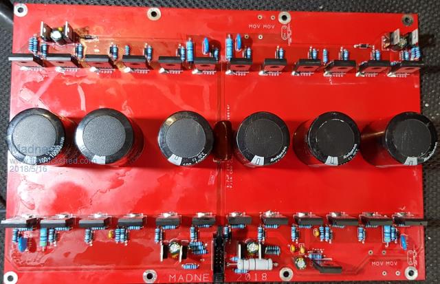

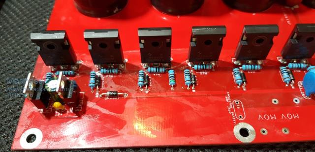

Here is the power board with nearly all the components on it, this board is running with a 2 KW load on it. I would go higher but the breaker I am using for testing would pop.
Don't forget to put a heatsink on the TIP35c.
Edited by Madness 2018-05-17
renewableMark
Joined: 09/12/2017
Posts: 1679
Posted: 01:58am 16 May 2018
Can the 120r 5W on the powerboard be a ceramic like on the control board or does it have to be metal film?
Cheers Caveman Mark
Off grid eastern Melb
Posted: 02:25am 16 May 2018
  renewableMark said   Can the 120r 5W on the powerboard be a ceramic like on the control board or does it have to be metal film?
Does not matter, that one in photo is carbon, what matters is 5W 120 Ohm. I used the Carbon resistor because I have them and am short on the ceramic ones.
I always screw the MOSFETs to the heat sink before soldering them. With the short distance between the body of the FET and the PCB there is no give if they were not all on the same plane. You can clamp the PCB to the heatsink and use a 1.5mm drill in the centre pin holes to mark where each hole needs to drilled and tapped for the screws.
There is a few extra resistors on the PCB that someone with a sharp eye might spot, I need to remove them I was trying something.Edited by Madness 2018-05-17

r77 has an extra?
Cheers Caveman Mark
Posted: 03:21am 16 May 2018
No just follow whats on the board Mark.

Mark, your unit has arrived... first glance you must promise never to use environmentally friendly solder... ever again.
The solder was lead free or your iron is way too cold...... but judging from the pads all tron away from the driver chips, where the lands are small, I am guessing the iron was pretty hot, but the solder would just not run... usually means lead free.
Ok, you have made no real mistakes apart from a wrong resistor on the power board, where you had 20k instead of 5r6. This would not have done much I suspect, as the three or five that would have been with it, would have shadowed the fet that was just way behind the scene on turn on, but the diode would have turned it off fast anyway..
So that did not cause the pulsing.
Tidied up the dry joints, and pushed the components against the board, instead of 8mm above the board, and it ran the power board I was testing with last night for mads stuff... 5kw was no problem.
It ran perfectly well... no sign of hunting. Then used your power board, and it ran fine too..... Then plugged your switch into it instead of my jumper wire for start... and thats when the trouble began, which finally ended in destruction of the fets.
So it turns out that your problems were multiple, frozen joints, and crappy switch.... who knew...
Because of the 100amp of breaker, there was no damage to the control card at all, and I have yet to replace two banks of fets, then I expect we are good to go again.
I found out another thing that Mad will be interested in, the reset using a press switch works perfectly, but if you do a very fast short to ground, it does not empty the voltage out of the 100uf, and so will confuse the 8010... and it will blow things up...
So we have learn't why you have blown units up with reset, and until now I had not. A push button will never blow it, because the action is too slow, but a glancing short is very very fast, and enough to cause us problems... so now we know.
Will probably fix the fets tonight or tomorrow, and I think we will be good to go then.
6v2 should work ok. It is only to trigger the scr from memory.
..........oztulesEdited by oztules 2018-05-17

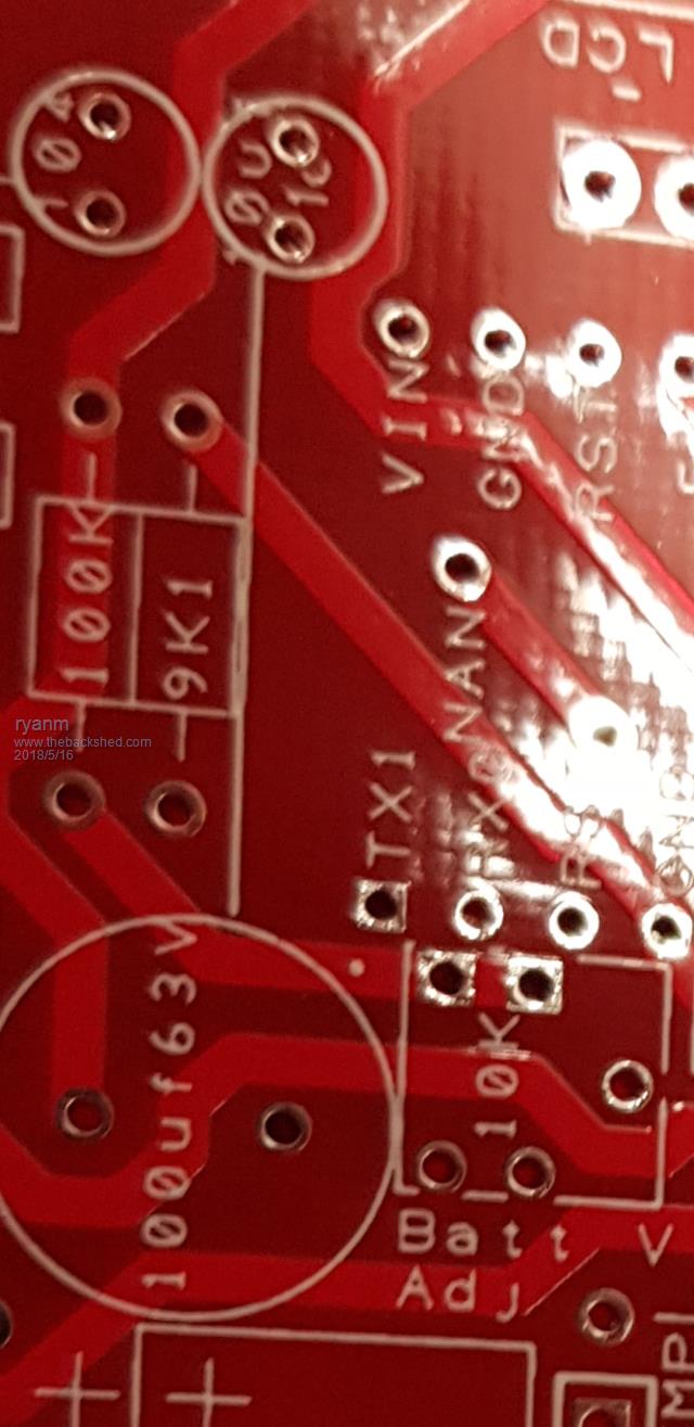

I don't mean to look a gift horse in the mouth, but you could leave a bloke a bit more room to land an iron Madness.
PS. Thanks heaps for all your work.
Posted: 10:31am 16 May 2018
  ryanm said   I don't mean to look a gift horse in the mouth, but you could leave a bloke a bit more room to land an iron Madness.
More information please?
renewableMark
Joined: 09/12/2017
Posts: 1679
Posted: 10:37am 16 May 2018
I think he means not so crammed..... allowing more space to lay an iron without interfering with other parts.
It is tight but it's fine IM(limited)O
Cheers Caveman Mark
ryanm
Joined: 25/09/2015
Posts: 203
Posted: 10:41am 16 May 2018
I'm just being soft. Quite small solder mask offset around the smaller holes.
ryanm
Joined: 25/09/2015
Posts: 203
Posted: 10:50am 16 May 2018
Just saying those top right pads have a lot better thermal transfer than the bottom left.
renewableMark
Joined: 09/12/2017
Posts: 1679
Posted: 11:04am 16 May 2018
I'm prone to sooking like a little bitch, but that wouldn't piss me off.
A gumby like me soldered all that ok.... hopefully
Cheers Caveman Mark
Posted: 11:29am 16 May 2018
Those are the default pad sizes in Designspark, changing that would be a major PITA for every component. I don't find any problem soldering them, worked for me and Oz didn't bitch about it either.
