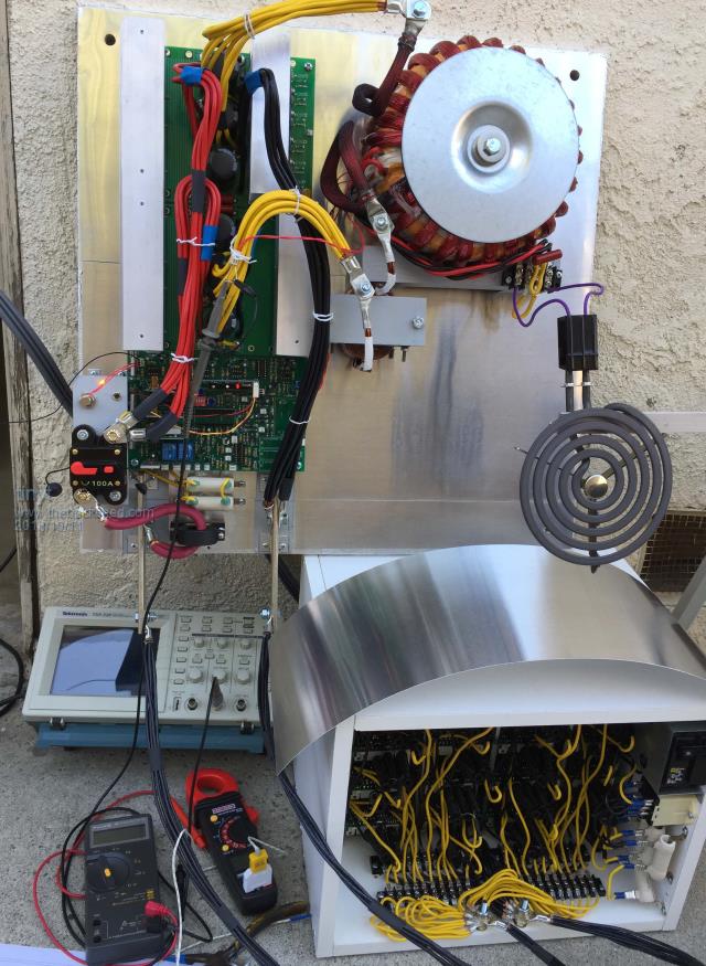

AT the start, heatsink temp was 24.5C(ambient), there is no fan as the box is not yet complete.

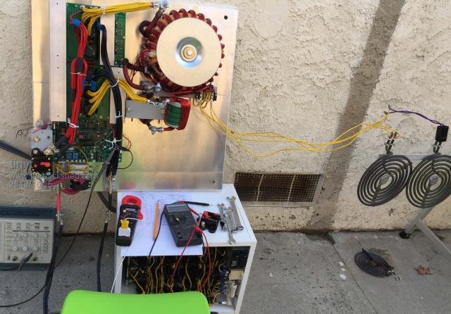

This picture is an earlier setup outside the house. The stove heating element is contributing to the temperature rise and also heating up the top of my power supply. So in my latest testing, I moved the stove heating element about 2 feet away.

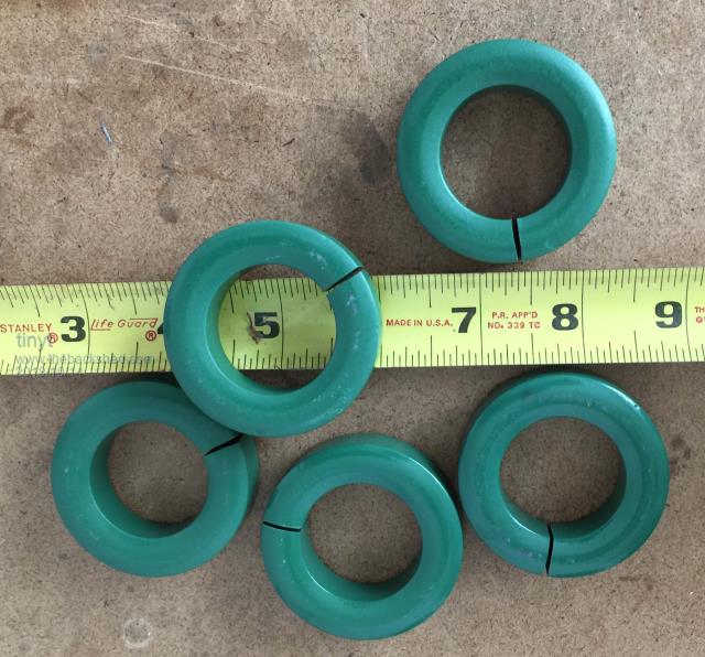

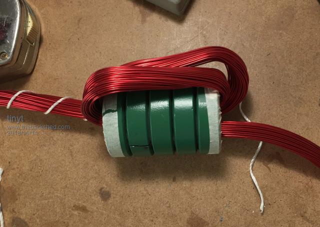

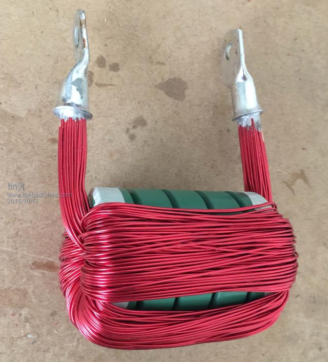

I don't have an Exx ferrite core but I have several small ferrite rings. With 5 turns, the inductance measured 137 uH. But when I cut the gap, it went down to 4 uH. The gaps in the picture were cut with a thin blade diamond saw. They will be filled with epoxy for mechanical strength.
I glued the gapped five rings together and used the 84 wire strands left-over from the toroid primary for the winding of this ring stack.
Here it is, 5 turns made it. They are not epoxied yet but will test as is. Inductance measured at 70 uH.
Will connect it in series with the EI choke and do load soak test later.

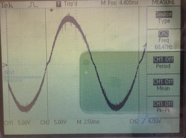

Posted: 02:43am 15 Oct 2018

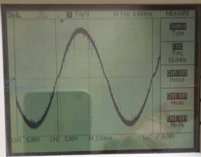

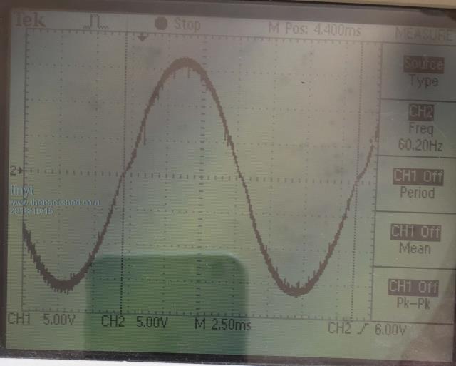

With the EI core and ferrite ring chokes in series, I am back to idling dc current of 0.31A.
Waveshape looks good to me.(scope trigger is stopped in this pic.)
I trimmed the VFB pot for a lower output of ~224vac as it was a little bit high for me (236vac). Here is my load soak test setup, 4kw load shown, ring choke not yet securely mounted. Ambient temperature was about 23 deg. C.

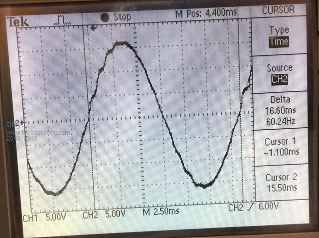

Here is waveshape with 1.2 kw stove heating element. (scope trigger is stopped in this pic.)

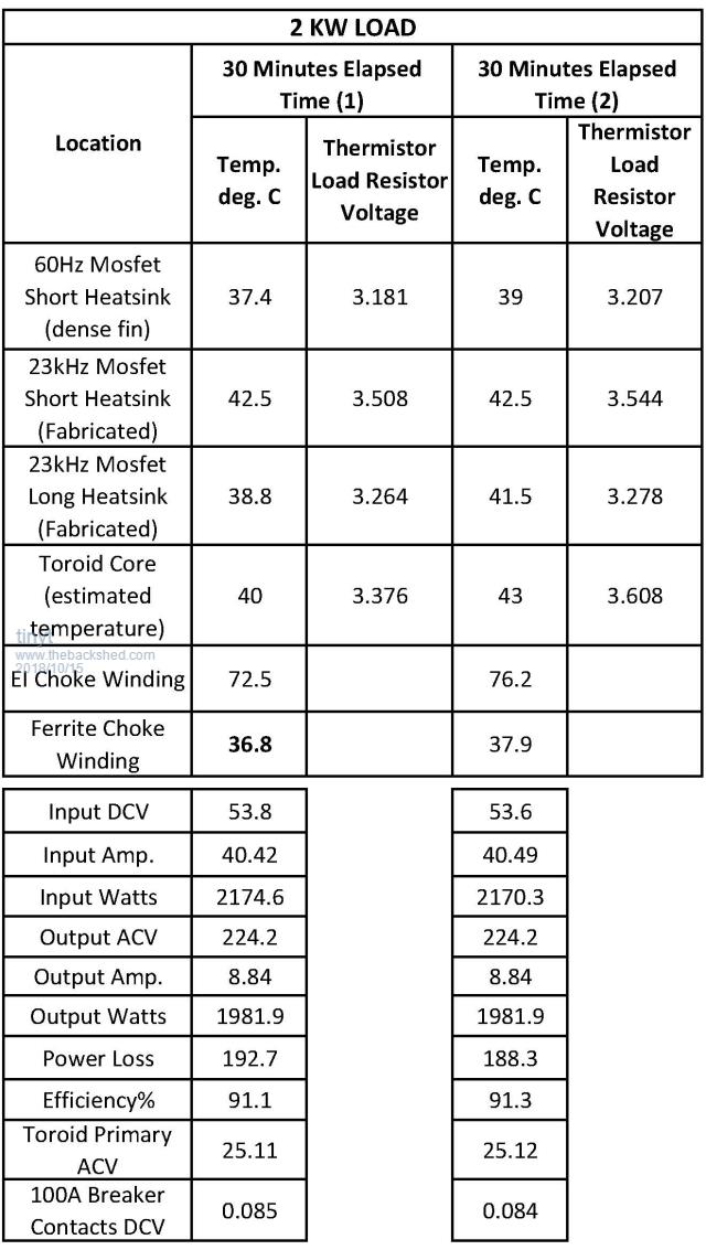

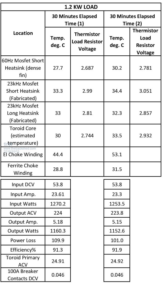

Here are some numbers for the 1.2kw load.
Then I changed the load to 2kw.

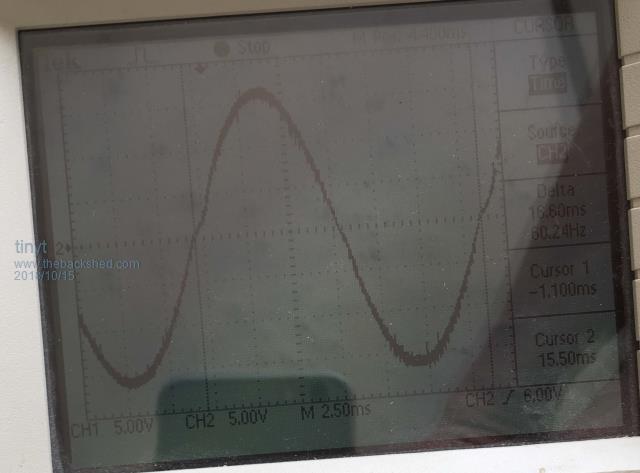

Here is waveshape with 2 kw stove heating element. (scope trigger is stopped in this pic.)
Here are some numbers for 2 kw load.
Then I changed the load to 3.2kw (1.2kw in parallel with 2kw).
Here is waveshape with 3.2 kw stove heating elements. (scope trigger is running in this pic.)
After about 30 seconds, the 100A breaker tripped. prior to tripping I read the voltage drop across the breaker contacts to be 0.116vdc. It should not trip at 65.4A, maybe defective. So I replaced the breaker with a higher rating.
Here are some numbers for 3.2 kw load.
I was able to soak for only 15 minutes since the EI choke winding temperature became too high. Note that there is no force air cooling in this test.

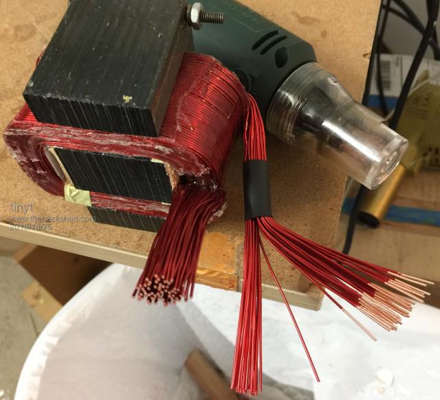

Still trying to improve the only EI choke I have. Based on my readings about skin effect on copper wires, AWG #19 will have an AC resistance equal to its DC resistance at 21kHz for 100% skin depth. The radius of awg #19 is .0359/2 = .01795 inch. I assume this will be the 100% skin depth value and I will assume it to be the same for 23kHz.
Doing some rough calculations on the wires I earlier used, the AWG #14 (.0641 inch dia.) will have only 80% of its cross-section effective for 23kHz current flow and the AWG #12 (.0808 inch dia.) will have only 69% of its cross-section effective for 23kHz current flow.
So at 23kHz the effective copper wire cross sections will be:
AWG 12, 6 strands, 19.5 turns. Effective copper wire cross section = (19.8 mm sq.) x .8 = 15.84 mm sq.
AWG 14, 15 strands, 7.5 turns. Effective copper wire cross section = (31.2 mm sq.) x .69 = 21.53 mm sq.
Now I used AWG #19 and was able to squeeze in the winding window 65 strands, 8 turns. Effective copper wire cross section = (.0658 inch sq. or 42.45 mm sq.) x 1 = 42.45 mm sq. - Much larger than the earlier two.
Picture is still a work in progress, will test when completed and find out.

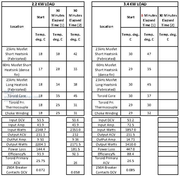

Posted: 12:07am 04 Nov 2018
This is a long post.
So I started temperature soak testing with the new EI choke. Using a single thermocouple to measure at different locations is tedious, so I used the pre-installed NTC thermistors and wrote code for the nano to do it. The code reports readings every minute. The RS-232 packet is comma separated text for import to excel if desired.
Col 1 = Minute count
Col 2 = Temperature for 23kHz Mosfet Short Heatsink (Fabricated)
Col 3 = Temperature for 60Hz Mosfet Short Heatsink (purchased dense fin)
Col 4 = Temperature for 23kHz Mosfet Long Heatsink (Fabricated)
Col 5 = Temperature for Power Toroid
Col 6 = Temperature for EI Choke
Col 7 = Fan OFF/ON indicator 0 = OFF, 1 = ON
Col 8 = Raw and noisy 10-bit ADC value for battery voltage (trimpot set to 4V when Battery is 54V)
Here is the packet for my 2.2kw load testing:

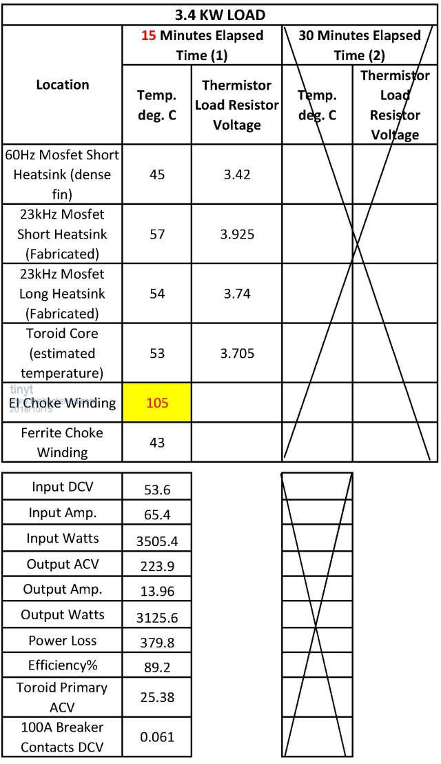

Here is a summary of my interrupted testing:
Note that for the 2.2kw load, the efficiency dropped by about 1.6% after 1 hour. Note also that the toroid core has the highest temperature reading after 1 hour.
Then I cooled the unit a little bit and changed to 3.4kw load. After about 11 minutes the CB tripped. When I reset the CB and re-started the inverter, the EGS002 LED now reports under-voltage. I cooled down the unit again and re-started while monitoring the CB contact DCV, it went up from .085v to .12v prior to tripping again after about 7 minutes. Here is the interrupted packet:

4, 44, 33, 42, 34, 31,0,814
5, 45, 34, 43, 35, 31,0,814
6, 47, 35, 45, 37, 32,0,806
When I was measuring the CB contact DCV, I also felt that one side of the CB felt warmer than the other sides, has be a thermal type breaker, so I thought it is the CB. I disconnected the toroid from the mosfet bridge and load and applied 230vac at its output winding, the current draw measured 0.11A. I let the toroid cool down so that its core temperature is the same as ambient and re-measured. The current draw went down to its original 0.055A as shown on page 10 of this thread.
On page 10 of this thread I showed that I did not remove the original 230V winding but located the center of the winding and split it equally into two separate 115v and used them. I also mentioned that this original winding is a split return type and in my picture it showed no insulation separating the two that are split. I should have completely removed this winding and wound a new one. I think the reason this toroid was removed from equipment and sold in ebay is it is drawing excessive current when it gets hot. At that time the seller had more than 6 of these so I think that batch has a design defect and what I bought was experiencing partial short at high temperature. Maybe the others that were being sold were completely shorted.
So after this hard and expensive lesson learned, I now will have to destroy my beautiful creation, salvage just the core and start anew. Edited by tinyt 2018-11-05
