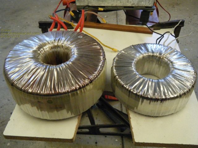

Thanks oztules,, I will be doing a similar test in a few days when I have wound on the new primary to another test toroid.
This one is from the "well known Australian manufacturer", a 2500VA version.
Just for a laugh I placed it next to an aerosharp toroid for comparison:
The one on the left is the aerosharp 3000VA.
20% difference in power, difference in size??
Then I weighed each (fully wound):
Aerosharp, 3000VA:21kg
right side, 2500VA:11kg
I think the "overrated" comment in an earlier message holds water.

Thats a truly massive difference.
To be fair, the aerosharo is designed for no cooling, and true continuous operation, it is a true 3kw unit.
The other one is more a transient device. I dont think it is expected to run full power for long periods like a grid tie would. Most people buying expensive inverters will probably use small battery banks with not enough solar.... so long runs are an anathema to them. A short run with high power start up consideration is probably more important for most folks out there.
That aerosharp will run 8kw for short periods, which is probably enough for most applications, and run 3kw continuous the rest of the time. I overdesign, so I can run 6kw continuous with twin or triple cores.

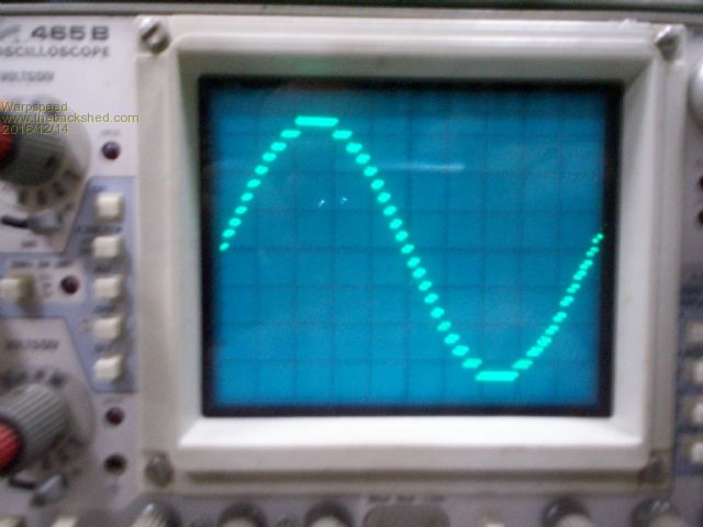

Main high power inverter at the top hard switches between +230v, short to ground, and -230v
Next lower power inverter does the same thing, but through a 3:1 step down transformer to generate (230/3) or 76.7 volt steps.
Next stage in the chain is again identical, but with a 9:1 step down transformer to add 25.6 volt steps between the 76.7 volt steps.
Last stage is very low power, with a 27:1 step down transformer to add 8.5 volt steps.
Final result will give 81 steps peak to peak.
The thread on the other Forum is 18 months old, and I have learned a great deal since then.
If there is any interest I can go much deeper into it with schematics, more pictures and EPROM data.

This generates all the waveforms for four inverters.
It scans a 2K x 8 EPROM fifty times per second.
Each 20mS cycle sequentially scans through 2048 addresses (one address each 10uS)
So we can turn things on or off by changing the EPROM data with 10uS resolution.
Each voltage step is fixed in amplitude, but we have great flexibility in determining when it switches, so we can construct a fairly accurate sine wave with constantly varying slope.
Address zero is the zero crossing point at the beginning of a positive half cycle.
A current limit input forces the EPROM address to zero effectively producing a zero output voltage. When current limit is removed a new cycle stats off from the zero crossing.
Because a ripple counter is used for address incrementing, and the EPROM address decoding is not perfect, there is a burst of noise during every address change.
The latch U9 ensures clean date output as it is clocked after the EPROM data is guaranteed stable.
Its pretty simple dumb logic, no software, but it works fine.
Current limit is very fast, it can shut down the fun in less than a microsecond.
The H bridge drive at the top of the circuit provides 30v peak to peak 50 Khz voltage that provides isolated dc power to the twelve isolated gate driver circuits via pulse transformers.
A similar board but with only three inverter drivers (not four) has been running for almost a year trouble free providing a 27 step peak to peak 240 volts.
