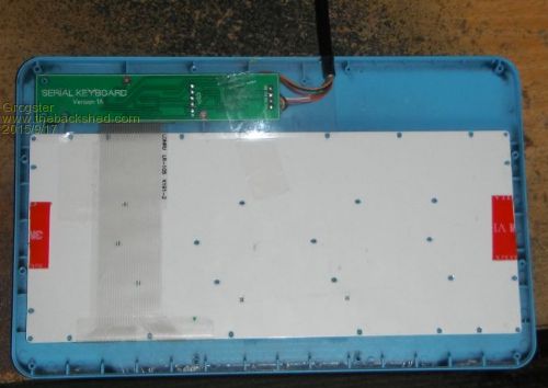

Holy smokes. That is some strong tape. Will be good for other purposes.:)
I opened up mine and i think i can glue some wood along the edges so that the bottom plate can be screwed onto that. At least it will have something to 'bite' into.
Some short countersunk m3 screws will probably work.
Actually glueing the keyboard to the aluminum is not that bad.
If you can mount everything on the aluminum and then just use the cover on top, the it does not need much to hold it down. Maybe with some magnets.
It will look 'interesting'. kind of industrial prototype electronics lab kind of thing.
Unfortunately i can not lasercut aluminum otherwise i would make the top of aluminum too.
Maybe cnc will work, but that will takes some time.
Edited by TZAdvantage 2015-09-11

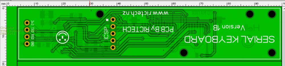

Posted: 04:56am 11 Sep 2015

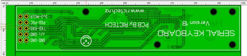

UPDATE.
The new 1B layout.
TOP:
CHANGES:
- Added a reset button, connected to MCLR. Pressing the "CONNECT" button now resets the PIC32 chip.
- Removed the grounding link, and replaced with a grounding track for the ICSP.
For the 1B board, I plan to use 8-core security wire for the link cable. Two cores for console TXD and RXD, one core each for MCLR, PGD, PGC, 3v3 and GND. The idea being that you can upgrade the firmware AND the MMBASIC code, all using the same cable.
...I am not sure how legal that is, with the ICSP side of things - adding a meter or so of cable to PGC and PGD might prevent the ICSP system from working correctly - I will run some tests with lengths of cable in front of the PicKit3 programmed and chip to see what happens.

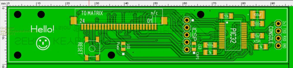

Posted: 01:12am 17 Sep 2015
UPDATE:

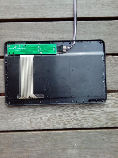

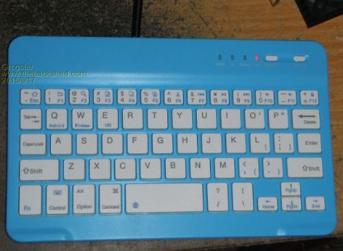

I have rebuilt the 2nd prototype of the little blue unit - this time, using the 2nd of two of the blue ones I had - all the others are black.
For this version, I wired up the ICSP to the connecting cable. I was unsure of just how legal that is with respect to the ICSP, but it seems to work just fine. The cable is quite short though - only about half a meter, as it is designed to complement an LCD unit that is right beside it, so no need to have a big long cable on it.
The cable I used was an old 9-pin serial cable with the plugs cut off - that gave me nine cores and a drain wire plus foil. This arrangement allows for BOTH updating of the MMBASIC code via the console and XMODEM commands, or complete reflashing of the firmware via the ICSP, all on the one cable, without having to pull the KB to bits.
You will note, however, that I have only used a tiny amount of VHB tape this time around, so that I don't actually have to destroy the KB to get it apart, if there is a next time.
This one does not have the new PCB with the reset button in it yet. I am going to see if I can move the ICSP to the end with the normal console output, so that all wires can be soldered in the one place.
However, this concept(ICSP over cable) is working OK.

As I remember, those old nine wire serial cables were pretty stiff which would make connecting the little keyboard up to micro modules a bit of a pain - the old serial cables are getting a bit scarce these days too.
A better option might be Multi-strand Ethernet cable (Cat 5, not 6) which is reasonably flexible and available everywhere. It's only got eight wires but the ground on the console connector and the ICSP connector are common so presumably only eight are needed.
Not sure how the twisted pairs in the Ethernet cable might affect things but it would be worth a try.
Greg
Posts: 10109
Posted: 04:18am 17 Sep 2015
Not the cable I have - it is only 5mm OD, and all the cores are stranded, so it is pretty flexible. Perhaps just the cable I have access to?
You could use anything within reason, I would think - even 8-core security wire, which was what I was going to use.
The cable I used was a Dynamix branded one, and my local shop had them on the shelf.
I don't think good old native 9-pin serial is quite dead yet.

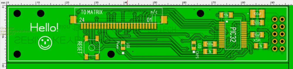

Here is the new PCB layout, with the console and ICSP all at one end of the PCB. Several other tracks were "Tided" in the layout, once the 5-way was gone.

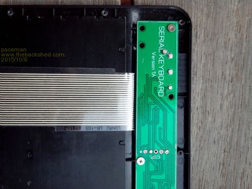

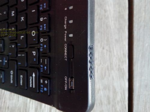

Hi Grogs,

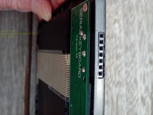

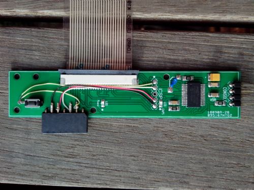

I've finally put mine together after waiting for the Chinese slowboat. Rather than run the ICSP lines out with the Rx/Tx/3.3v/Gnd cable I've modded the board (bit of a hack ) so that there is now a normal ICSP header available at the top edge of the keyboard. It fits pretty well and should be ideal for the occasional firmware re-flash.
I drilled the PCB and used a seven-pin right-angle header - see below. The two outer pins are not used but they and the middle pin (ICSP pin 3) are all soldered through to the opposite side Gnd fill to mount it tightly. Pins 1,2,4&5 were bent back out and connected with wirewrap cable to the ICSP connector. The Rx/Tx & power header now connects to nice flexible 4 conductor DuPont jumpers.
I also put one of the very small momentary contact tactile switches on the board for a RESET (switches MCLR to Gnd). It pretty much exactly fits the ON/OFF switch position.
Greg

That's a clever ICSP mod, Greg, well done.
