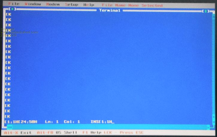

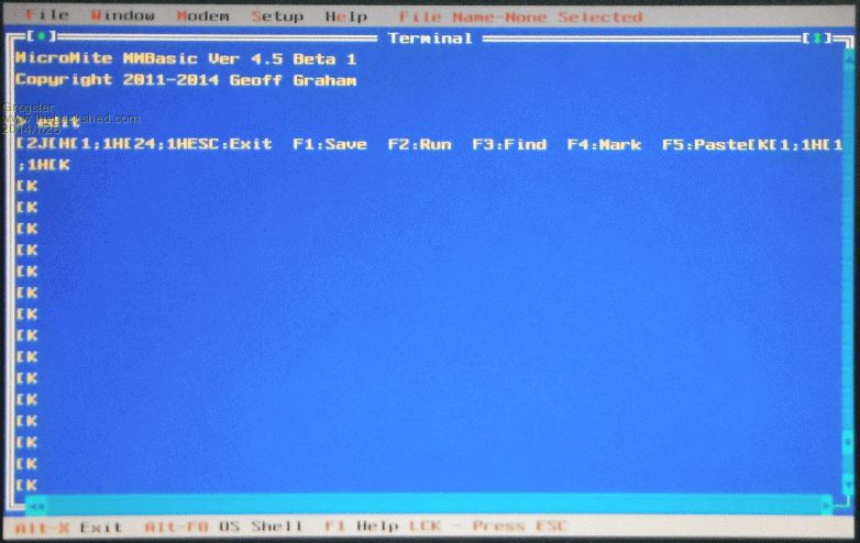

OK, finally got my MM talking to me - YAY!
I get the command prompt, but if I try to enter the editor, strange things happen.
This is still all at the 38k4 speed.
I seem to remember someone else here talking about the [ bracket thing being an issue too, so here are a couple of photos:
and I have to scroll down the terminal screen to get to the bottom, which looks like this:
I'm getting the welcome screen though, and if I type a command such as HELP, MM responds with an Unknown Command message, which I would expect.
I will keep playing....

That terminal use the Borland's Turbo Vision text user interface - the best ever.
Elvish name: Mablung Miriel
Beyound Arduino Lang
Posts: 10108
Posted: 05:24pm 25 Jan 2014
It's a terminal called TERMINAL PLUS by Scott Lightsey, written 2001.
Yes, perhaps the best terminal program I have ever used, and I have used lots, but this is my favourite. Can do daily log files too, which is really handy if you need to monitor something that only does odd things in the middle of the night, and only on certain days!
Posts: 10108
Posted: 05:39pm 25 Jan 2014
I just set the baudrate of the console to 9600 to test if it was something to do with TPLUS and or the laptop(it's older) being unable to keep up at 38k8 baud.
Not really that likely, but I tried it, and get EXACTLY the same result on the screen.
Perhaps TPLUS is not 100% VT100 compatible?
I will now try TerraTerm - Only used TPLUS, as it was the first laptop I came across at the time.
EDIT: Cranked up the throttle to 57k6, then 115k2 - same issue, so not a case of the laptop not being fast enough. Get the startup message and the > prompt just fine even at 115k2. Probably is TPLUS not being VT100 compatible - I don't know if it is or not, you see...
...more tinkering...Edited by Grogster 2014-01-27
Posted: 05:50pm 25 Jan 2014
What you are seeing are the VT100 escape codes which means that the terminal program is not capable or more likely, it needs configuring.
If the laptop is really old and you are using built in serial ports, there might be problems with a lack of FIFO buffers.
If you are running Windows 95 or newer, it is not really old.
Posts: 10108
Posted: 06:01pm 25 Jan 2014
It WAS TPLUS, and yes you are right Jim.
TPLUS was running on an old Win98 laptop, in DOS mode.
I have downloaded TeraTerm and installed it on this Win8 machine, connected to COM1, set baudrate etc, and it away now happy as Larry.
I took the RPM's back to 38k400 for this test, now I will ramp up the RPM to 115k2...
