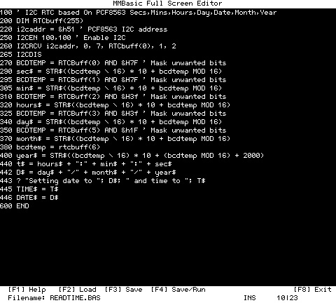

This is what i have been working on Full Screen Editor
so far is working good
then after this time to drop the line numbers

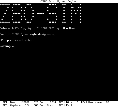

Also Built In VT100 Terminal
