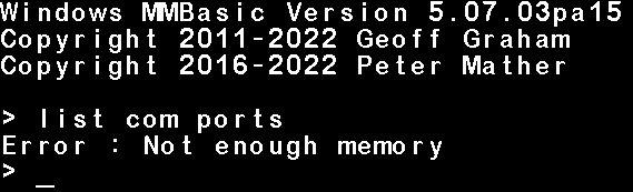

  Goksteroo said  I get this....
On my Dell Inspiron laptop running W11, I get the same.
Under Device Manager, there are no COM ports listed and this is because in this laptop, there are no COM ports, only USB. If I connect up a Picomite, or in fact, any USB to serial device/adaptor, the associated COM port is correctly identified.

  matherp said
  Quote  to know how many COM-ports are aviable and num of each COM port you can use
HKEY_LOCAL_MACHINE\SYSTEM\CurrentControlSet\Control\COM Name Arbiter
No: this shows all the comports that have ever been used not which are active. I get
&H64Fd3f200640 but only have three active ports
I said "aviable", not "active".
it means (my English is not good) that it displays all the COMports installed for the first time (used or not currently used), it was created so that the COM drivers know the first free COM number it can use.
After with key value, developer should test whether device is active or not by reading port status or sending 1 byte and wait for timeout, for error, or with your MMBasic function: "? Comports(xx)"
Also, this register key is use to cleanning all comport not active or desinstalled but always registred

I love all these COM ports. It appears I have 7571644 of them and Not enough memory. :)
System is Windows 10 Pro 64
Build:21H2
Intel(R) Celeron(R) CPU N3450 @ 1.10GHz   1.10 GHz
4GB RAM
