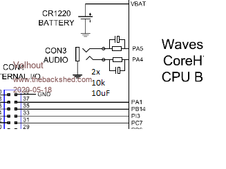

Posts: 6258
Posted: 06:49am 18 May 2020
  matherp said
  Quote  If I plug a headset in I load the H7 pins with 32 ohms. Depending the output voltage there can be 100mA DC current running in each pin (audio L and audio R).
From the manual page 9. We can add "headphones" to the warning
  Quote  This is a 3.5mm stereo phono socket.  The tip is the right channel, the ring is the left channel while the sleeve is ground.  The signal level at full volume is about 1.9V RMS (approx 3V peak to peak).  The output is high impedance suitable for feeding into an amplifier.  It cannot directly drive a loudspeaker and might be damaged if that was attempted
Hi matherp,
You may be able to solve this (prevent high currents with headset plugged in, and drive PWM to digital inputs) bij adding few components.
See below. The max DC current is limitted. But the AC output impedance is low.
The electrolitics can be ceramics also. 10uF in 0805 is very common.
I am not sure if you need a low pass filter. Haven't build a CMM2, so I am not sure what the frequency spectrum looks like.
