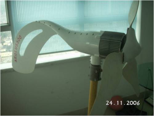

Hi all,
i watched all discusion on this thread and i have some question to you all.
First i want to try to build my F&P mill but because in Europe we don't have those motors i try with an LG motors equivalent i think on the 80 series.
for now i work on the mechanic system and in 3weeks i hope to be able to run some tests.
Also i have a small chinese mill model Aeolus3oo
but like other else chinese mills it's spinning hard to put something in my 12volts battery bank. It's a 3 phase mill at 12v rated 300w and maximum 500w ( in practice only in hard wind it's make approx 8 amps) and in body have a regulator that cut the output at 14,5~15v under load condition. I want to try these series cap but my probs are the mill is at 12 meter high and is very hard to rise and down the tower to make those tests. Is it possible to get down on slipring with alternative and to renounce at ground wire (slipring has only 3 outputs)and put caps on the tower base or better at 40 meters distance in my garage where are the batteries? My wires are 16mm2 copper.
Also what setup to chose it's another question for you, maybe some schematics with paralell like Bolty will help me.

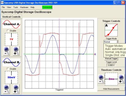

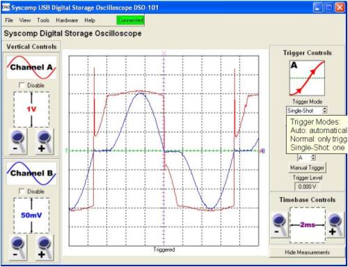

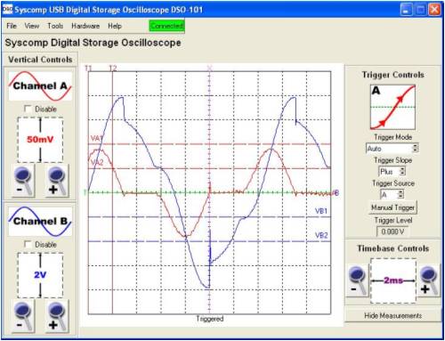

Posted: 10:10am 30 Dec 2008
Hi kiwijohn,

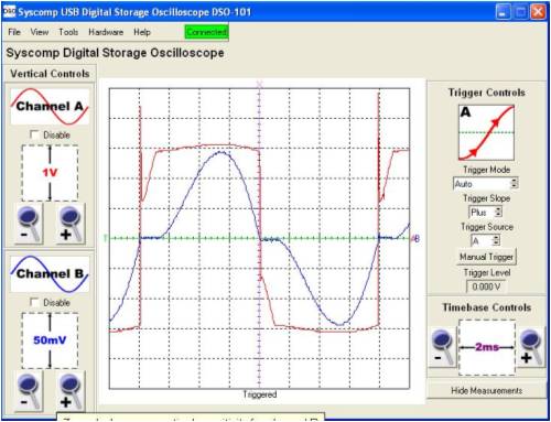

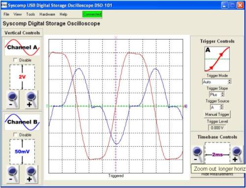

I have 4 pics, that tell some interesting stories. The rpm was not constant, and the capacitors reduce the loading, and the rpm increases. This is what happens on the windmill as well, and is why I started to investigate with a doubler, to regain this power.
pic 1.
current and voltage with no caps across bridge rectifier, single independent winding output to 24V nom battery load. This was 0.87ADC to battery. current was indicated by the voltage developed across an 0.8ohm series resistor, for a 6ohm winding resistance. The voltage was the AC to the input of the bridge rectifier.
pic 2.
current and voltage as above with 50uF series caps with the winding. 0.81ADC to battery. The voltage was the AC to the input of the bridge rectifier.
pic 3.
current and voltage as above, with 25uF series caps with the windings. 0.72ADC to the battery. The voltage was the AC to the input of the bridge rectifier.

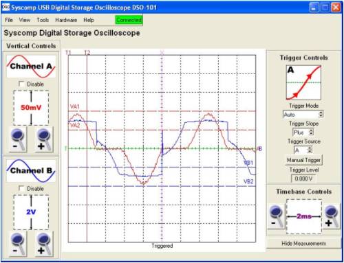

pic 4.
current as above, with 25uF series caps, but voltage measured on the coil side of the caps.
This last pic, shows the current to the battery is not in phase with the emf from the coil, when capacitors are added. The coil produces a more sinisoidal output voltage, unlike the clamped type output when directly connected to the battery. There is approx 160Vpk-pk compared to the 60Vpk-pk without the caps. I am sure someone will have some explanations.

Hi Gordon
Scope Images interesting .
Unfortunitly no conclusions can be drawn as the measurements are only showing the characteristics of the load accepting current from the available voltage.
Maybe if you added a refeance winding to sense the induced emf rather than the supplied emf .
Caps as expexted show a lead in the last trace . I can not from this info confirm or as i suspect kill the idea of leakage reactance.
The generator is merely doing what any generater does supplying the load placed on it.
My theroy tells me that the caps supply added excitation to compensate for the effective bucking of the mmf of the rotor as the load current increases.Not entirely unrelated to how a induction motor can be self excited.
The rotor moves back and forward as load pf changes get a strobe old car timming light .
Bryan IMHO no testing can be conclusive on live testing you are merely changing the characteristics of the generator to suit the driving force it works but is a stab in the dark. I admit I have used caps for years to tune hydros but once i find the operating point I adjust the windings to suit rather than leave the caps in, in the mill yes we have varying speeds and caps will have benifit left in. Only testing on a bench will be able to determine and understand the ultimite setup.
Herb
ps just looking again at last trace see 6 divisions one cycle 360 Deg therefore approx phase shift 1.5 div gives 90 deg there fore as we also have resistive load there cannot be much inductance effect from the windings. Edited by herbnz 2009-01-01
Posted: 10:57pm 30 Dec 2008
Hi herb,
Therer must be something with terminology you are using. I see the last trace as showing that the current is achieving a maximum after the voltage has already achieved a maximum. The current into the loading after the capacitor is lagging the voltage that is driving into the other end of the capacitor.
In laymans terms,
I see the voltage as similar to the motion of a swing being pushed. As the swing is pushed harder, the motion increases in amplitude. the capacitors are like a bungy cord attached to the swing. a load is attached to the other end of the bungy, like the rectifier and battery to the capacitor. The swing pulls on the bungy and exerts a varying force on the load depending on the amplitude of the swing. The position of the load attached to the bungy is changing depending on the stored energy in the bungy and the position of the swing in the cycle. The maximum amplitude of the load occurs at a time after the swing has attained a maximum and all the stored energy in the bungy has been utilised. The swing transfers energy to the bungy and then the bungy transfers this energy to the load. The capacitors perform a similar function. This is how I interpret the pic 4 traces.
As the frequency increases, the capacitor reduces impedance, so the load more directly affects the driving force.
BTW, I feel the emf of a sense winding on the same poles will closely follow the loaded emf, possibly without the rounded top of the waveform. I can only measure 2 channels without isolation. To accurately show the winding emf and current in relation to the load voltage and current will require 4 channels with electrically isolated inputs, which I don't have.
The current sensing resistance contributes a small proportion of the loading. This would be 0.8 ohms. The other resistance quoted was that of the winding at approx 6ohms. even so the total 6.8 ohms would present only about 5V of the 28V to the battery. There is another 25 or so ohms that is not pure resistive.
Gordon.

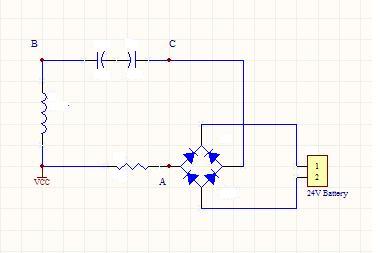

Posted: 03:10am 31 Dec 2008
Pic4.... is the current measured after the caps and before the diodes.
Is the voltage measured after the coils and before the capacitor and diodes?
.........oztules

  oztules said   Pic4.... is the current measured after the caps and before the diodes.
.........oztules
Hi Yea something is wrong current should lead voltage in a this arrangement I suspect one trace invertered
Herb

Posted: 10:00am 31 Dec 2008
Hi herb,
Yes, one trace was effectively inverted.
I rewired the measuring to this arrangement.
The DSO gnd was connectred to the Gnd point and then the current was measured across point A. The voltage was measured across B and then C, before and after caps. I was unable to reproduce the smooth voltage sinewave as before.
I hope this is a little clearer.
