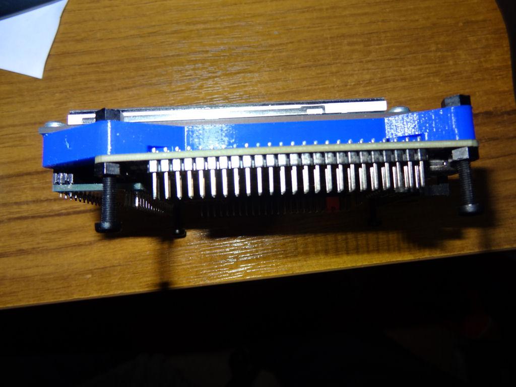

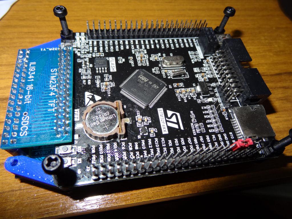

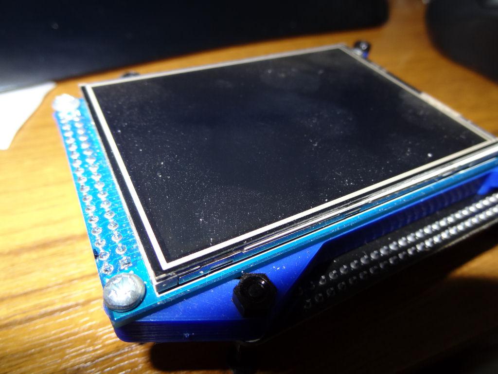

I've got some PCBs I designed that adapt/mount the STM board to the 34-pin display.  I've got about 8 of the PCBs left and I can 3D-print some of the joiner plates (blue in the photos) if anyone wants one of those too.  I've also got three spare ILI9341 16-bit 240x320 3.2-inch displays (with touch interface) to suit, so I could supply three kits of PCB/joiner plate/display.  I suppose I could throw in the PCB female headers too.
You solder the PCB direct to the STM board pins.  The PCB has female headers soldered to it - and the display then plugs into those headers and can be easily removed.  The spacer plate (3D printed part) is the correct depth to suit the plugged-together assembly, so the whole thing becomes a compact, rigid stable block - no floppy display that will move or crack when the touch panel is being used.
The display fixes to the joiner plate with some small self-tappers, and then you can put bolts though the mounting holes either to provide 'legs and feet' as I've done, or to panel mount the whole thing.  I used plastic bolts and nuts - I think they're M2.5 size.
These displays have a full-size SD card slot on their back side so I've routed the SD-card select pin to the header pin hole labelled SDCS in case anyone wants to use it.  I've not bothered - I use the micro SD card slot on the STM board itself.
Let me know if you're interested. PCB £1 each, 3D-printed mount/joiner £2 each, displays £15 each.  Plus shipping which will depend where you are in the world - I'm in the UK.
