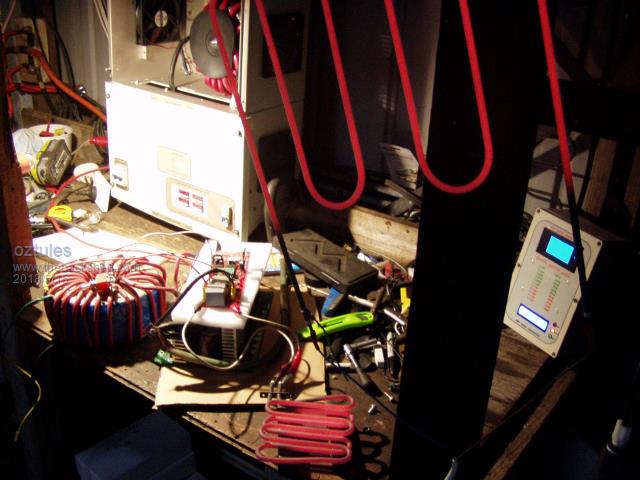

Ok, got home at 4.30, and decided to run the boards from last night.
Dusted off the old single tranny, and we got this:
Unit sounded happy too.
close up just because I like it....

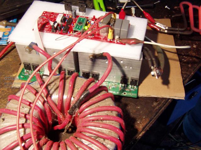

Now we put some more load on.... stop and start under load... no problems either..
This is just a pic to show the setup.

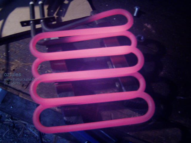

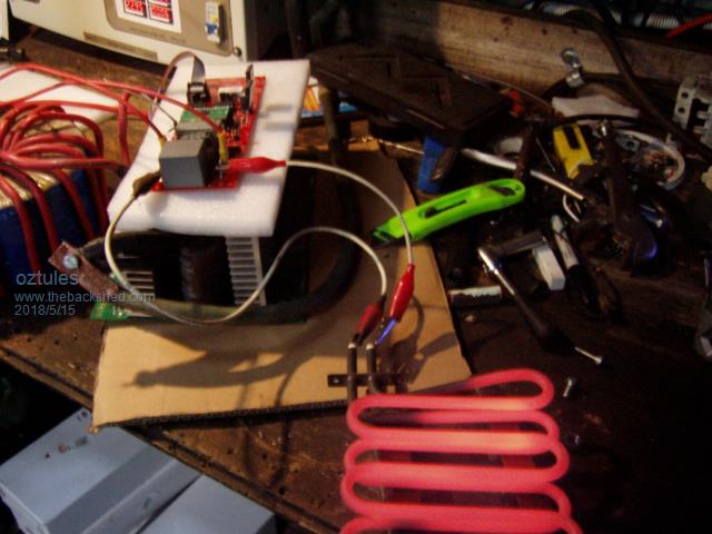

Here we are with 4-5kw.... still no problems, in fact inverter near silent now.
Both elements running
So it is a nice unit, and have no drama's. It stops and starts under 5kw of load, just seems very stable.

Yes, this was driving a clockman power board, with NO inductor.
So there were no totems to save the day, and it still worked flawlessly. The tranny was under done, the inductor was not present, it still worked perfectly well, with no noises, and very small heating. Even 5kw did not cause the heat sinks any bother after 10 mins or so.
So, If folks are having troubles, don't blame the inductor, or the totems or lack thereof... youve screwed something up.... maybe the 8010 soldering etc... folded pins on the drivers, or something else that is silly.... but kills the fun.

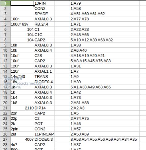

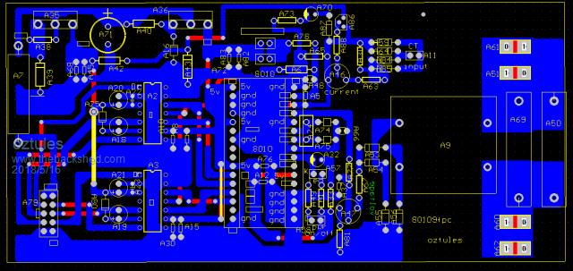

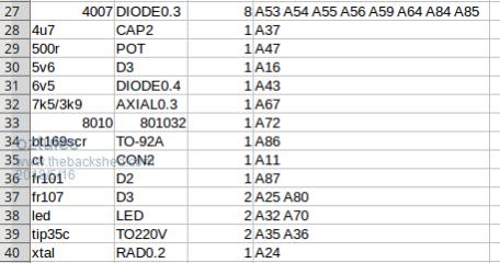

Ok mulver, as you know I'm not big on documentation... but I have cleaned up the pcb, so that it has output a BOM and made the screen shot show only the designation numbers.
This should give a succinct overview of both mads and my boards, except for the nano addition.
Clockmans board is basically the same, so it is fairly generic.
So here it is with designates only
Here is the generated bill of materials.. top half
and bottom half. There are only 40 components on the control card.... very low count for such a powerful device.
