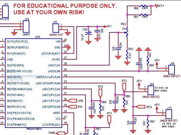

Ok, power switch not on your PCB, did not see that on first picture. Anyway, can I suggest you monitor the capacitor voltage instead of the 5v rail for your switch on signal? Reason, the 5V rail is established long before the caps are fully charged - at least on my set up.

  Tinker said   Ha tinyt, Mr Murphy has signed the exclusive club membership form for you already, he's just waiting to hand it over at the appropriate time .
Soon
  Tinker said   ... Anyway, can I suggest you monitor the capacitor voltage instead of the 5v rail for your switch on signal? Reason, the 5V rail is established long before the caps are fully charged - at least on my set up.
I have made provision for it, but don't know when it can be implemented.
The soft starting current pushbutton I used is rated at 10A. I have plenty of 2 ohms 25W resistors, so I used 4 for a series resistance of 8 ohms. So the initial in-rush is 54/8 = 6.75A for a completely discharged capacitor. With 60000 uF bulk capacitors, the RC time constant is 0.48 second and they will be charged fully in 0.76 second. So if I wait about one second before turning on the breaker, I think I should be good.

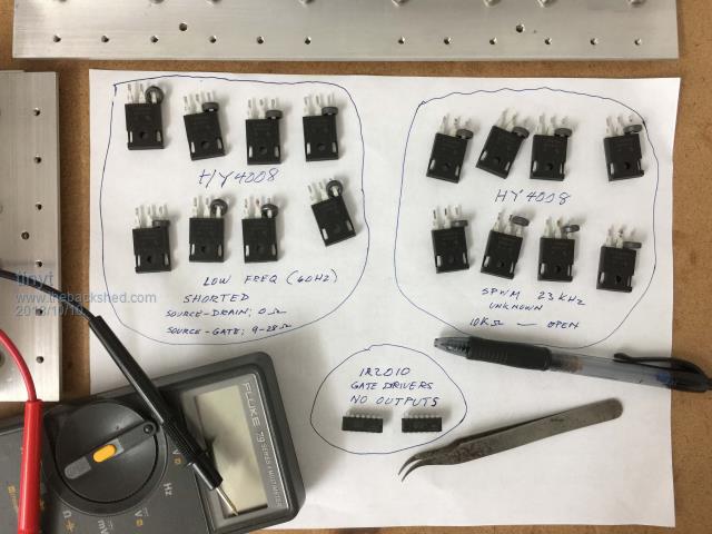

Post Mortem:
Burnt trace.
Damaged components.
Will be replacing the drivers and all mosfets. Then maybe more troubleshooting.
This is due to my carelessness. The mosfets died silently, no spectacular fireworks. So, I think I still don't qualify to join the club. Edited by tinyt 2018-10-11

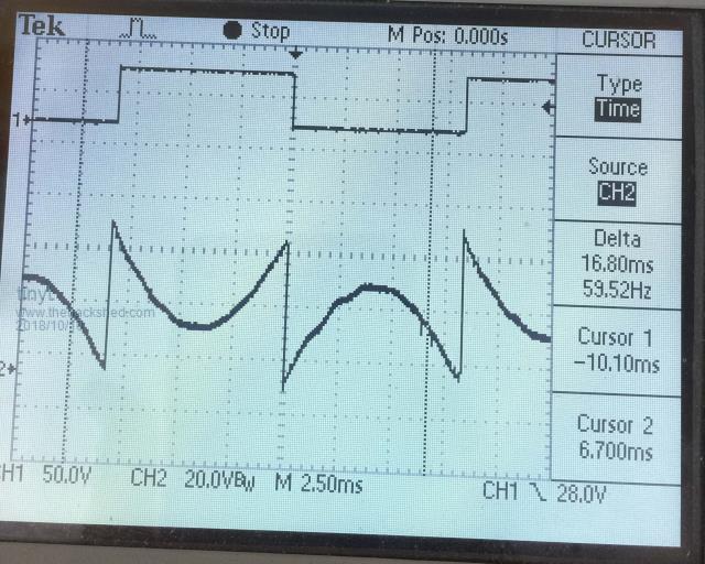

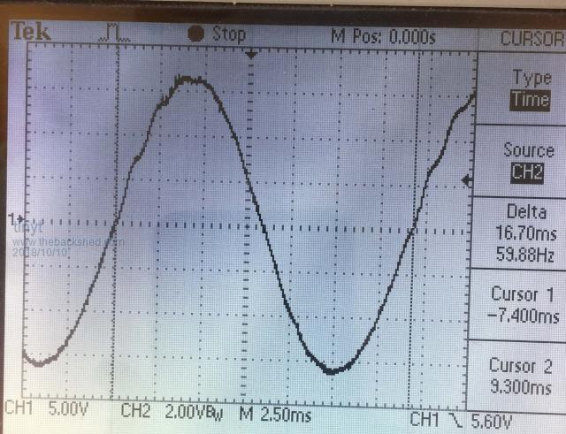

I installed new driver chips and new mosfets. This time only one mosfet per bridge leg (total of 4). Powered it up un-loaded and here is the waveform across the 12vac winding. It looks much better.
Here is the waveform across the toroid primary.
Looks like the ugly waveform distortion went away.Edited by tinyt 2018-10-11
Posted: 05:50am 10 Oct 2018
Yes that is much better, before it would have sounded pretty horrible in the Toroid also.

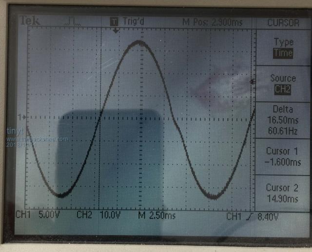

Here is the latest waveform with 1.2kw load. Not perfect but good enough for me.
And the numbers:
No load power input (54Vdc x 0.31A) = 16.74 watts
1.2kw stove heating element load power input (54Vdc x 24.78A) = 1338 watts
1.2kw stove heating element load power output (231Vac x 5.34A) = 1233.5 watts
Power Loss (1338 - 1233.5) = 104.5 watts
Efficiency (1233.5/1338) = 0.92 or 92%
On to more testing.Edited by tinyt 2018-10-12

The grid waveform can look pretty horrible, and everything runs just fine off that.
Both the no load input power and efficiency are excellent, something to be very proud of. Not too many high dollar commercial inverters could come anywhere near that.

Posted: 11:58pm 10 Oct 2018
With 92% efficiency you are very close to what others have achieved. The waveform looks near enough to perfect, I would be keeping a close eye on your MOSFET temperatures with the heat sinks you are trailing.

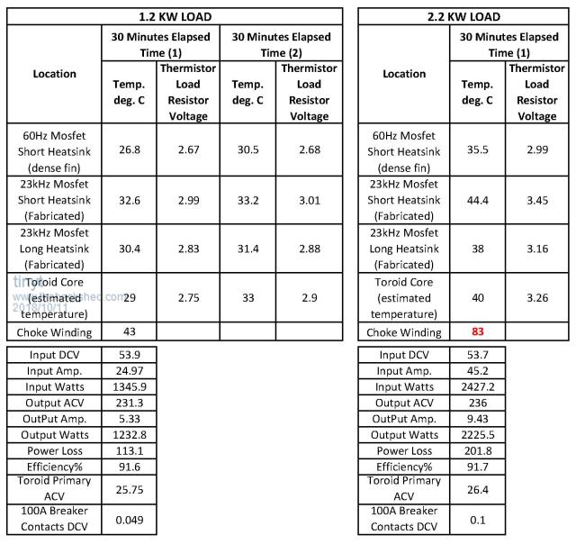

Some Load testing data: temperature readings, etc. I was able to do up to 1 hour with the 1.2kw load. But for 2.2 kw, I stopped after 30 minutes as the choke winding temperature rose too high for me. I was afraid that its winding epoxy will soften.
I used a thermocouple probe that came with the clamp meter I was using.
I don't know why at 2.2kw, the output voltage rose to 236 vac from 231 vac at 1.2kw.
At 1.2kw load, the choke hums. At 2.2kw load, the choke growls and heats up.
I have to make a new choke with bigger wire cross-section. Maybe efficiency will slightly improve.
I have two 2.2kw stove heating elements so with a better choke, I should be able test with higher loads of 3.4kw and maybe 4.4kw.
